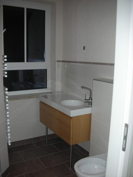

You could also route the water supply line next to the WC partition wall on the side of the Godmorgon cabinet. First, tile the wall, then install the drain and water supply fittings on the wall towards the center of the washbasin. Next, cut a small opening in one side panel of the Godmorgon to accommodate the wall-mounted pipes, and then slide the Godmorgon into place. The drawer will be shortened anyway because of the siphon and other plumbing.
Do you want to mount the Godmorgon cabinet solely on the wall, or will you use the front legs as well?
My Godmorgon cabinet next to the WC partition wall was installed just over 8 years ago. I don’t have a better photo—it’s always tricky to get good pictures in small spaces.
