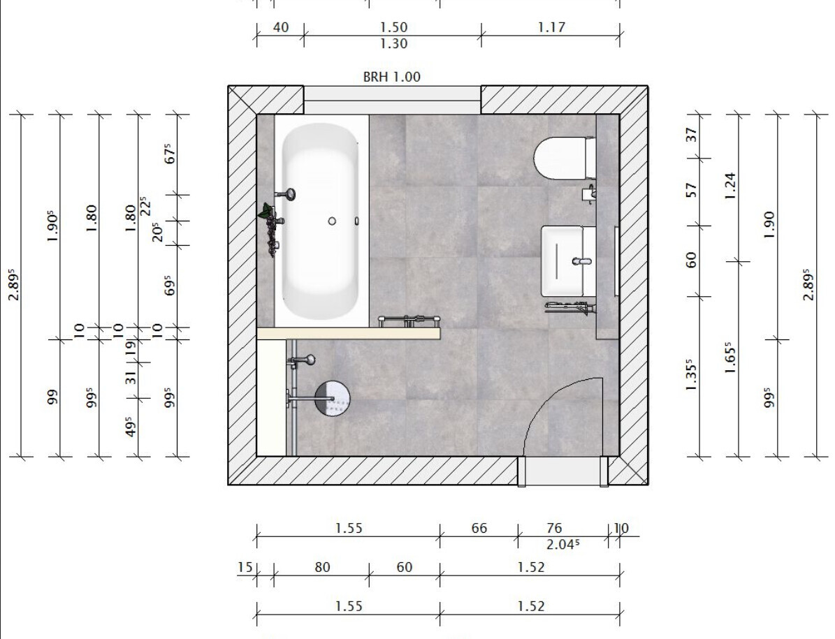

And how will this washbasin (about 49cm (19 inches) wide?) be covered? Maybe a picture of the washbasin?
The partition wall in the washbasin area doesn’t need to be that high (how high is it planned to be at the toilet?).
By the way, the drawing shows a partition wall depth of approximately 20cm (8 inches):
Do you really need that 10cm (4 inches) of space? I’m not a fan of corners and recessed areas because, in my experience, they always collect dirt. I can’t imagine it looks nice or is convenient when mopping the floor to have to clean the corner that forms between the toilet and the washbasin separately—which really only works well if you kneel down and do it by hand. Otherwise, that corner often remains uncleaned.
So, for the sake of whoever does the cleaning and to prevent dirt from settling in such niches, I would recommend a continuous 20cm (8 inches) flush wall.
By the way, we have extra slim cisterns, and our flush walls aren’t 20cm (8 inches) deep. I can measure them at home if you want, but I’d estimate they’re about 10–12cm (4–5 inches) deep. So that could be an option as well, right?
goalkeeper10 Jan 2020 09:21I also really don’t like this basic offset at all.
Either we go with a continuous 20cm (8 inches) wall cladding or the 10cm (4 inches) one. However, with the narrow version, as is probably the case for you, a different wall installation system is needed, including an actuator button mounted at the top. This setup costs over 600 € net in additional charges. I find that quite expensive.
goalkeeper schrieb:
