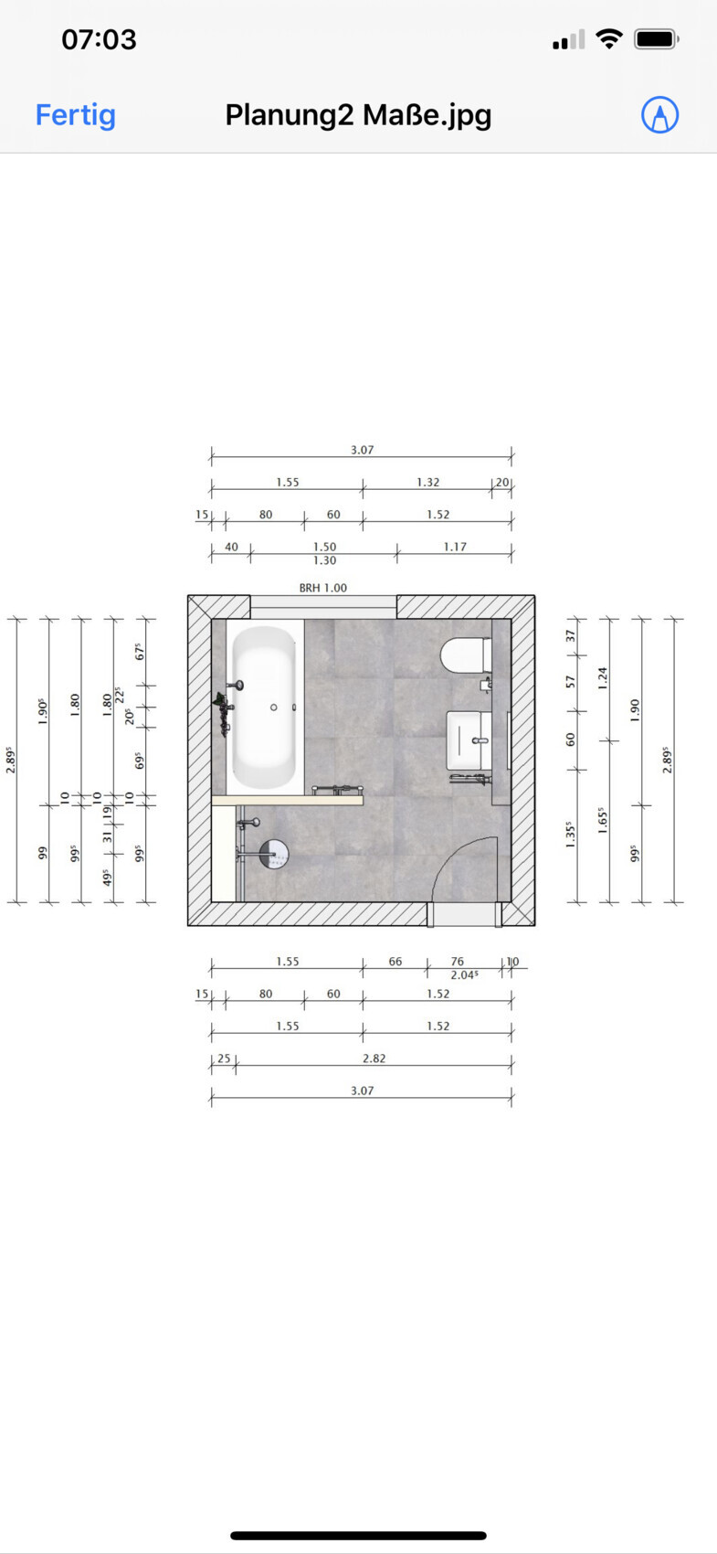

goalkeeper schrieb:
The plumber would make the drywall build-out for the hand basin about 10cm (4 inches) deep and the one for the toilet 20cm (8 inches) deep. For the basin, this gives us more space between the washbasin and the opposite wall of the walk-in shower.I would probably consider the idea of recessing the basin into the drywall build-out.https://www.instagram.com/11antgmxde/
goalkeeper9 Jan 2020 23:5011ant schrieb:
I would probably consider recessing the sink into the wall frame.He will probably not want to do that because of soundproofing.
Which type of soundproofing are we misunderstanding each other about? I mean integrating the sink as a "built-in basin" into the top surface of the pre-wall installation.
goalkeeper10 Jan 2020 00:14I thought you wanted to completely omit the wall build-out.
We want a vanity cabinet – that cannot be done with your idea.
Why not? The vanity cabinet just shouldn’t be too deep. The idea is to build the vanity’s false wall only high enough so that the countertop slightly overlaps it.
The false wall section around the toilet will then be a bit higher and deeper. You won’t see the one around the sink.
Otherwise, if you share a floor plan sketch of the bathroom, it might be easier to explain.
