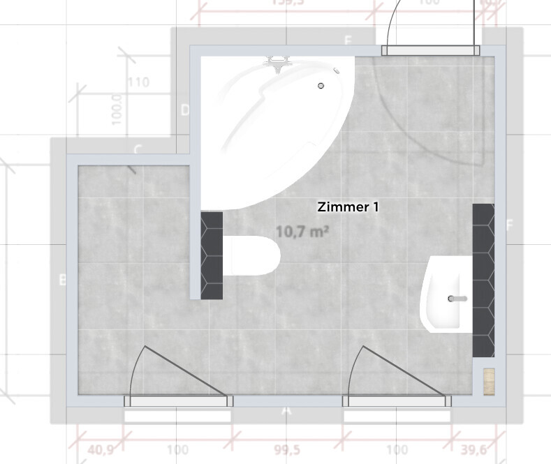

Revised it again... has the advantage that you don’t look directly into the toilet 🙂

Not sure if I like the door hitting the stud wall... but it’s a good alternative
6 Jan 2022 17:06
Steffen47a schrieb:
Not sure if I like the door hitting the stud wall .. but a good alternative
The door doesn’t hit the wall; it swings outward 😀 And it’s only 90cm (35 inches) wide... I already mentioned that!
It’s also nice this way if you like corner whirlpool tubs 😉
Floor plan of a bathroom (room 1) with bathtub, toilet, and washbasin.
minimini
6 Jan 2022 17:43
@ypg I think both options are good!
For the original poster, it would also be important to consider the neighboring situation in the direction of the windows. I once had neighbors where, despite a considerable distance and frosted glass, you could still see quite a bit that you wouldn’t want to see.

I have another inspiration
[ATTACH alt="bathroom design new build approx. 10m-548977-1.png"]68549[/ATTACH]
In this version, I could also imagine building a drywall partition wall at the end of the bathtub and then adding a small section on the right side, flush with the shower wall. This creates a great recessed shelf niche for all kinds of shower storage items, towels, and so on.
6 Jan 2022 20:01
Exactly. Or in the latter case, above the wall structure in front of the toilet, the niche for the shower shelf 🙂
