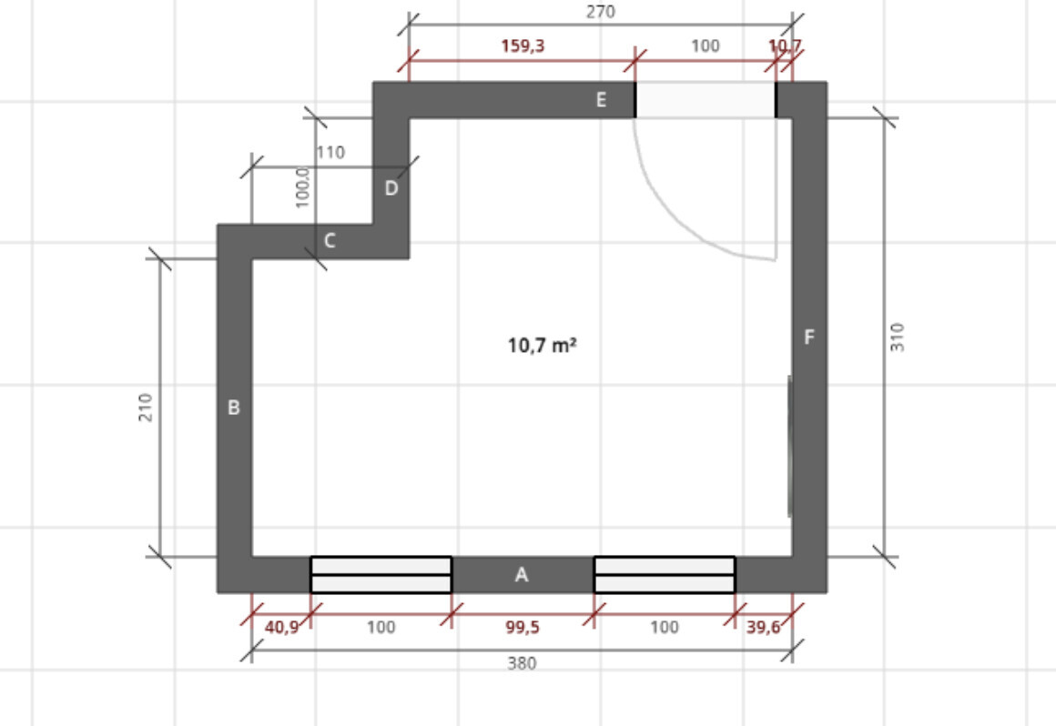

We are currently building a new house and are looking for ideas on how to fit everything into the bathroom.
Requirements:
Bathtub
Tiled shower with a built-up shower wall (approximately 110cm (43 inches) wide by 130cm (51 inches) long)
Built-in wall unit (about 140cm (55 inches) wide with washbasin)
Any ideas?
Floor plan of a room with irregular walls, labeled A–F, dimension lines, and 10.7 m² (115 sq ft).

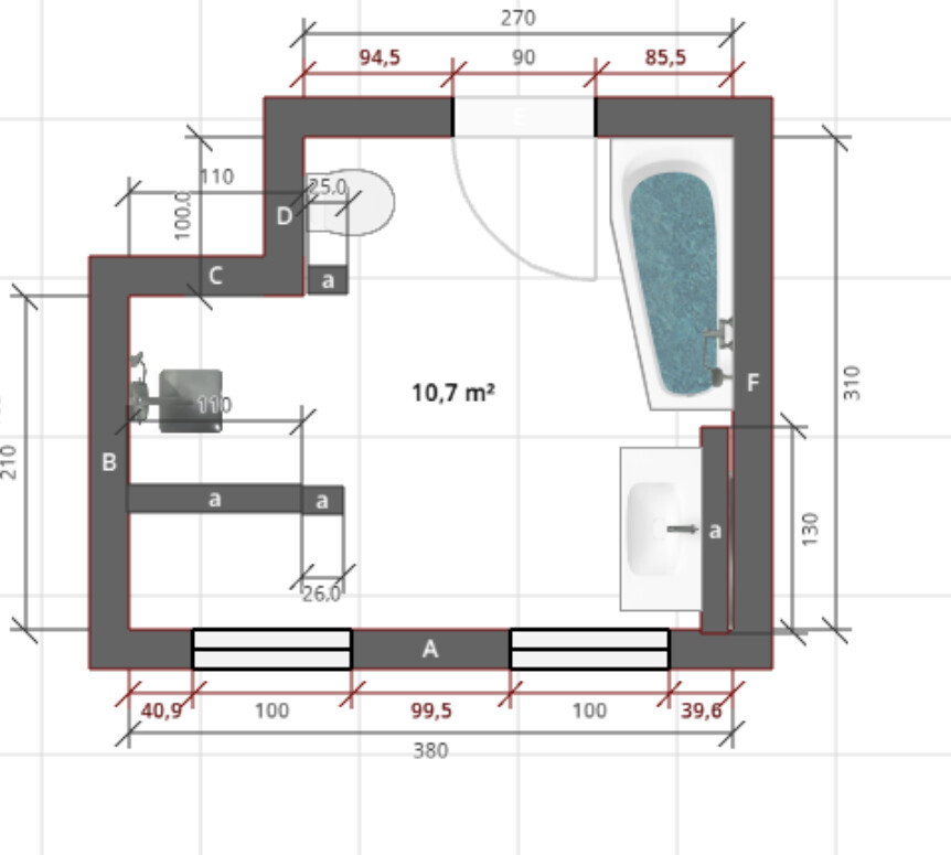

What do you think about this?
The corner under the shower would be used for a cabinet.
Is it possible to fit the toilet into the corner, considering the plumbing connections...
Grundriss eines Badezimmers mit Badewanne, Waschbecken und Maßen (10,7 m²)
6 Jan 2022 21:56
Is it possible to fit the toilet into the corner? In terms of plumbing connections...
Then please use your first plan instead – the wall in front of the window makes the whole house unsellable.
Myrna_Loy
6 Jan 2022 21:58
Is it possible to fit the toilet into that corner? From a connection standpoint...
Nothing. I also like in the first draft that you can have a view from the bathtub. I like the lines of the layout too – without strange bevels or angles.
