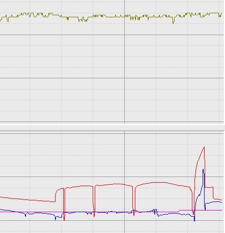

Welcome back to the land of problematic heat pumps and odd DTA files.
Nothing has changed; the flow rate remained at 1380 liters per hour (l/h) without the buffer tank, and the heat pump is still operating erratically.
Last chance to include the buffer tank with a flow rate of 3 x 60 liters per hour (l/h). Now I don’t care anymore. Fortunately, the outside temperatures are rising, so heating the buffer tank won’t be too expensive. This brings the total flow rate to 1560 liters per hour (l/h), which is the nominal capacity. If it still doesn’t run steadily, my only option left is the AI service.
@Daniel-Sp: What’s your guess on this? Could it really be that the heat pump has too low a flow rate (1380 liters per hour (l/h))?

[ATTACH alt="2D787E34-2A02-48EB-A5F6-80AE17FBDC20.jpeg"]56274[/ATTACH] But how can it be too low flow? We have read that I modulate with 800 l/h (0.35 gallons per minute), and someone else here with a similar value? Or do you not have a modulating heat pump?
According to the manufacturer, the minimum flow rate for the heat pump is 1200 liters per hour (l/h). Last time, I was well below that with 1041 l/h.
The nominal flow rate is 1600 l/h. With yesterday’s 1380 l/h, I was still quite far from that and hope this is the reason. I am now at 1580 l/h in the basement. I will monitor it for 48 hours.
