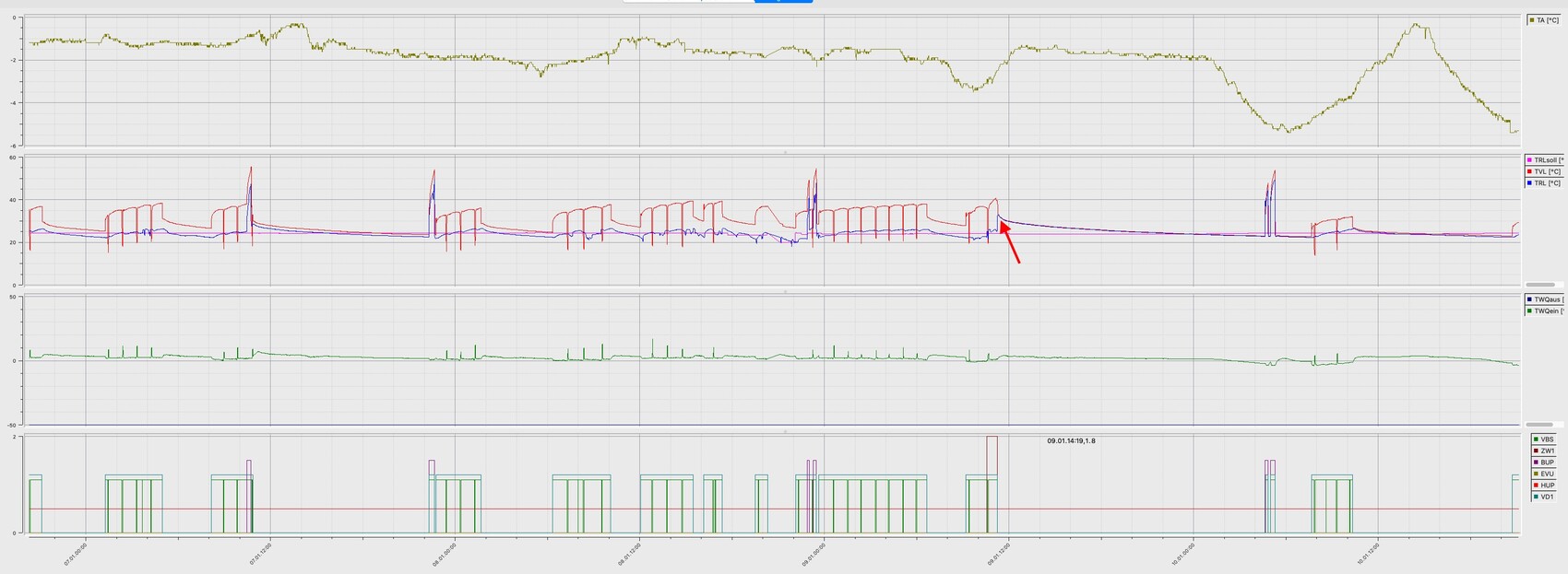

And what flow rate does the efficiency pump show you?
I just looked at about 10 different .dtas files from your heat pump model, and no one really has such a high temperature spread. Your supply temperature is sometimes almost 40°C (104°F)...

It can’t display that. Yes, I know, I have noticed that too.

How often does it start per day?
If it has been heating continuously for 7 hours, it can’t be that often.

The last heating cycle on the right is "normal"
- no divergence during standby
- the supply and return curves come back together completely after the heating operation ends.
Everything else to the left is unusual and unnecessarily prolongs the heating operation, shortens the intervals between cycles, and makes the operation "expensive."
Basically, the blue and red curves must fully match except during heating operation and hot water production.
- No spread during standby
- The return and supply curves fully align again from the end of the heating operation.
Everything else to the left is unusual, unnecessarily extending the heating operation, shortening the breaks in between, and making the operation "expensive."
Basically, the blue and red curves must fully match except during heating operation and domestic hot water.
At the marked point, was the heating element active? I can’t clearly tell from the graph.
In the AI/Novelan heat pumps, didn’t you suspect a defective return sensor?

At the marked point, was the heating element active? I can't clearly see it in the graph.
In the AI/Novelan heat pumps, didn't you suspect a faulty return flow sensor?
Yes, in the end the heating element activated there at over 40°C (104°F) supply temperature with a temperature spread of more than 15K.
Yes, it did, but somehow my requests for help there are being ignored.
