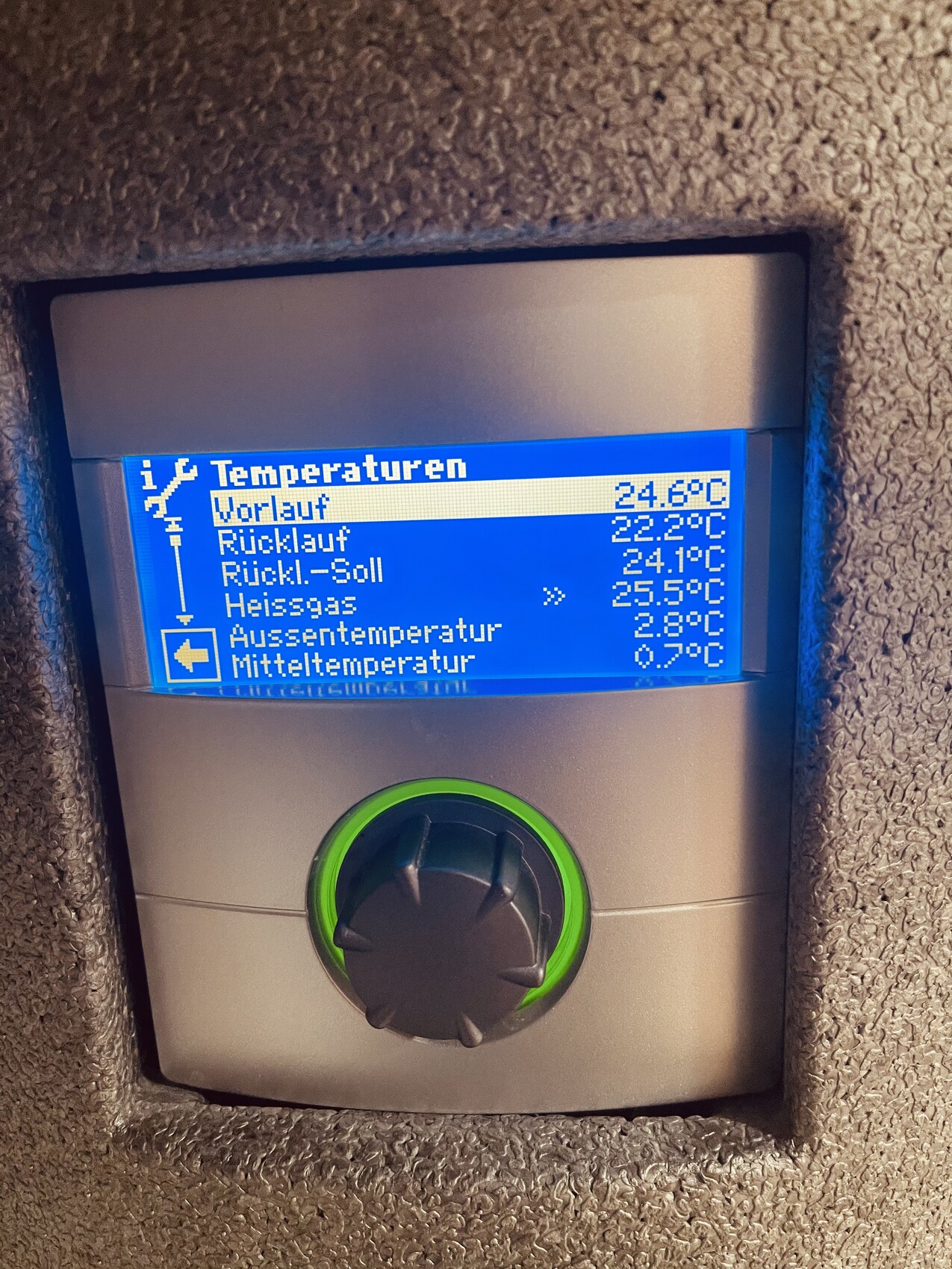

Well, I’d say if someone contradicts themselves from one post to the next and I ask why, then get a sharp reply, I’m going to push back as well.
And if someone talks about optimization but accepts high consumption as a result, I can’t really take that as optimization.
Basically, I always tried everything that was suggested and ran it for at least 48 hours.
Pipe insulation is ordered and will be delivered in the next few days. An IR thermometer is available and has been tested. I can rule out a hydraulic short circuit. No return flow is anywhere near as warm as the supply in the heating circuit valve.

At the heat pump, flow temperature 24.9°C (76.8°F), return temperature 23.0°C (73.4°F)
IR thermometer on the sleeve at the flow side 24.7°C (76.5°F), return side 24.6°C (76.3°F)

21 Jan 2021 18:22
Zaba12 schrieb:
At the heat pump, supply temperature 24.9, return temperature 23.0
IR thermometer on the sleeve at the supply line 24.7, return line 24.6
This variation within 25 minutes is unacceptable.
Return temperature dropped by 0.8 and supply temperature by 0.3. As a result, the temperature difference increased to 2.5 K in standby mode. 25 minutes ago it was still 1.9 K. How is this possible? It isn’t. As mentioned, we are talking about non-heating operation. There should be no temperature difference at all in this case.
Heating controller: blue display showing supply, return, and outside temperature readings, green button.
T_im_Norden
21 Jan 2021 18:47
Where is the measurement taken, at the heat pump?
Normally, the pump continues running for a certain period even when heating is not active, which alone causes a difference.
