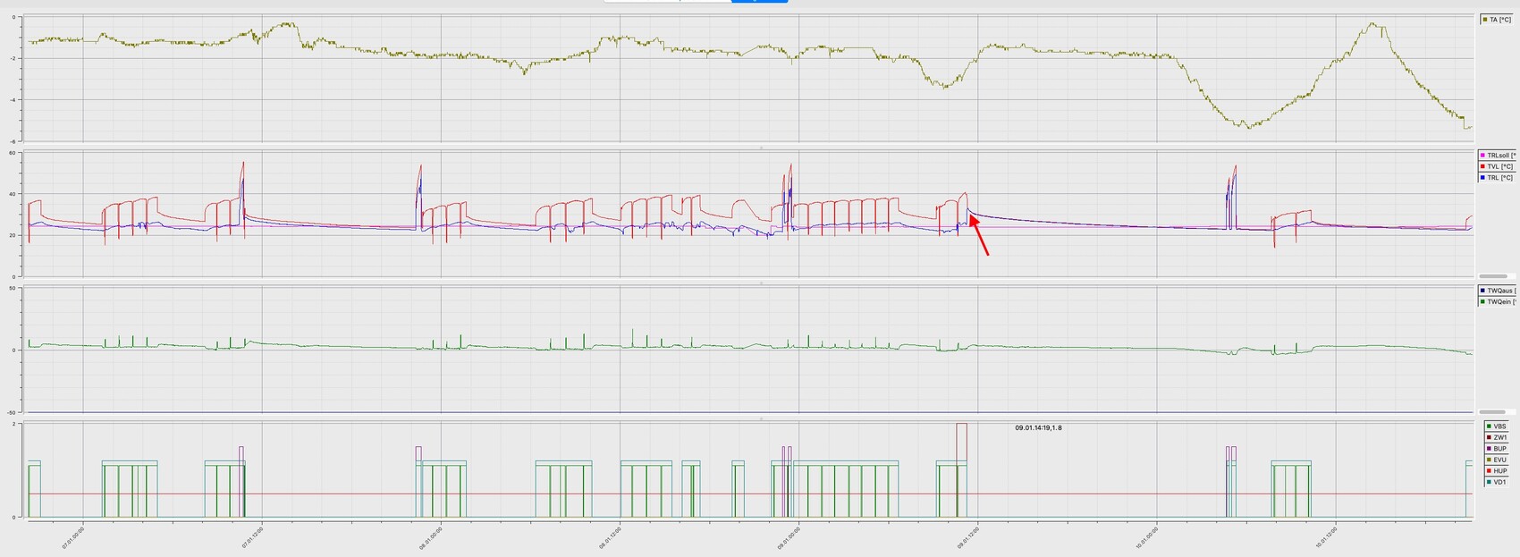

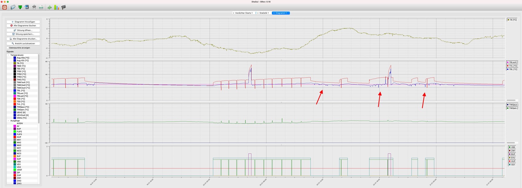

At an outside temperature of 9°C (48°F), my heating system shut off earlier; the cycle had started on December 24th.
21.01.21 10:22:08 no faults
24.12.20 04:04:10 no faults
Flow temperature 24.9°C (77°F)
Return temperature 25.8°C (78°F)
Return temperature setpoint 24.5°C (76°F)
Hot gas temperature 38.0°C (100°F)
Outside temperature 9.1°C (48°F)
Average temperature 2.1°C (36°F)
Z
Zaba12
21 Jan 2021 11:15
…and I called my heating technician today to have the return flow sensor replaced to rule out that the issue is caused by a faulty return flow sensor.
I sent him the screenshot. At first, he said it was due to the closed radiators that are then opened by the electronic radiator valves (ERVs). After I explained that all ERVs have been open since December 20th, he had no further explanation.
Vier Panel-Diagramme: Temperatur TA, weitere Messwerte; Pfeil kennzeichnet Spike.
Diagramm mit mehreren Signalen, Temperaturverlauf und roten Pfeilen markiert Spikes.
Z
Zaba12
21 Jan 2021 11:19
@halmi: Are there any other possible causes for the problematic return flow curve? Any ideas? The heating technician is skeptical that the issue is due to a faulty sensor.
