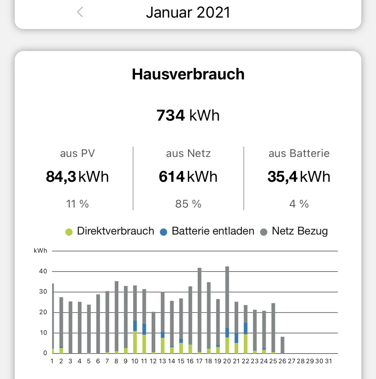

A brief update on my heat pump. I have to “calibrate” my return sensor every other day :p but then it runs well. I still hope my heating technician will replace the sensor soon because I check the temperature difference between the supply and return lines more often than I’d like, and I’m not really keen on that.
With a perfectly adjusted heat pump, the monthly consumption would probably already be accounted for, but as it is, there will be an additional 150 kWh on top.
Any house consumption noticeably above 25 kWh is due to the too high temperature difference of the heat pump. The most extreme case was on January 20th, when at 6°C (43°F) outside, the house consumption showed 43 kWh due to the faulty sensor.
Januar 2021: Hausverbrauch 734 kWh; PV 84,3 kWh, Netz 614 kWh, Batterie 35,4 kWh; Balkendiagramm.
