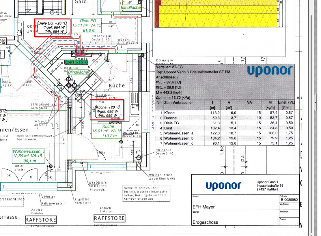

Hello again,
I have now dug deeper into my documents and even found something that can be interpreted as a room-by-room heating load calculation:

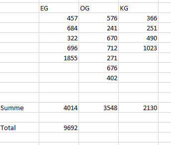

Am I correct in understanding that the 684 W in the hallway or the 696 W in the kitchen represent the heating load for each room? When I add everything up, I get:
So, a total of 9.7 kW altogether—is that realistic?

Looks reasonable. Since it is planned with a supply temperature of 37°C (99°F), it naturally requires more heating output. Also, 10/15cm (4/6 inches) insulation thickness is definitely not optimal but not a disaster either.
Do you have the flow rates as well? On the ground floor, it’s 443 l/h (1.95 gallons per minute). That will definitely reach heat pump levels of around 1200 l/h (5.29 gallons per minute) and up. The goal is actually a low temperature difference, which you’ve specified as 8.4°C (15°F)? That’s quite challenging for a heat pump.
You can recalculate this and also check if it’s designed for the correct natural gas flow rate. Especially if the insulation is going to be increased anyway. It doesn’t cost much at an engineering office.
I’m not involved with the subsidy programs anymore. Is this all urgent? Otherwise, you could try to increase the flow rate over the winter to minimize the temperature difference and then see how far you can lower the heating curve.

Regarding the heating load: It looks like the calculation was done correctly. I can’t say if the values are accurate, but they probably are. Why your consumption is lower than what matches the heating load cannot be determined remotely with the documents provided.
With additional insulation on the upper floor, the heating load will not exceed 9 kW. Even in the current state, a 9 kW heat pump would be sufficient.
