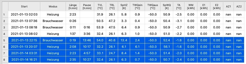

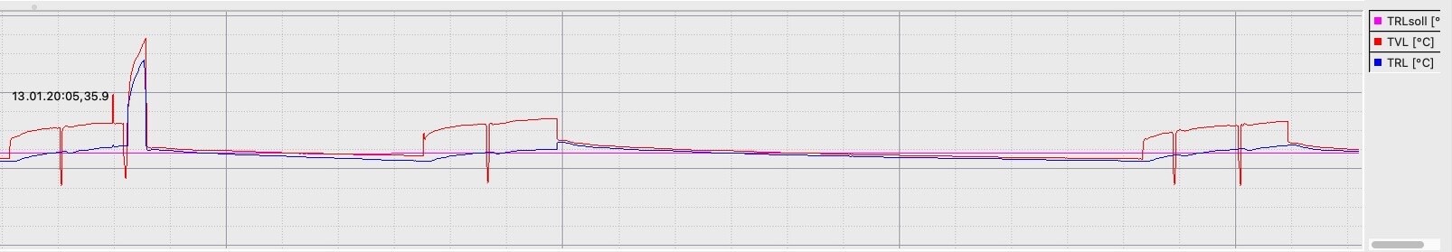

Yes, I’m doing that. I’ve just reset it now. The heat pump just started as well. Tomorrow at 8 PM I’ll record the heat output.
Or is the heat output shown in the data? Then I could even take the value from yesterday directly.
@Bookstar the 24 hours are up.
The heat output is 55.7 kWh. The heating cycle started 3 times and ran for a total of 7.1 hours (7:06).
With 2 kWh electricity consumption, that makes 14.2 kWh of electricity for the 24 hours.
1 hot water cycle ran for 19 minutes with roughly 2.7 kWh. That’s about 0.9 kWh.

Table with start time, mode, duration, and measuring values for heating and domestic hot water.

Time series with three lines: TRLsoll violet, TVL red, and TRL blue; temperature progression over time
