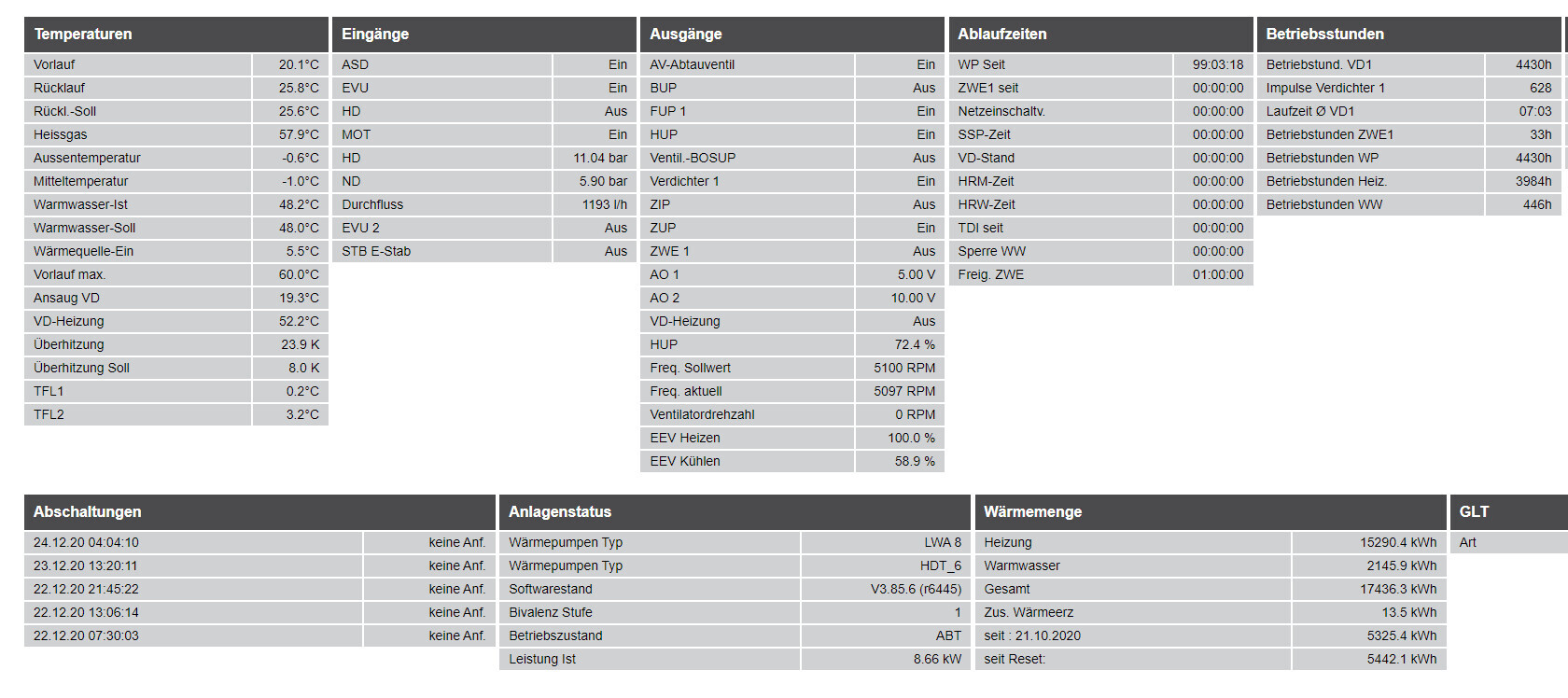

halmi
13 Jan 2021 22:29
Have you ever observed your flow rate during defrosting?
Ours usually modulates around 600 liters per hour (l/h). During defrosting, the flow rate increases to about 1100-1200 liters per hour (l/h). The system has been running continuously since December 24th.

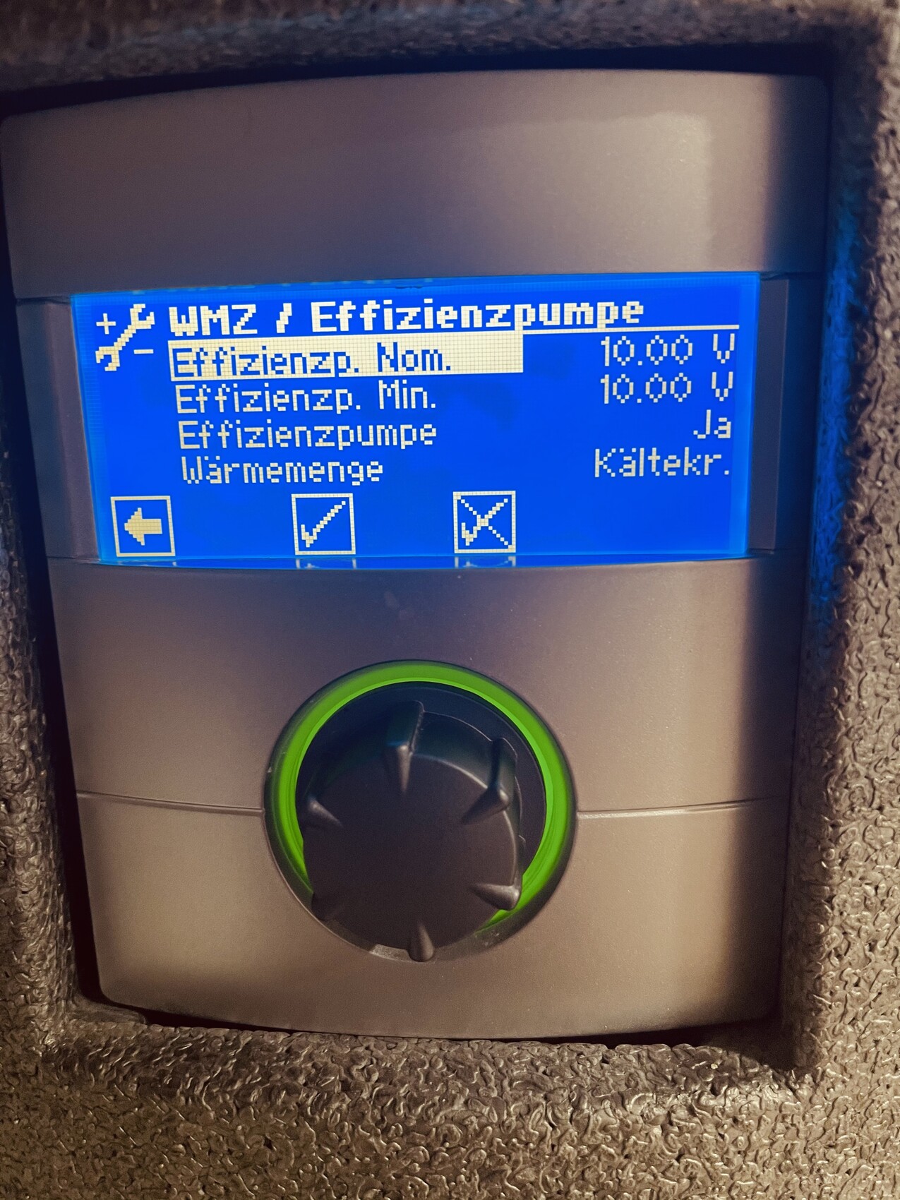

Z
Zaba12
13 Jan 2021 22:34
There is only that inside

Bookstar
13 Jan 2021 22:41
halmi schrieb:
Have you ever checked your flow rate during defrosting?
Ours usually modulates around 600 liters per hour (160 gallons per hour). During defrosting, the flow rate is about 1100–1200 liters per hour (290–320 gallons per hour). The system has been running continuously since December 24th.
Thanks, I will compare the values tomorrow. No, I will check the flow rate during defrosting tomorrow.
@Zaba12 Strange, it looks a bit different for me. But thanks!
halmi
13 Jan 2021 23:02
Here for comparison during defrosting, it can really only be due to the flow in your case.
