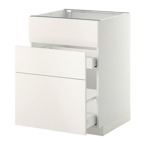

Berlinerin8516 Jun 2015 18:20Hello dear IKEA fans,
I seem to remember that with the old Faktum kitchen system, it was possible to connect two smaller fronts into one taller front using metal connector rods (on the inside; from the outside, it looked like two separate drawers). I hope you understand what I mean.
I can’t seem to find this option in the new Metod kitchen system. Does it not exist? That would be really inconvenient, as I definitely need 30cm (12 inches) high drawers.
Best regards from Berlin

Berlinerin859 Jul 2015 17:05Oh, thank you very much, IKEA expert. I was always looking in the wrong category and somehow thought they must have something like that in their range.
