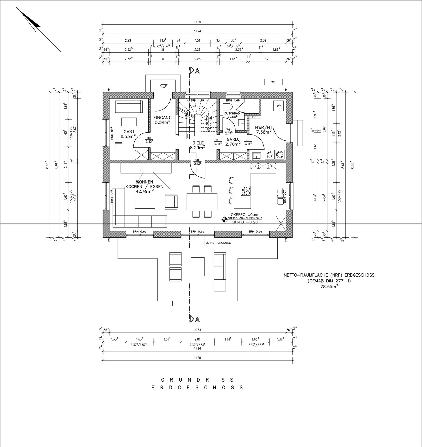

I like the ground floor layout. The dining area isn’t very large, but you want to optimize that anyway.
On the ground floor, the cloakroom is quite far from the entrance. This might lead to dirt being carried far inside.
Regarding the exterior: The large glass element looks great – how is shading managed? I recall a thread where shading a large glazed area afterwards was a bit complicated.
I would avoid the floor-to-ceiling window with the railing on the upper floor, especially since the rest of the façade looks so neat and clean.

I completely forgot to comment on that. Yes, my wife really likes the large window as well. We are currently waiting for the additional cost from the general contractor.
I’m afraid it might not work out unless it’s surprisingly affordable. On one hand, it involves a stairway window; on the other, it’s on the northeast side (so probably no shading is needed). In fact, we wouldn’t really benefit from that view ourselves—it would mostly be a display window for the neighbors. However, my partner strongly wants a bright hallway and can hardly accept the idea of replacing it with two 2m (6.5 ft) tall window units instead.
The nearly floor-to-ceiling window in the smallest child’s bedroom was drawn in that way by the architect. I wasn’t sure if it was artistic freedom or if there was a practical reason for it, possibly to maintain proportions since the window is quite wide?
PyneBite schrieb:
On the ground floor, the wardrobe is quite far from the entrance. This could mean dirt getting carried further inside.
Regarding the exterior view: The large
There is actually another wardrobe directly opposite the entrance. You could put a large shoe cabinet there with some hooks. Then the "coat wardrobe" could be placed in front of the stairs...

The utility room doesn’t have any windows except for the side door. So it would need to be a lockable patio door. Is that a problem?
Should there be a small window there, for example on the north side?
For the upper floor, should I add a window with a high sill on the north side in the bedroom?
Tolentino29 Apr 2020 15:09
Arrgh. While cropping the ground floor plan, I made a mistake. A small area was duplicated, which means the proportions are no longer accurate. Here is the correctly assembled version:
Ground floor plan: Open living area with kitchen, guest room, hallway, bathroom, stairs, terrace.

First of all, thanks for thoughtfully bringing up the questionnaire regarding the current plan. It looks quite nice. Instead of using decorative glazing bars for the stairwell window, you could also divide it by satin frosting of certain sections.
Pinky030129 Apr 2020 16:31
I find the living area too cramped. The table isn't large, and it’s supposed to seat 5 people (plus guests)? Is the kitchen intended to be as shown? It looks like you always have to squeeze past the table to get into the kitchen.
