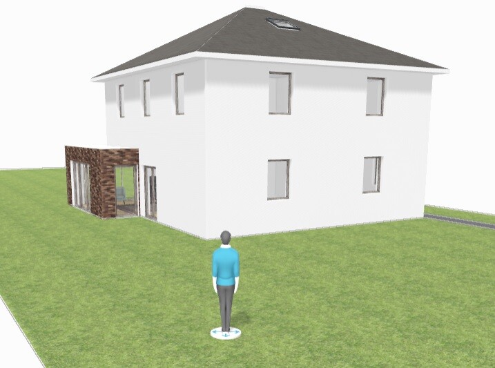

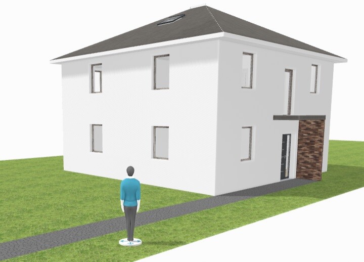

Hello, here is our design for our future single-family home for review. Based on your experience, does this layout work? Any major weaknesses? We would appreciate your feedback! Thanks!

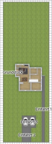

Check the floor area ratio
The long driveway and site development are costly.
What is your budget?
Why not a long, narrow house with a west-facing terrace?

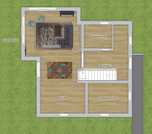

Dimensions are missing to properly assess the floor plan. Move the bedrooms out of the south side.
The dining area seems too small.

Is the south side facing the street?

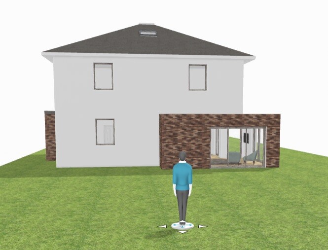

The kitchen area is too dark.

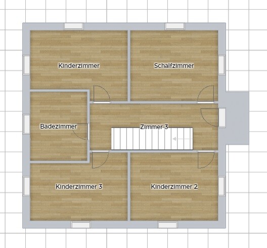

Please check all dimensions (stair length, entrance door, common windows). Less than one meter (3.3 feet) in width is too narrow.
Despite the panoramic windows on the west and north sides, sunlight is not being captured.

The floor area ratio is 0.2.
Costs are approximately 500,000€.
The external dimensions of the main structure are 10 m by 10 m (33 ft by 33 ft). The staircase is 1.10 m (3.6 ft) wide and 4 m (13 ft) long. We estimated the windows to be 1 m by 1.40 m (3.3 ft by 4.6 ft). The design of the windows, whether floor-to-ceiling or not, is still undecided.
The reason the house was designed as a square rather than a rectangle is due to the more efficient room layout on the upper floor.
In the southwest top view, you can see that we have added a south-facing window in the extension. A second west-facing window in the kitchen is also feasible. Since we will probably design an open-plan kitchen, the rooms should get enough natural light, right? Would floor-to-ceiling windows possibly help?
