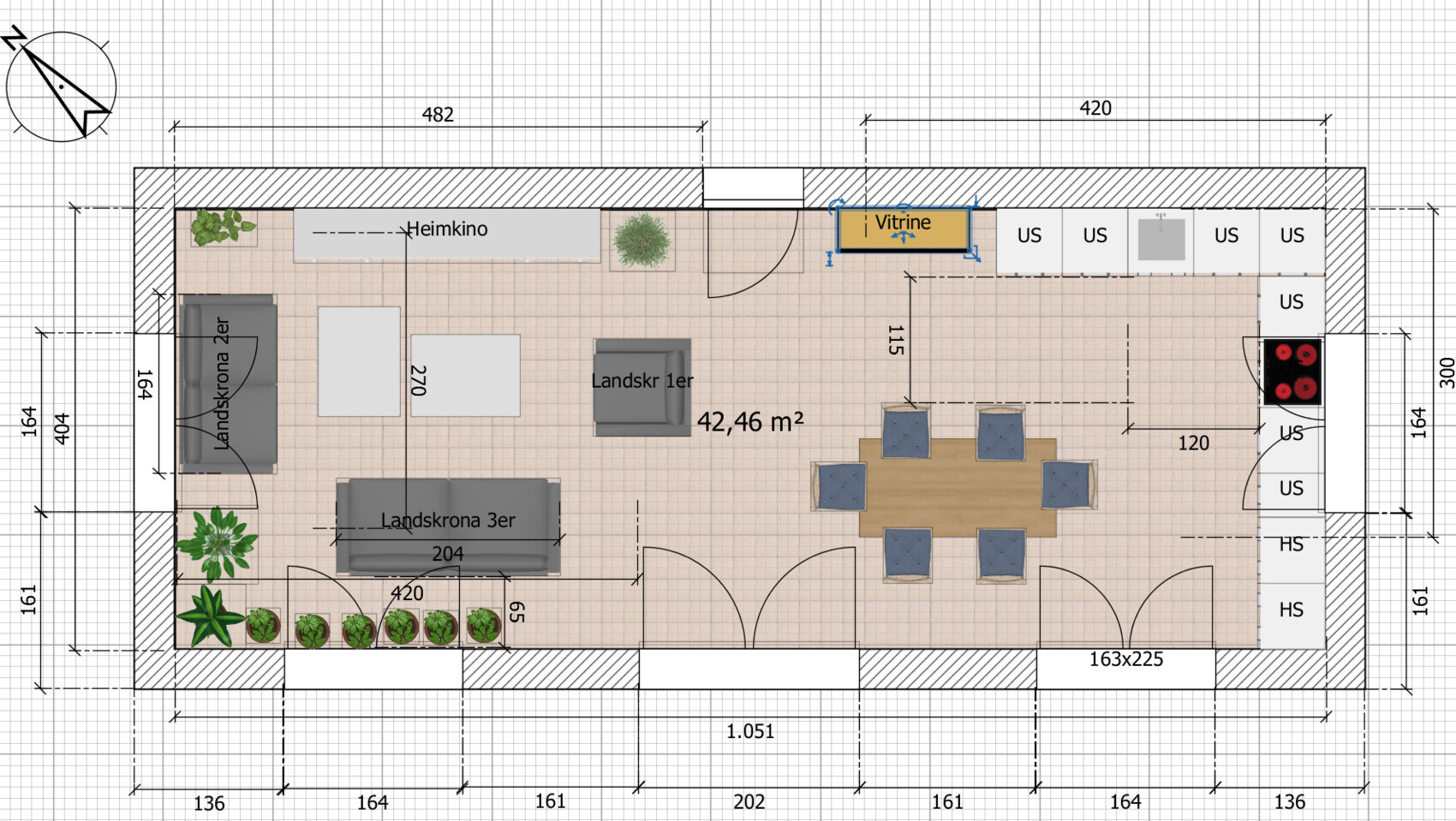

Tolentino30 Apr 2020 13:03
- Current self-designed layout, open-plan furnished with L-shaped kitchen variant 2:

Open living and dining area with sofa set, dining table, display cabinet, kitchen unit and plants
Pinky030130 Apr 2020 13:03
I prefer the L-shape. It makes the whole space feel more spacious. This way, you can also extend the table when guests come over. The cabinet layout can still be optimized.
Pinky030130 Apr 2020 13:07
kaho674 schrieb:
By the way, I would replace the door with a double sliding door.
A larger door leading to the living area would be really great. If there isn’t enough space for a sliding door, maybe a double-leaf door would work?
Stairs on the ground floor: isn’t there a risk of tripping on the first step when entering? The passage seems narrow to me.
Tolentino30 Apr 2020 13:07
kaho674 schrieb:
Are you talking about a grandma’s basement kitchen or what? New houses should be completely dry, otherwise something was done wrong. Or are you afraid of something else besides mold?
I believe I’ve read that here as well. But if that’s not true, it certainly makes things easier.
kaho674 schrieb:
By the way, I would replace the door with a double sliding door. But that’s probably too expensive again.
A double leaf door has been requested. I’m considering a sliding door, or at least need to look into it. What I’ve seen so far didn’t appeal to me. In theory, you could even go without a door since the entrance is offset anyway.

Pinky0301 schrieb:
Stairs on the ground floor: don’t you risk tripping on the first step when coming in from the entrance? The passage seems narrow to me.
@kaho674 already pointed that out. Maybe request a rotation of the stairs, if that doesn’t cause tripping on the other side or block the doors upstairs.
However, I already asked about removing those short wall sections (“stub walls”) there. The architect isn’t sure yet if they’re structurally necessary. He would remove them initially. That should relax the space a bit...
