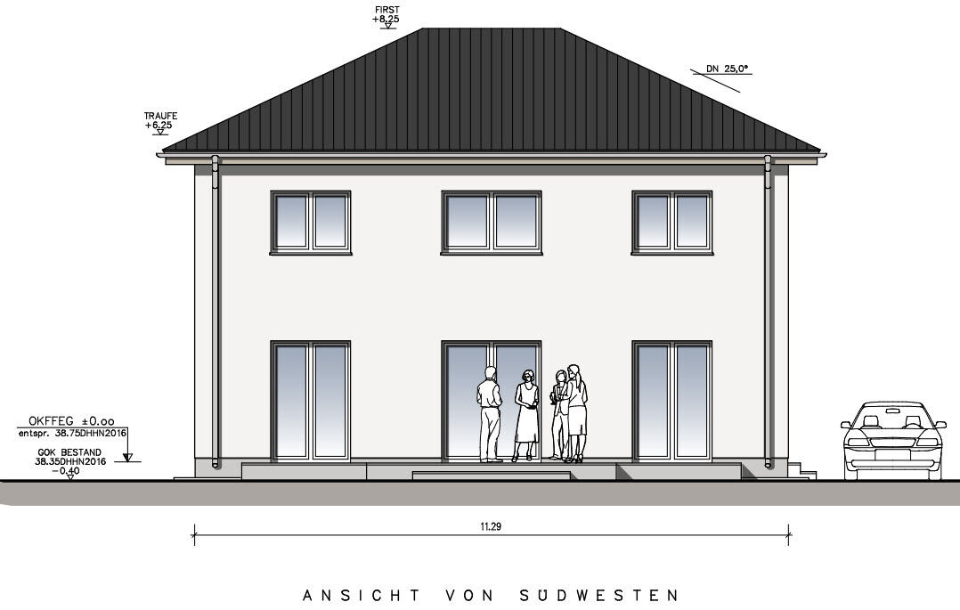

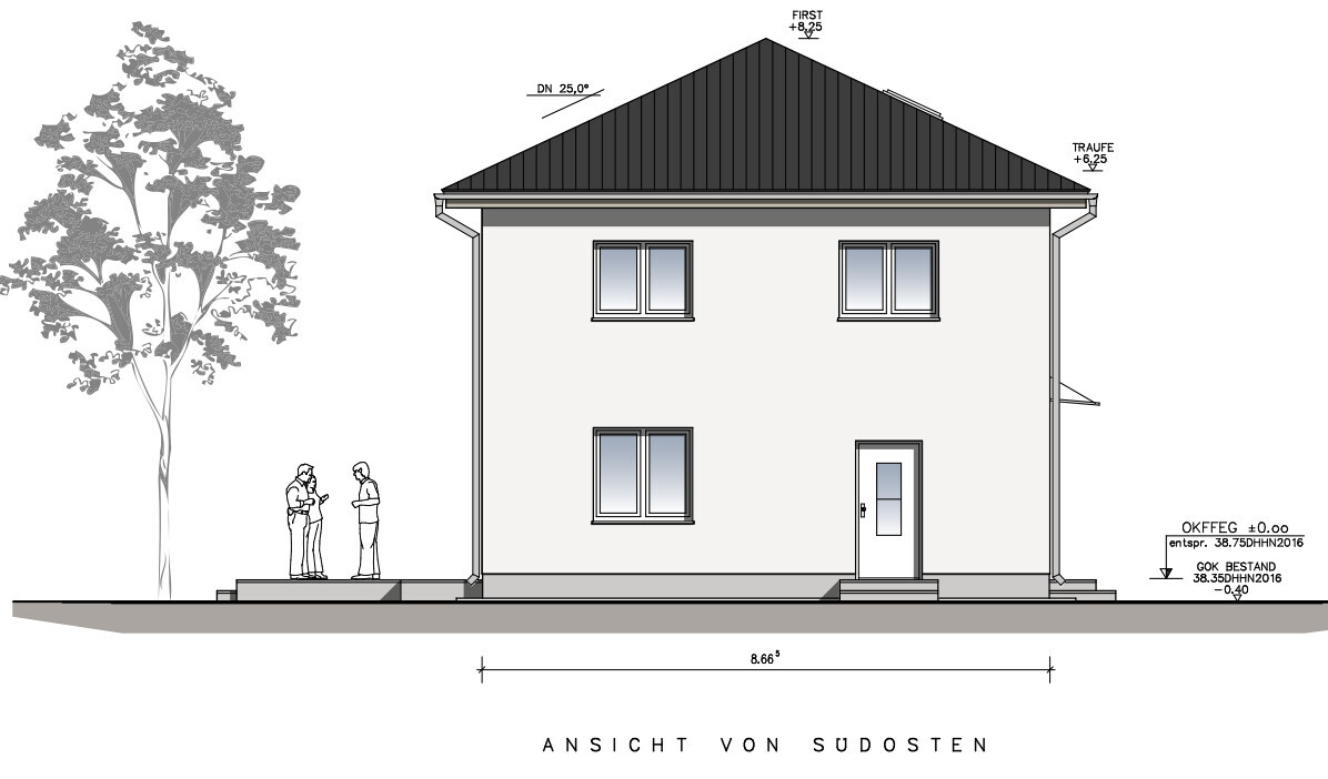

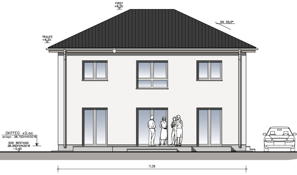

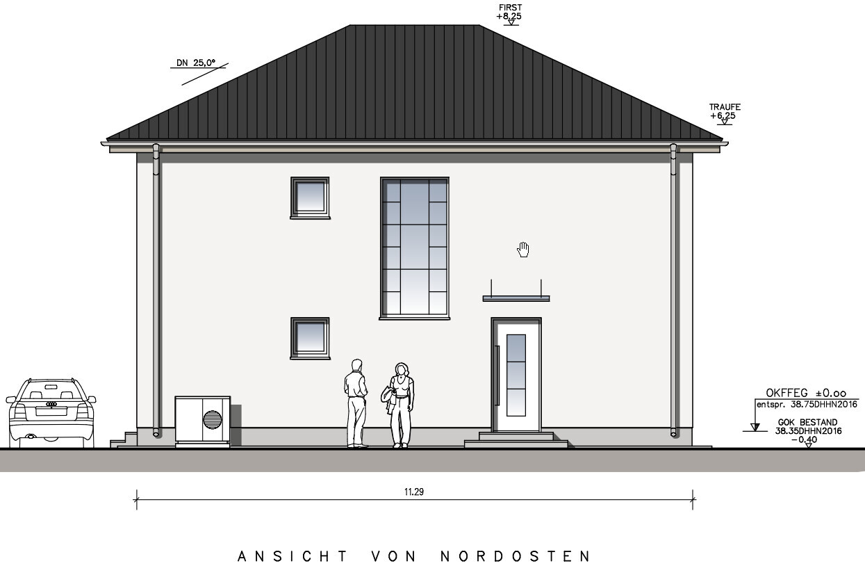

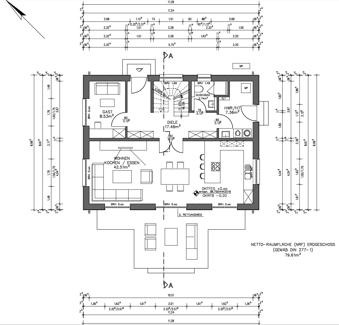

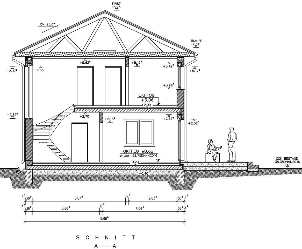

The new draft from the architect is here.
Changes on the ground floor:
The "stumps" in the hallway are gone (apparently they are also not structurally necessary).
The staircase has been rotated. I think this still works on the utility room side since the stump is also missing there.
However, I’m not sure if this is really the better option, because this way the wall next to the staircase needs to run the full depth of the stairs, as the staircase must be fixed to this wall.
The other way around, the part of the staircase extending into the hallway can only be built half-height, which makes the entrance area feel more open.
What do you think?
The door to the living area is now double-leaf. I like it.
The northwest windows are now floor-to-ceiling.
There is now a secondary entrance door drawn in the utility room. However, I also want a floor-to-ceiling window there for ventilation, which can be opened from the outside via a lock. What are the security aspects here?
My current assumption is that although a patio door might generally be less secure, this doesn’t really matter here because I have many floor-to-ceiling windows on the ground floor anyway. So this weak point already exists...
Is there anything I’m overlooking?
Large staircase window: now slightly reduced in size (probably still not large enough) but I think it still looks great (see northeast view). The problem is that the general contractor currently refuses to install windows larger than 2.25m (7 feet 5 inches), while the architect has still drawn 2.85m (9 feet 4 inches). I had actually asked him to also draw a variant with 2.25m and another with two windows that follow the stair rise. I saw that solution mentioned in some thread here in the forum and liked it. I will still pass it on to him.
Changes on the upper floor:
Not much here, as I just followed the suggestion from this forum and asked the architect to create variants for the windows in the middle children’s room.
Personally, I’m not so sure if I really prefer having all the window heights the same. Yes, it looks "cleaner" but also a bit rigid and boring. Although I don’t like these fall protection elements, I find the fixed panel at the bottom even more unattractive.
I would appreciate your comments, suggestions, and ideas...
Tolentino
Links to previous drafts are exactly one post above, so I’m skipping relinking here...
From those it is also clear that the sofas and kitchen furniture drawn in the living area do not correspond to the current planning status...
Upper floor floor plan: bedroom, three children’s rooms, bathroom, hallway, staircase, dimensions.
Floor plan: open living/cooking/dining, guest room, hallway, bathroom, utility room, staircase.
Two-story house with gable roof, large windows, two people on the right, northwest perspective.
View from the northeast: two-story house with door, window front and two people in front.
Southeast view of a two-story house with dark roof, tree on the left, two people in front.
View from southwest: two-story house with hipped roof, window front, group of people at the entrance.
Two-story residential house with gable roof, window fronts, group of people in front of entrance; car on the right.
Two-story house with dark hipped roof, group of people in front of entrance, car on the right.
Cross-section of a two-story house with staircase, roof structure and windows.

The open-plan room’s proportions are not comfortable, and it is questionable whether the dining table can be easily walked around or the patio door accessed conveniently.

The staircase doesn’t need a wall there, right? It would look something like this (just mirrored):

The open-plan living area doesn’t feel comfortably proportioned, and it’s questionable whether a dining table can be easily walked around and the patio door simply accessed.
What do you mean by proportions? The distribution of floor space among the different functional areas? Or the length x width x height of the room?
Ah, thanks for the example. I will have to clarify that with the architect or the general contractor. That was just the architect’s initial comment. Maybe he was just accommodating the general contractor’s usual peculiar concerns in advance. Thanks for the picture!
