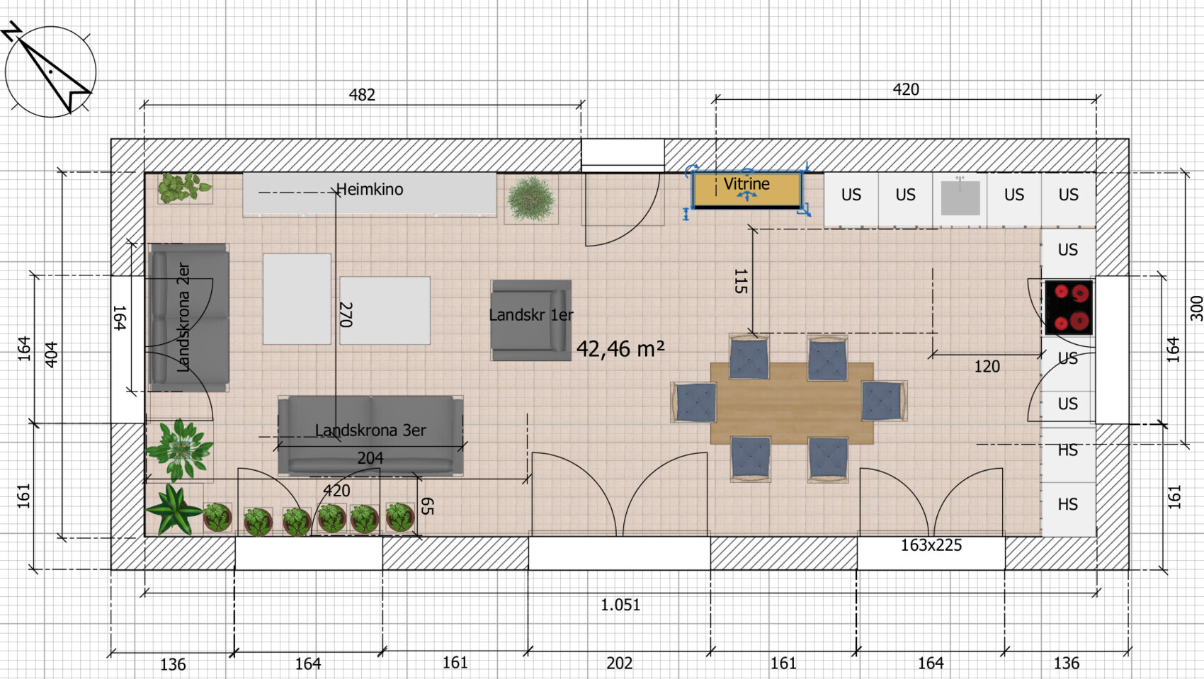

Dining areaIf I’m not mistaken, there isn’t actually a dining area in the case of the L-shaped kitchen, right?Baufie schrieb:
I wouldn’t enlarge the entire house but rather extend a bay window in the dining area and the kids’ room above. I see more chances of getting an exemption there if the floor space ratio becomes tight.Okay, I will bring that up with the architect as an alternative. Would such a bay window, which would also need to be deeper (2-3m (6.5-10 feet)?), be cheaper than lowering the entire house by 0.5m (20 inches)?
There isn’t a real floor space ratio due to §34 anyway. I must admit, off the top of my head, I don’t know if there are many houses with bay windows nearby. The direct neighboring houses are rather very straightforward. Maybe I’ll take a closer look in the next few days.
Pinky0301 schrieb:
If I’m not mistaken, there isn’t actually a dining area in the case of the L-shaped kitchen, right?Well, it depends how you look at it. There is a dining area, but you could say the kitchen and dining area are one space, since the absence of a peninsula means there isn’t a real separation between kitchen and dining. A bay window would, of course, create that separation again. But for that, the bay window would need to be wide and deep enough. The 4m (13 feet) width from the kids’ room is probably sufficient, but how deep does it need to be?
And especially, you wouldn’t really walk through the dining area onto the terrace anymore if someone is sitting there...
Here again, as a reminder, is the self-designed open-plan living area with L-shaped kitchen:

I would estimate the bay window here to be about 125 cm (50 inches) deep and as wide as the middle children’s bedroom. These 5 m² (54 sq ft) will naturally be significantly more expensive than the standard square meters; even with a pitched roof, which I would recommend (adding a third gable would make the additional cost unreasonable). But as I said, in your self-planning variants, I don’t see it as required—just as little as adding extra building depth to increase the floor area without a clear purpose. Don’t let yourself be unsettled: size is relative—having "this much" space near the central area of the federal capital will already cause some envy in Stuttgart. And even in local comparison, you’ve made a good choice—I recall from last year (and still not satisfactorily resolved) a thread involving a backyard infill with complex house height integration by @LotteBerlin: https://www.hausbau-forum.de/threads/Beurteilung-bauauflagen.33027/
just as little as adding extra square meters to the total area diffusely by increasing the building depth.Well, I wouldn’t want to distribute it diffusely but explicitly add it to the open-plan area and the children’s rooms in depth. Or do you see any obstacles there (structural stability?).11ant schrieb:
These 5 square meters (54 square feet) will naturally be significantly more expensive than the standard square meters;Okay, then the bay window would be out anyway.
