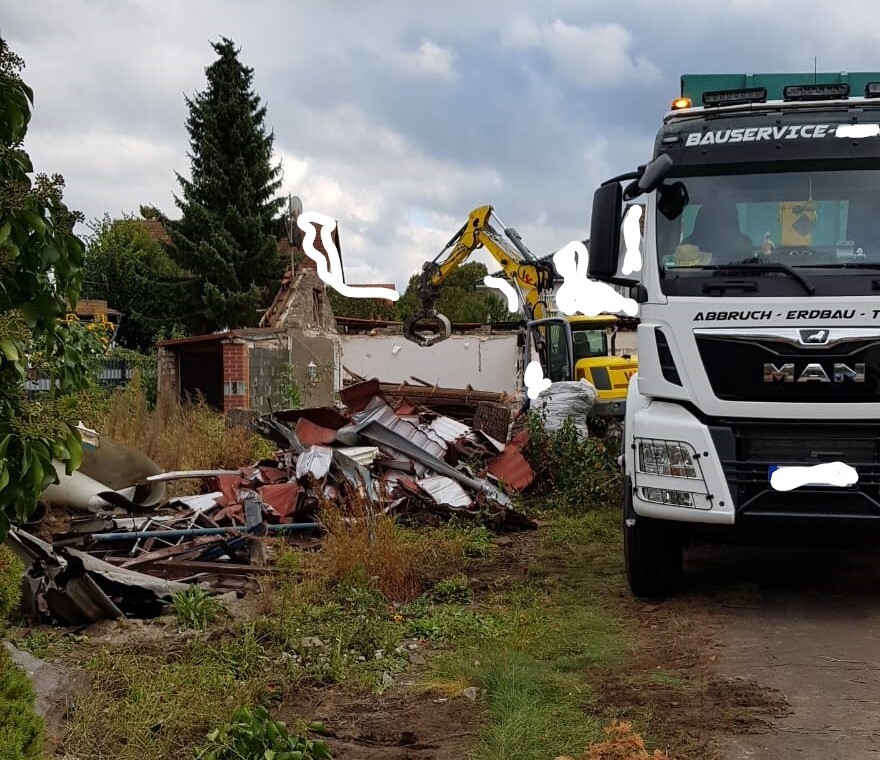

Demolition started this morning.The building components (conservatory and other windows) still look quite new—it's a shame to scrap them. How much does the demolition cost with mixed debris, and have you compared that with a dismantling option using separated recyclable materials?https://www.instagram.com/11antgmxde/
So, my neighbor has already secured the windows from the conservatory for his garden shed. So their further use is already assured. The windows in the house are actually old double-frame windows with single glazing, even though they still look relatively new.
The total demolition cost is just under 30,000 EUR. This is a flat rate including disposal, although according to the offer the house will also be dismantled. At least that is how it was stated.
It was the best offer out of five (and four actually present). The overall range was from 20,000 to 60,000 EUR. The one offering 20,000 seemed unreliable and didn’t even show up. The one at 60,000 was actually a janitorial service (?!?!). The other three were all within about plus or minus 10%. One didn’t want to provide a flat rate for the asbestos and roofing felt removal, instead recommending we handle that privately.
The company now doing it made 1. the flat rate offer, 2. had previously worked with my general contractor but stopped on their own due to “differences of opinion.” However, they were recommended by both my general contractor and the realtor.
They made the best impression, always responded fastest, and might possibly help me later with earthworks and groundwork for the utilities. We’ll see...

So, the sorted piles are placed to the right of the house, visible in the last photo but partially covered by the truck. Some materials need to be sorted, while others can be put together as mixed construction waste in the large container.
I’m hearing about debris testing for the first time. When is it needed? Who decides that?
I will receive a waste disposal certificate...
We have already removed quite a bit. From the fence panels shown in the photo, we made a total of five just using planks and beams from the floor structure of the house. As mentioned, the neighbor took the windows as well as the two front doors. We sold the gas boiler.
Other than that, there was nothing I really wanted to keep...
Unfortunately, I overlooked an old radio box when inspecting the crawl space. That would have made a collector happy, of course. Well, now one of the workers will be happy instead...
