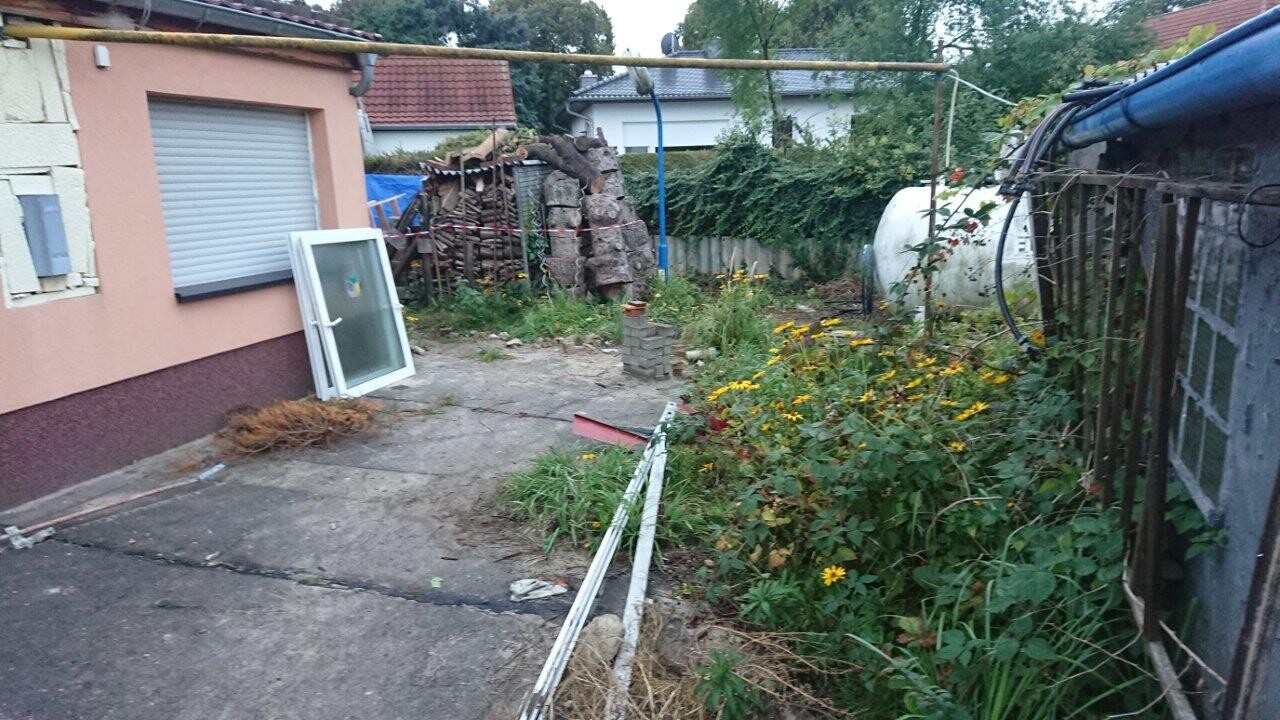

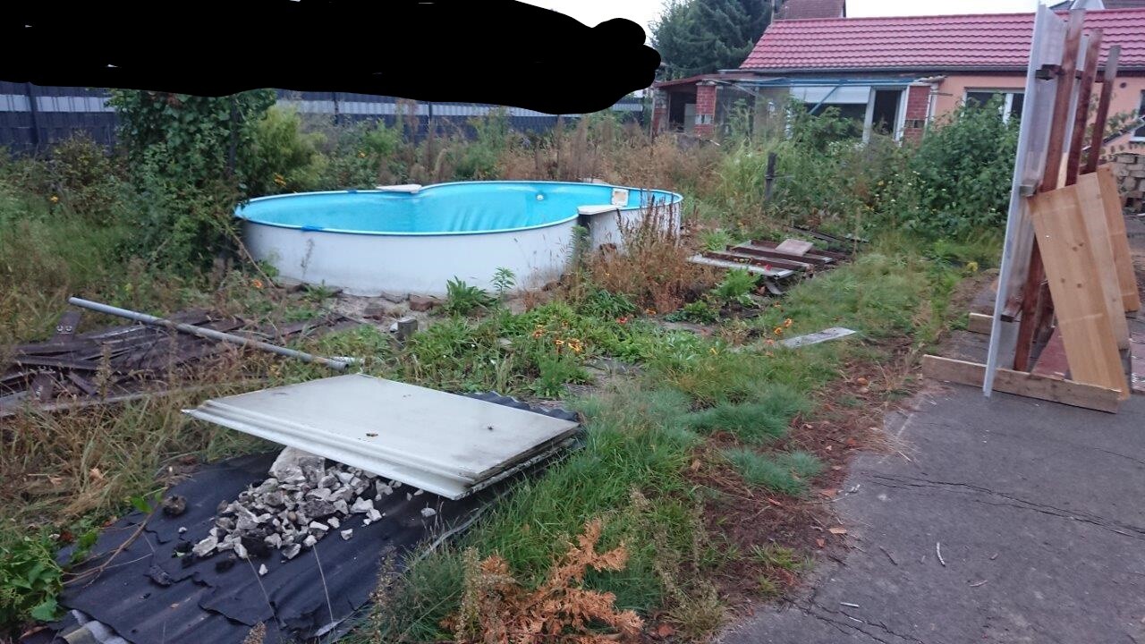

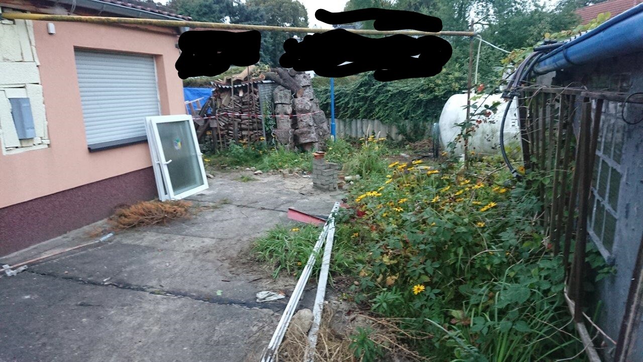

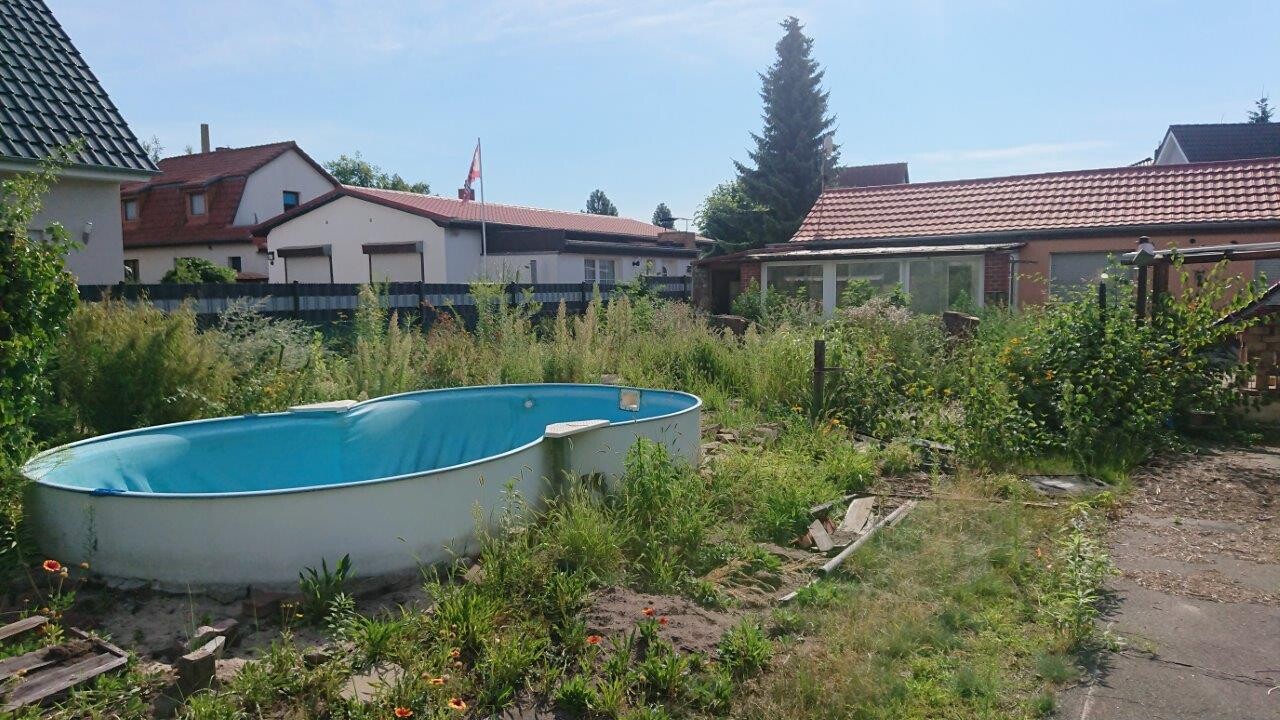

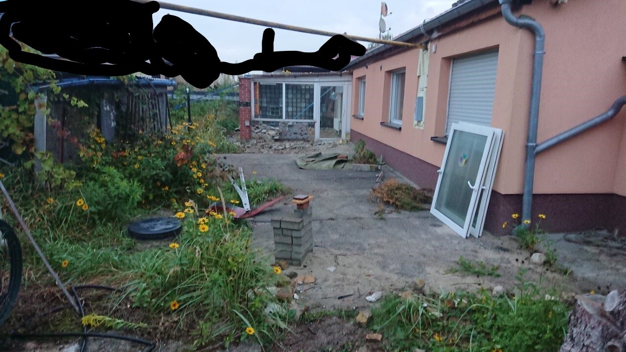

This morning, the demolition started. A few impressions.
Before:
Abandoned garden with a round blue pool, construction debris, and wood scraps.
Overgrown garden with wooden planks on the wall and a shed in the background.
Small backyard garden area next to the house: door, leftover construction wood, yellow flowers.
Garden in front of an orange-colored house with construction waste, window frames, and yellow flowers.

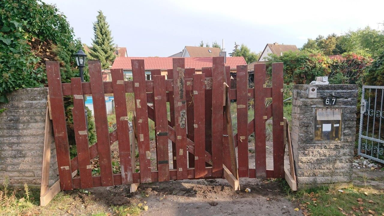

Self-built construction fence (ready for the zombie apocalypse):
Temporary red wooden fence made of narrow slats in front of a house, stone pillar with number 67 on the right.
