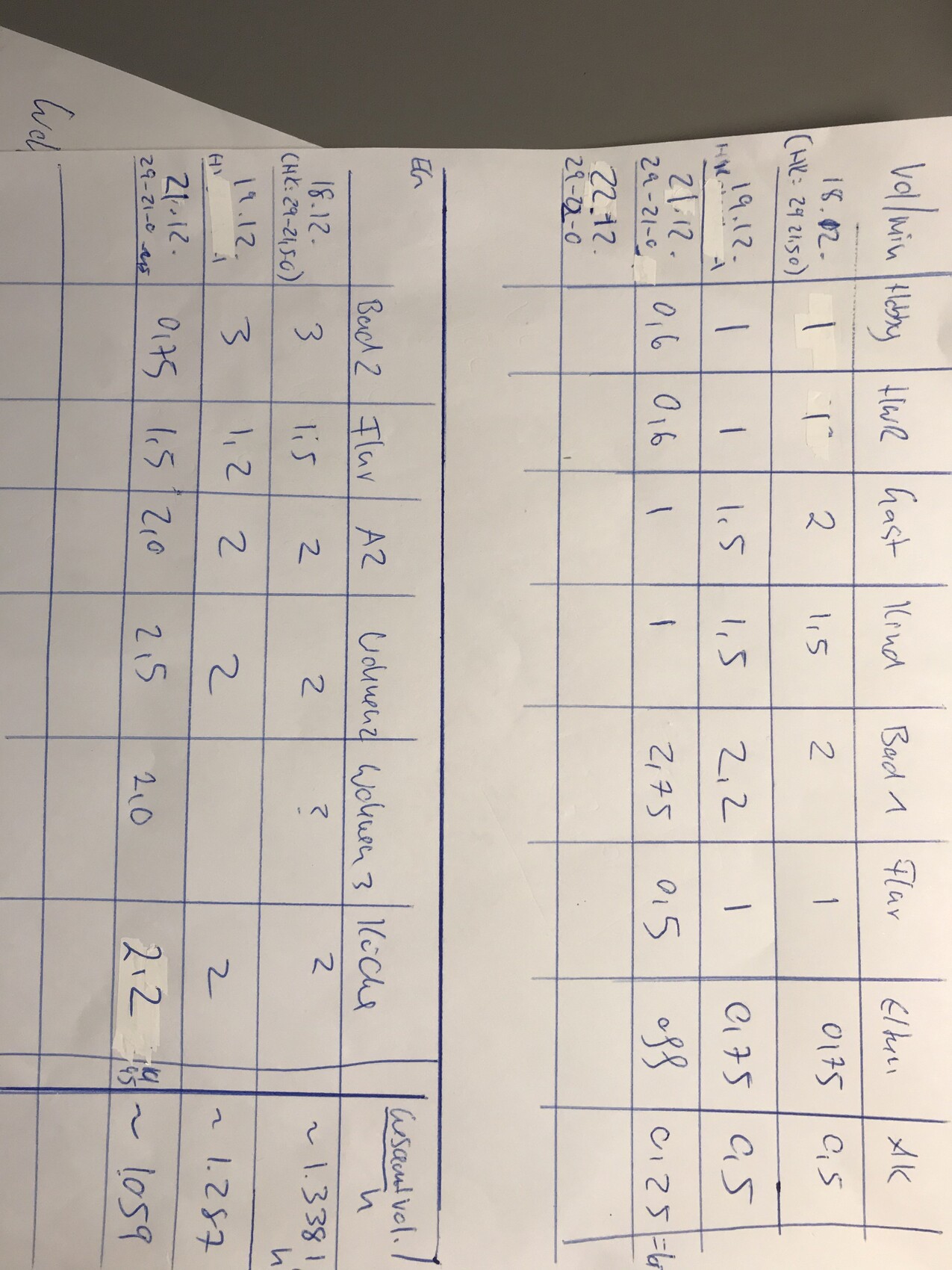

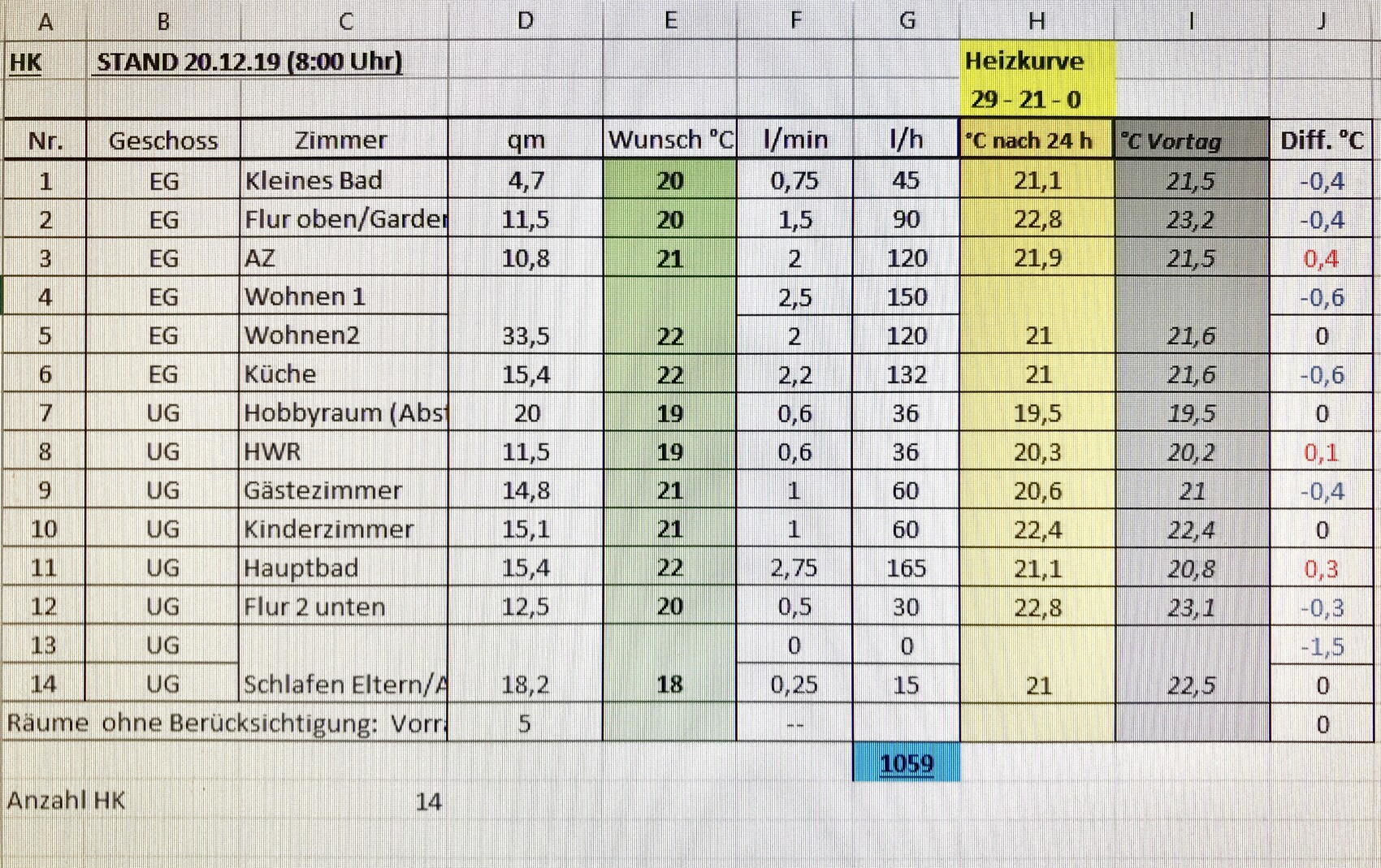

Okay, here are the data from this morning. The heat pump was just finishing its cycle, so I was only able to read the basement values. When I went upstairs, it had already stopped. The flow volume is now only 1059 per hour in total—is that too low for LAD9? The temperatures now seem to be fine. However, I adjusted the heating curve again late yesterday evening to: 29-22-0. Because, for some reason, the living area and the large bathroom were only at 20.6°C (69°F).
Daniel-Sp20 Dec 2019 11:14The temperature difference of almost 10K in the bedroom is good, and the temperature has already dropped by 1.5K.
The high temperatures in the hallway are surprising despite a large temperature difference and low flow rate. Maybe the screed still needs one or two days to adjust. I would wait until tomorrow for now. I remain concerned about the main bathroom, which seems to be undersupplied by the underfloor heating. You might need to supplement heating there if necessary.
