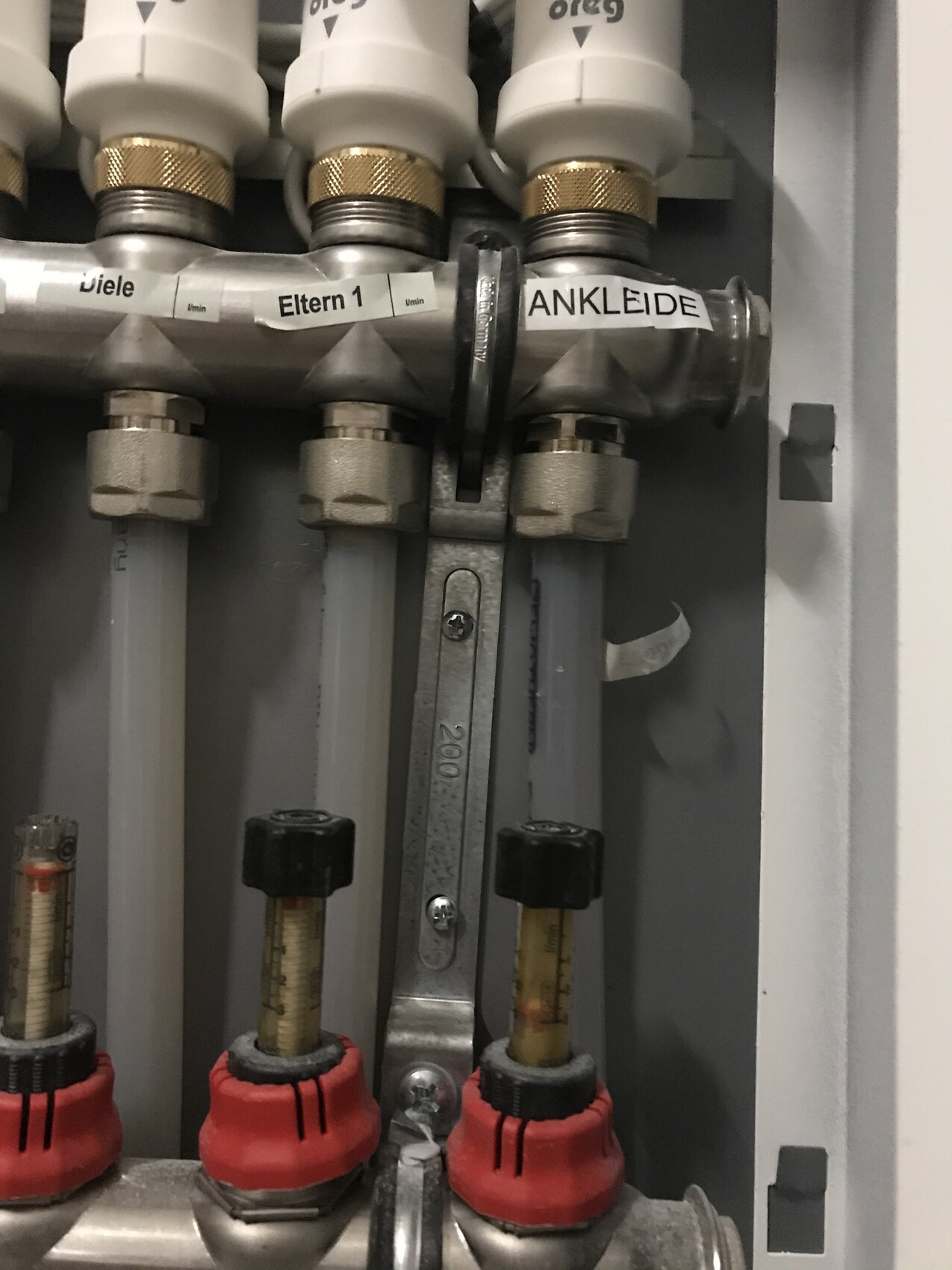

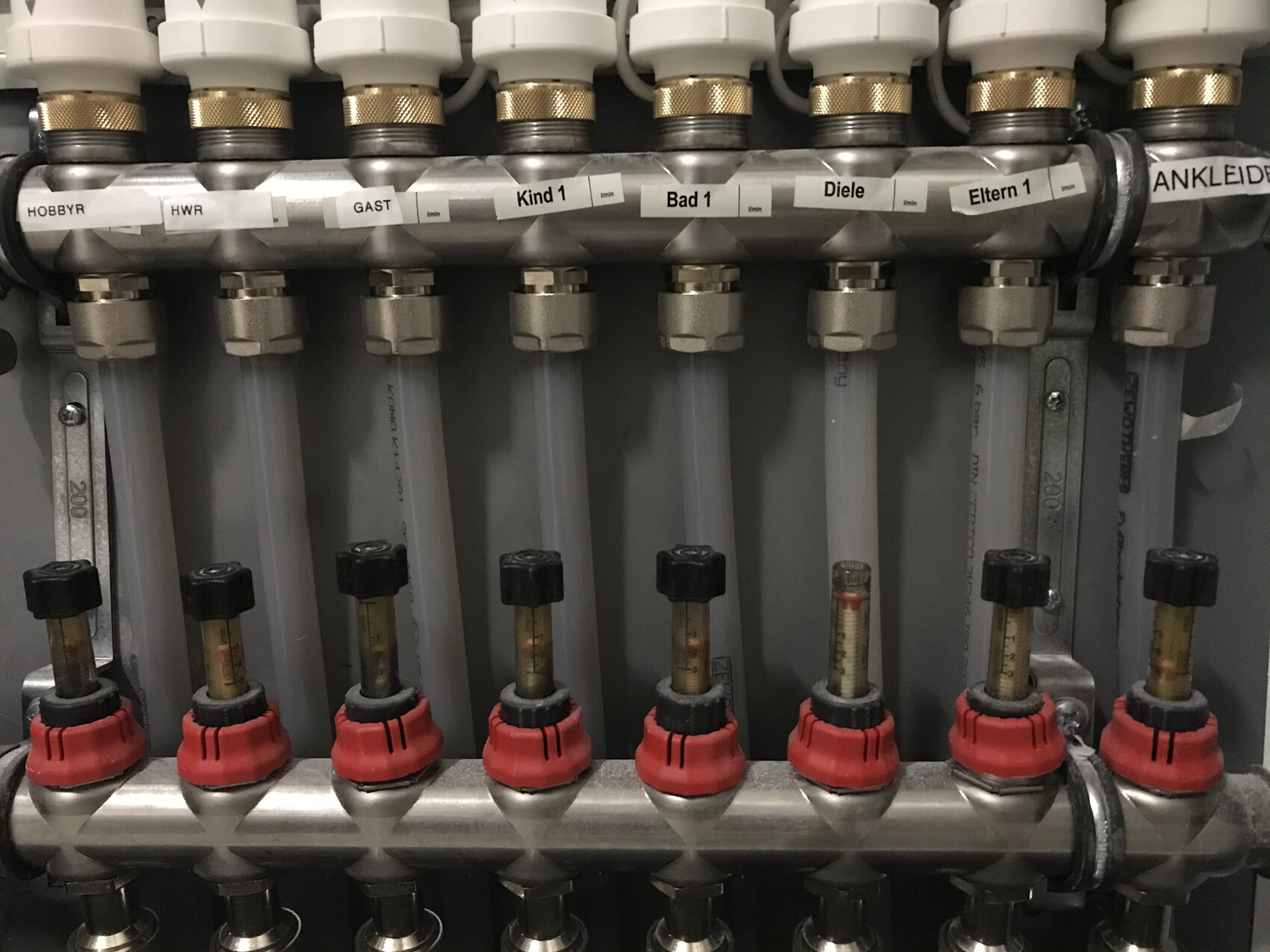

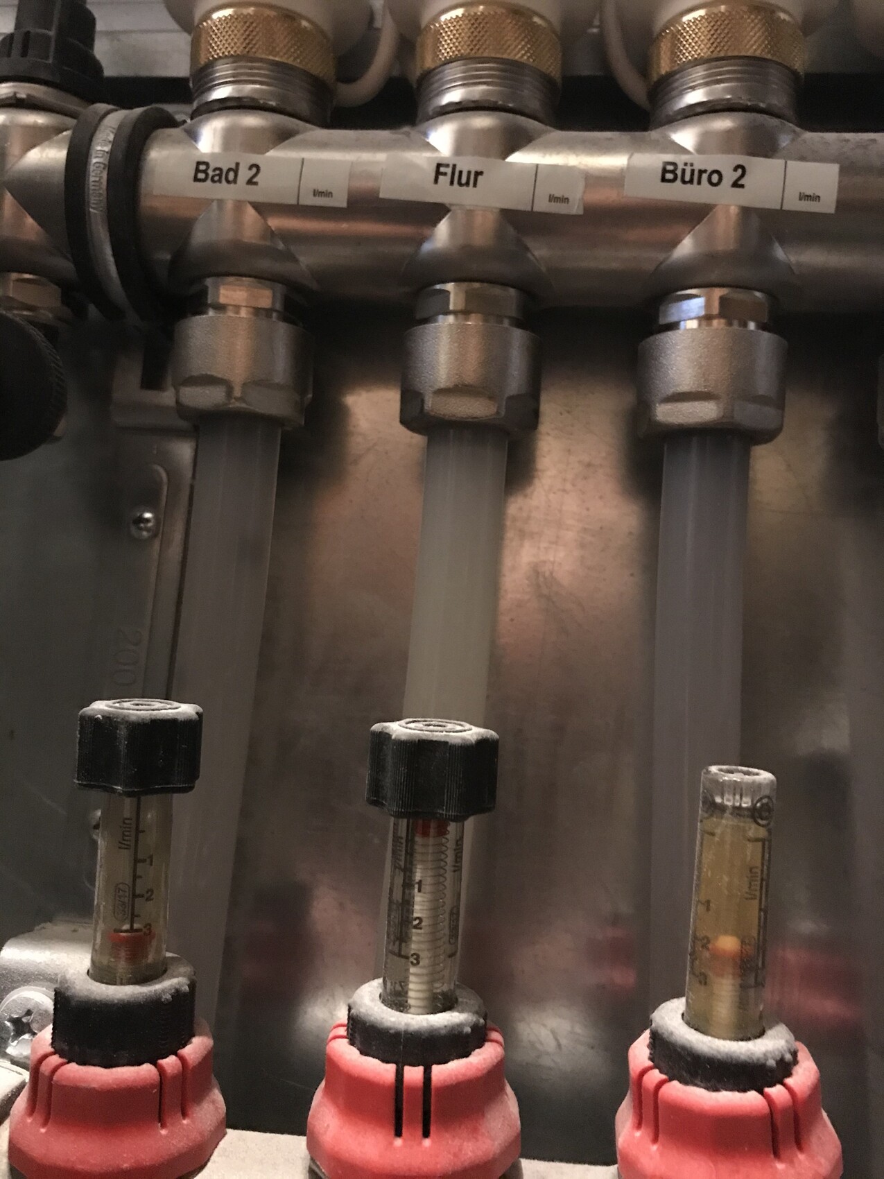

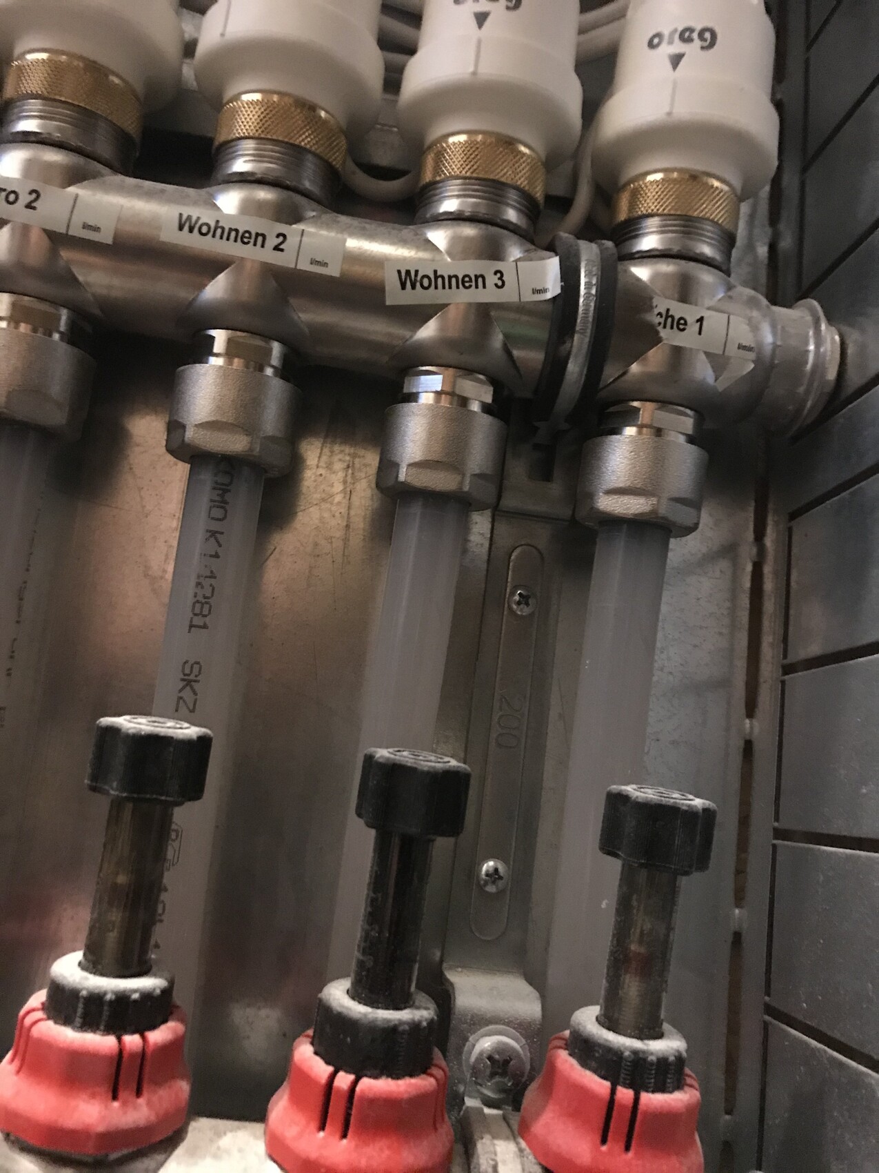

How large are the heated rooms, how many heating circuit distributors do you have? How are the heating circuits divided? Hey, I took some pictures of the heating circuit distributor. Part 1 is the ground floor, part 2 is the basement (bedroom, guest room, hobby room, and main bathroom).
The main bathroom (15sqm (160 sq ft)) is too cold, and the guest room (15sqm (160 sq ft)) is now too warm, even though it’s not set that way.
The installer wanted to reduce the flow from the master bedroom and increase it in the bathroom but that didn’t help at all.
I don’t actually know what kind of pump we have, modulating? Man, I feel really clueless. Sorry… Regards, Ina
Daniel-Sp13 Dec 2019 17:03Could you please list all the rooms per floor, including the size of each room and the number of heating circuits?
Do you have underfloor heating only in the bathrooms?
If you don’t mind, you can also share the floor plans of the levels.
