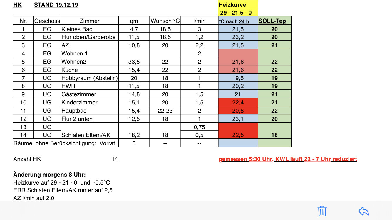

You can reduce the parents’ zone to 0.75. Tomorrow, measure the return temperature while heating. Then adjust the return of the dressing room accordingly. Both heating circuits should have approximately the same return temperature.
Please measure the supply and return temperatures of the small bathroom, then check the current supply and return temperatures in the heat pump control and set both accordingly.
The return temperatures in the living area should also be roughly the same.
If you have bought the recommended thermometer, you can measure directly by placing it on the pipe, taking three readings for verification.

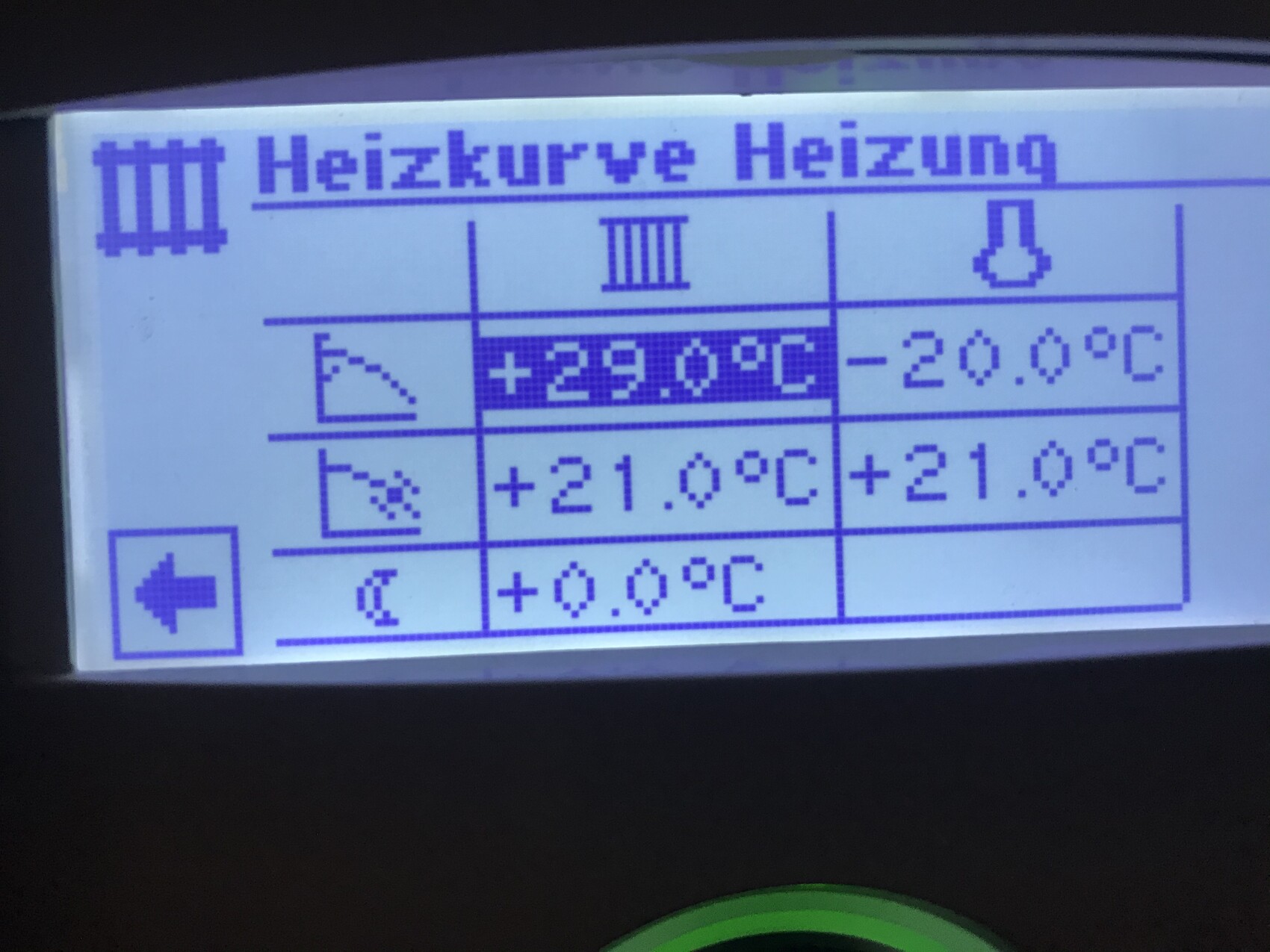

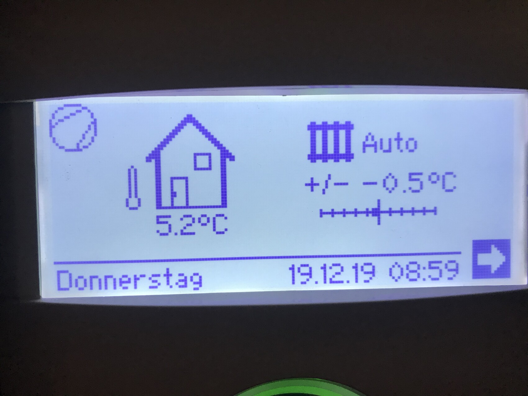

Good morning, here are the data from this morning. Nothing has changed again :-( total heat in the bedroom and hallways, but the bathroom is still only 20.8°C (69.4°F). I have now set the ERR to 2.5 while sleeping, I can’t leave it that hot, our baby wakes up every 2 hours (usually sleeps through the night).
Temperatures were measured at 5:30 am, at that time the controlled ventilation system was running at reduced power (from 10 pm to 7 am). I have adjusted the heating curve to 29-21-0 and set -0.5 on the main settings.
The pump has been off for 4 hours, so no data yet on supply/return temperatures.
The technician is coming this afternoon. He is supposed to boost heating in the bathroom and living area!
Daniel-Sp19 Dec 2019 09:38Hallway and bedroom each lowered by 0.4 meters (1 ft 4 in), small bathroom at 2 meters (6 ft 7 in). I am now on my way to Denmark, will check in again in the evening. Please also provide the supply and return temperatures for the small bathroom.
