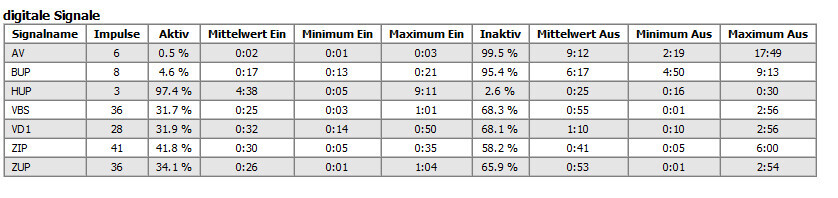

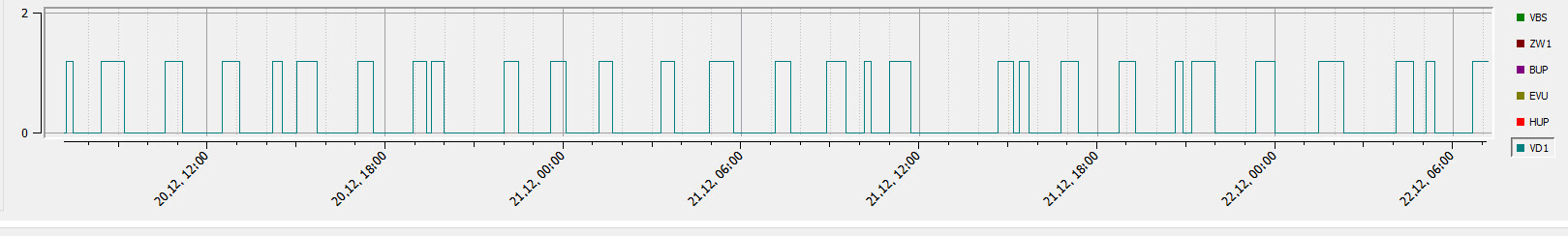

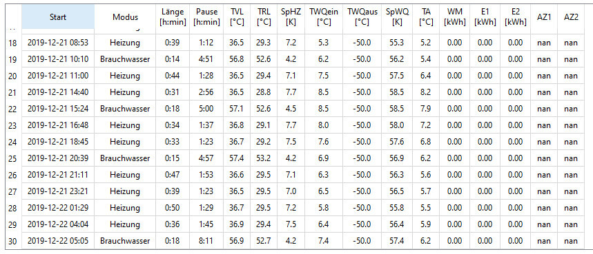

This will give you a good estimate. This morning’s data, temperatures are already better, living area now 21.5°C (71°F) instead of 20.9°C (70°F).
But the bathroom is still only 20.8°C (69°F), which is crazy. We gave it so much more volume :-/
Hallway still 22.8°C (73°F). Radiator is: 29.5°C (85°F) - 22.0°C (72°F) - 0 (I had increased the supply temperature by 0.5°C (0.9°F))
Daniel-Sp22 Dec 2019 08:45I still firmly believe that the bathroom is undersupplied by the underfloor heating :-(
What is the setting for the hot water hysteresis?
I still find the heating cycles a bit too frequent...
Daniel-Sp schrieb:
I still firmly believe that the bathroom is undersupplied with underfloor heating :-( What is the setting for the hot water hysteresis? I still think there are a bit too many heating cycles... The hot water hysteresis is set to 6. Yeah, it's a bit of a pain; somehow I’m hesitant to adjust the pressure relief valve.Daniel-Sp schrieb:
What is the hot water hysteresis set to?
I still find the number of heating cycles a bit high... My power consumption also continues at 20 kWh per day :-/
