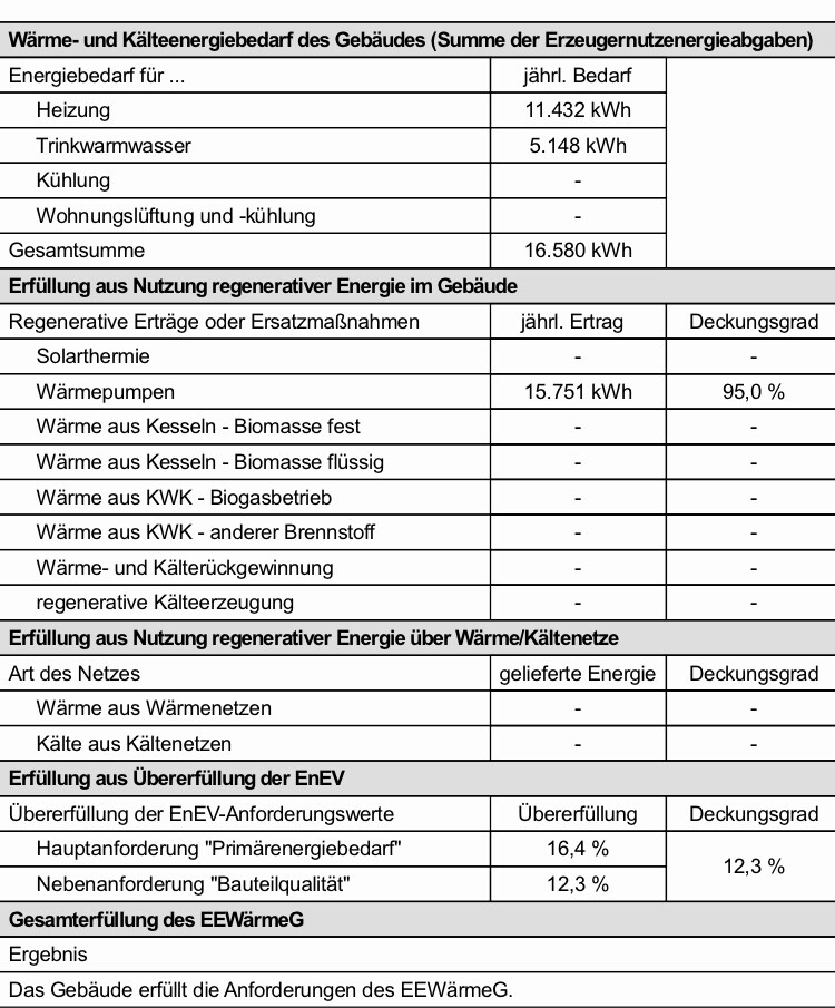

Daniel-Sp schrieb:
Then there will be no change regarding heating cycles and electricity consumption.Here is an excerpt from our energy performance certificate; can you make use of this? D
Daniel-Sp22 Dec 2019 11:49No, the required data is not included there.
Daniel-Sp schrieb:
No, the required data is not included there.Too badD
