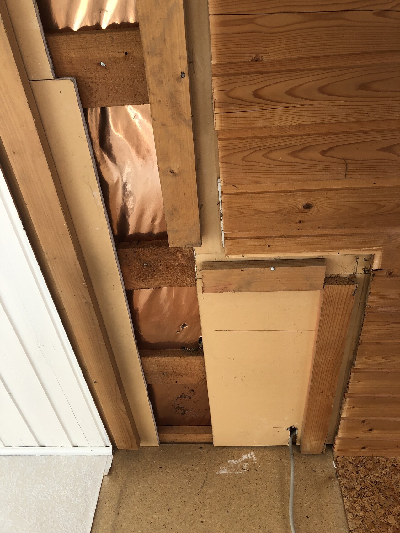

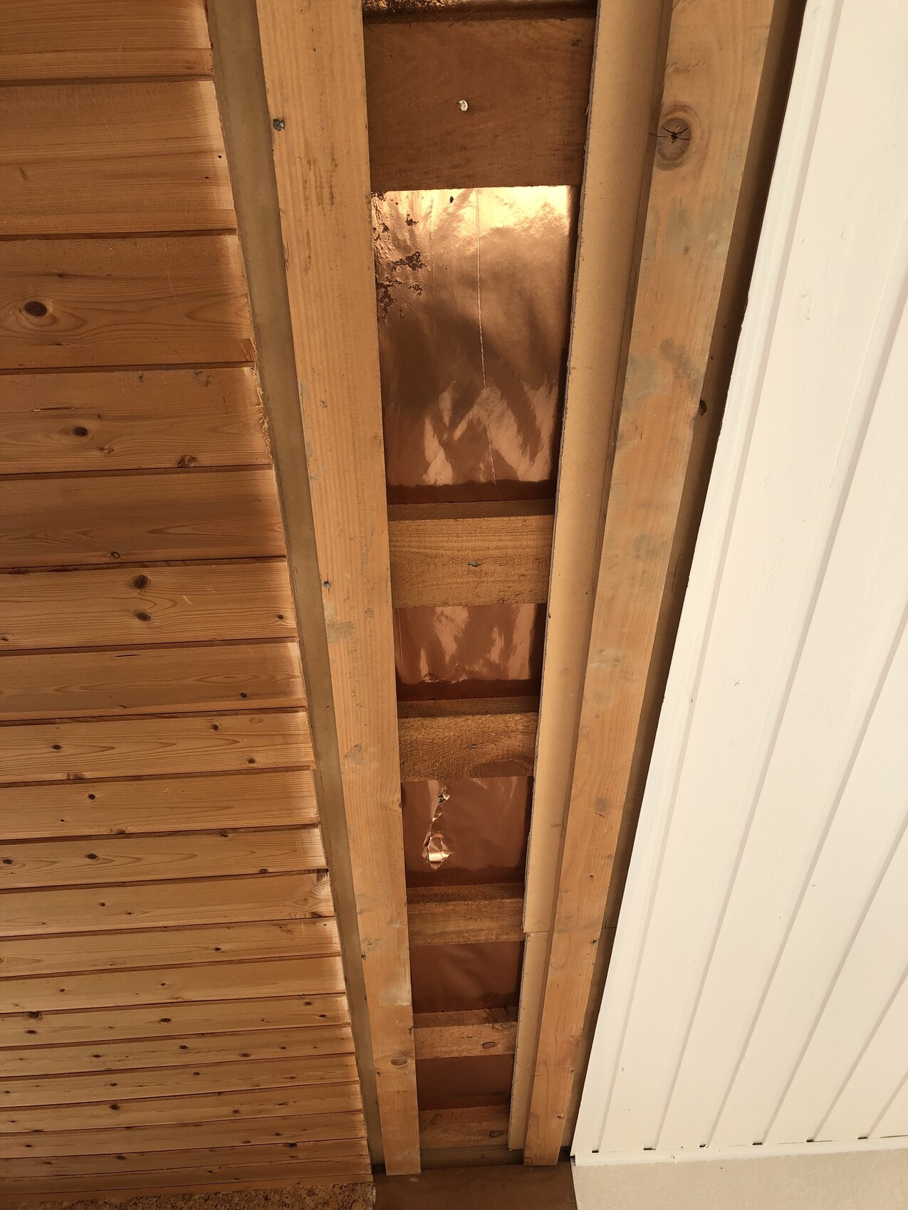

Hello everyone, I haven’t checked in here for a long time. We’re still living in our Landskrona and have been busy with work. But recently, I discovered an unwanted tenant in our intermediate ceiling :/
I mean the ceiling between the ground floor and the attic. I’m curious about the construction of this ceiling because I’ve noticed some movement and would like to understand it better. Unfortunately, I still don’t have any documents or plans for our Landskrona.
Does anyone have information about the ceiling structure?
I suspect the modules have joints where a mouse could easily get through. But it almost sounds like the entire ceiling is hollow?
Many thanks and best regards for your help.

Hello Elementhus_CJ, we have a "Borgholm," but the ceiling construction is probably the same. I can also provide drawings. Send me an email at christoph_ät_hippelandexpress_Punkt_de. There seems to be an older and a newer version; at least our previous owner (who handled sales in this area) noted for our house "walls new, ceilings old." The ceiling panels are filled with compressed planing and sawdust. The individual panels are separated by plywood boards and dampened with corrugated cardboard or similar materials. It’s possible that an uninvited guest made its way through there. Cables also run through these cavities.

On page 1, I took apart a wall element. The ceiling elements have the same structure: 2cm (0.8 inches) cross-laminated timber, 16cm (6.3 inches) planed wood chips, 2cm (0.8 inches) cross-laminated timber. Between the elements, there is glass wool insulation. In our walls, mice have often settled in places where they could get access. We ended up removing all of it.
However, the elements transmit sound very well, so if a mouse walks on top, you can hear it very clearly below. We have an unheated attic (cold roof), so this happens from time to time.
