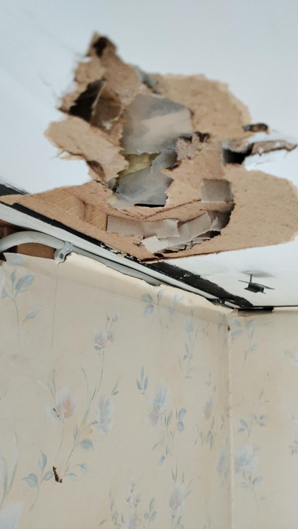

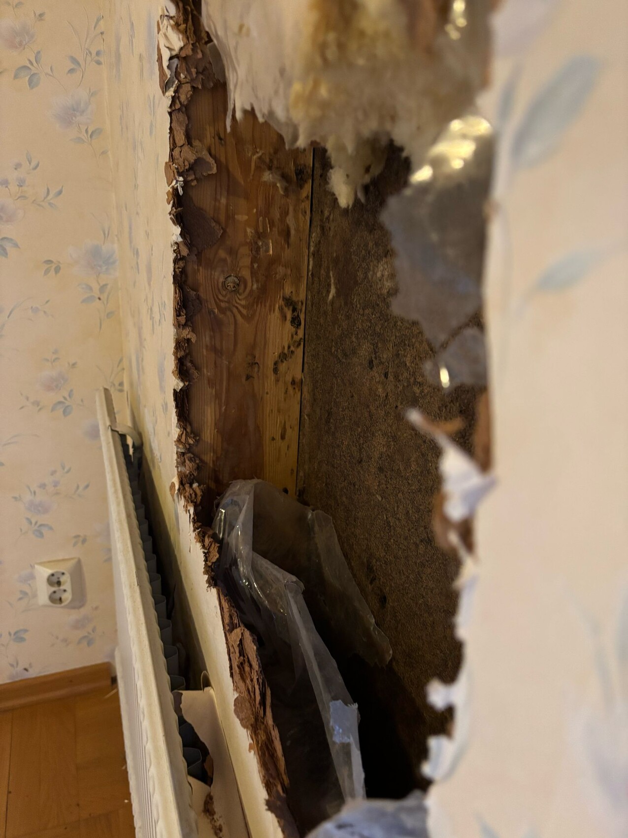

The main issue was an unpleasant odor. I was concerned that it might persist. After the previous owners moved out, the smell has decreased and it seems to come from a combination of two main sources: the bathroom drain and, especially, wall damage on the exterior wall caused by rodents. Since this has diminished, I would like to reconsider retaining the basic structure and roof.

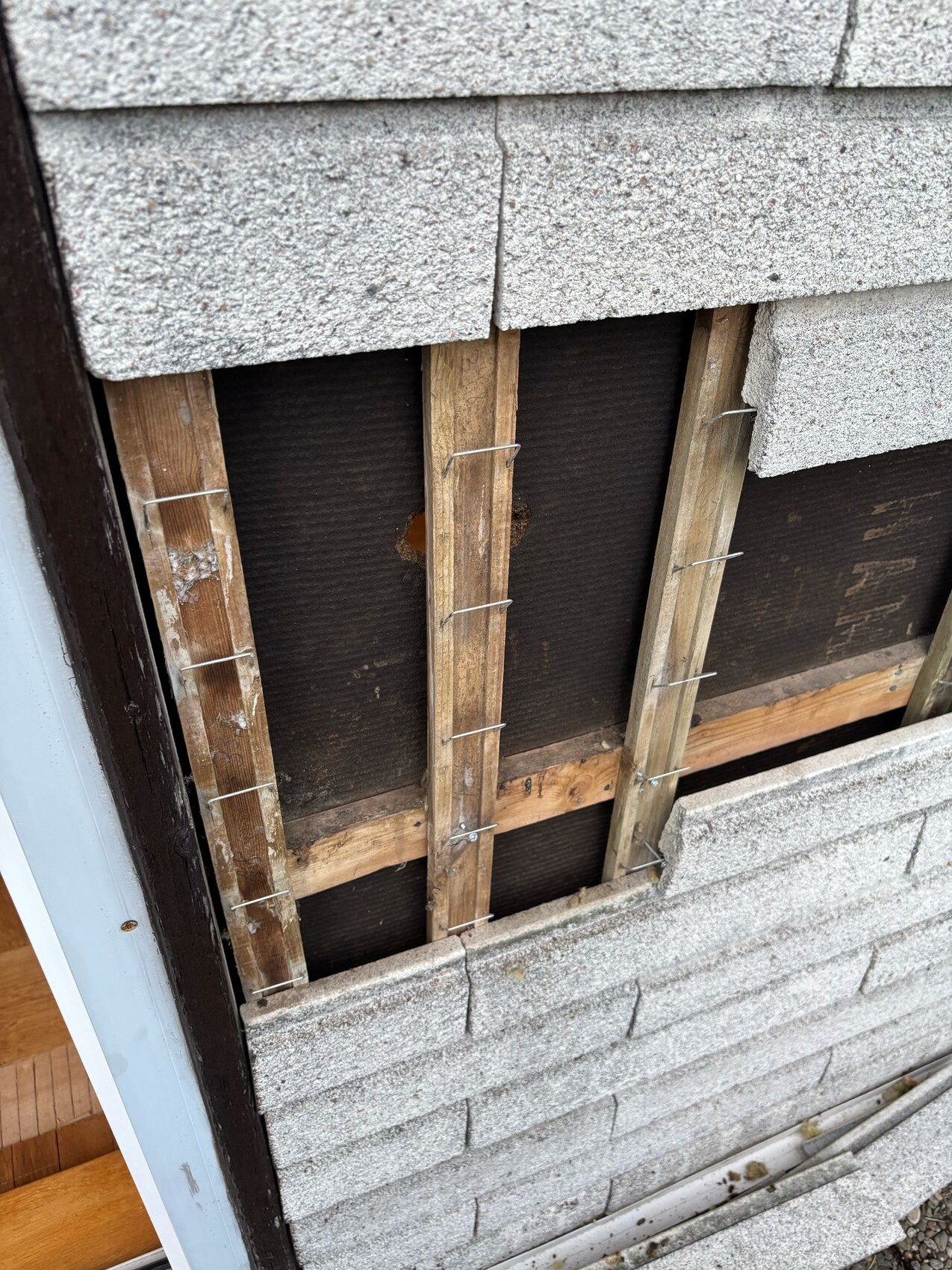

The wall structure consists of Coloroc blocks, bitumen-impregnated hardboard, mineral wool, and wood fiberboard. Basically, I see potential for creating a proper wall assembly through measures applied from the outside (wood fiberboard, plaster) and inside (insulated service cavity). Since the roof is unfinished, I also expect relatively straightforward improvements to the insulation can be made there.

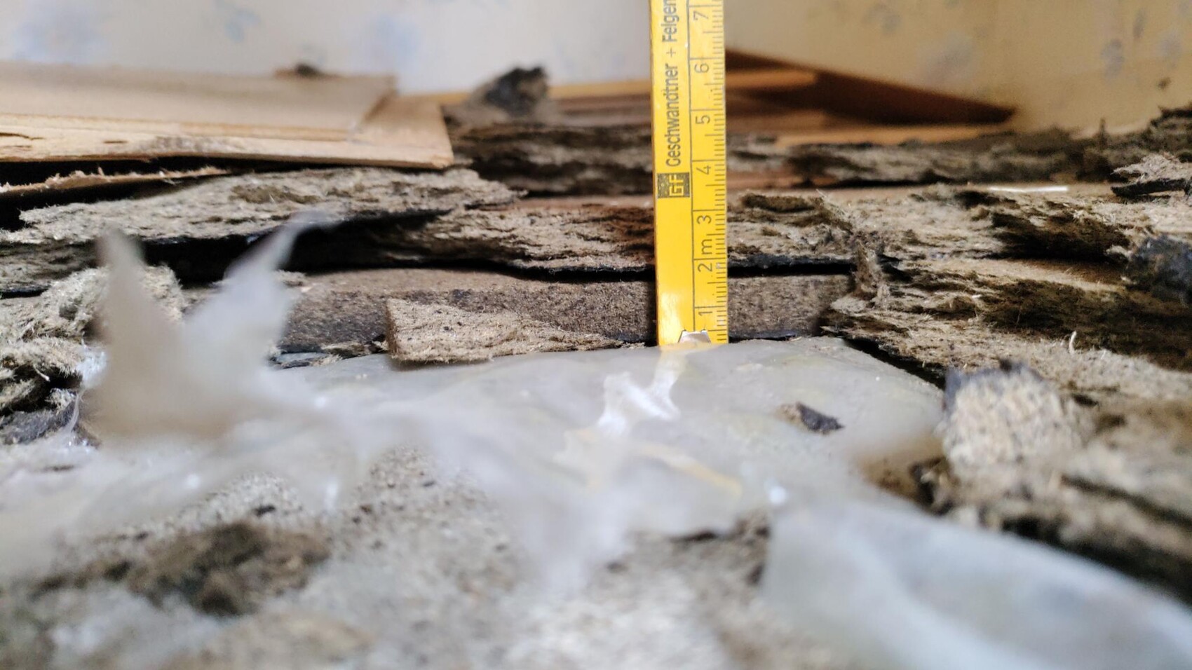

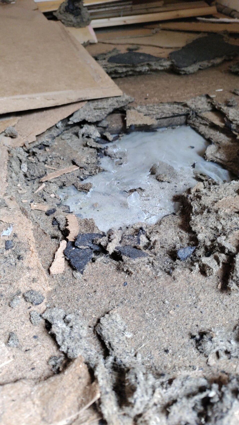

The floor assembly has already been mentioned here: bitumen-impregnated wood fiberboard, plywood panels, parquet flooring. I also notice some unevenness in the floor. The advantage is that it is fairly easy to remove. I am less enthusiastic about this compared to the wall structure. The raw ceiling height is 252cm (8 ft 3 in).
