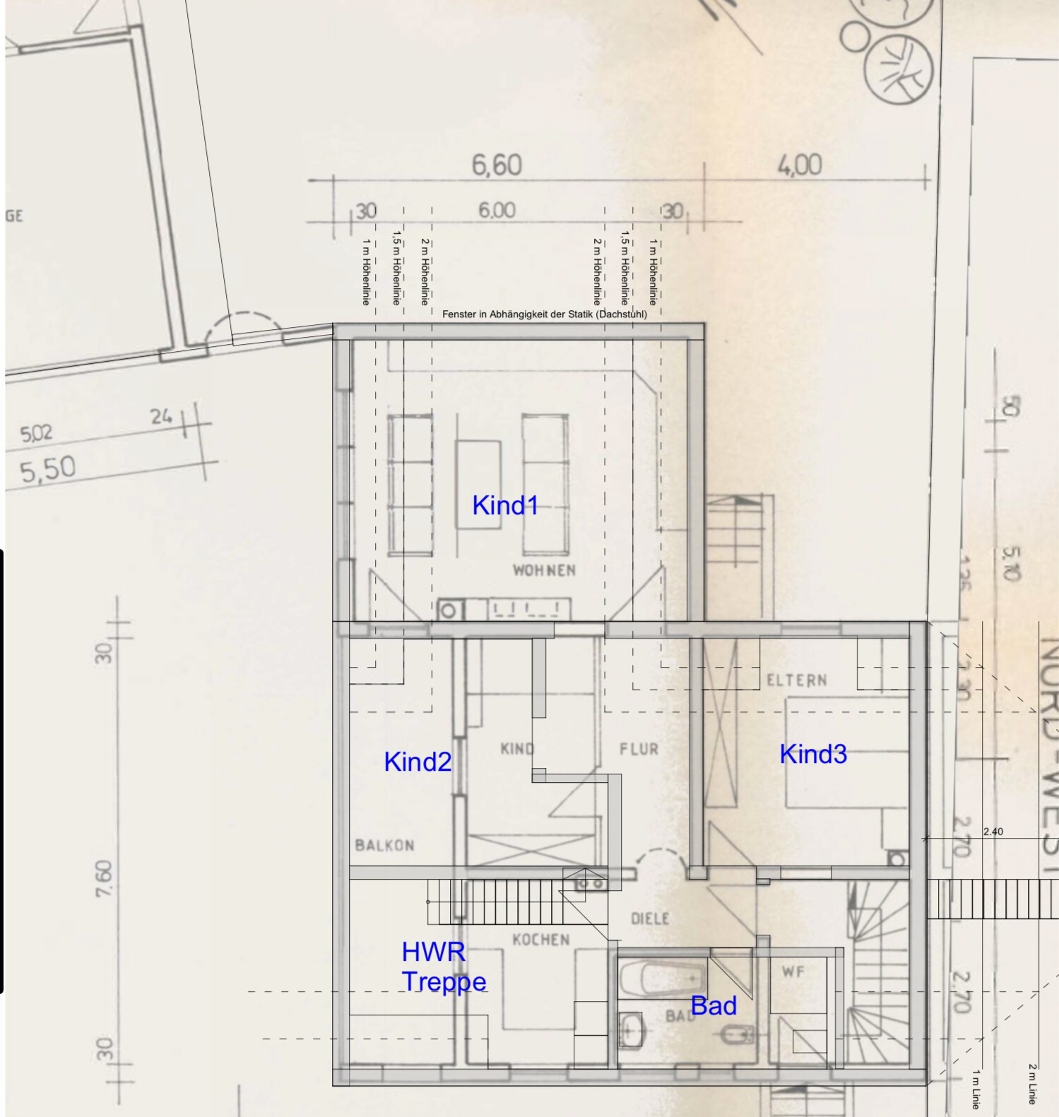

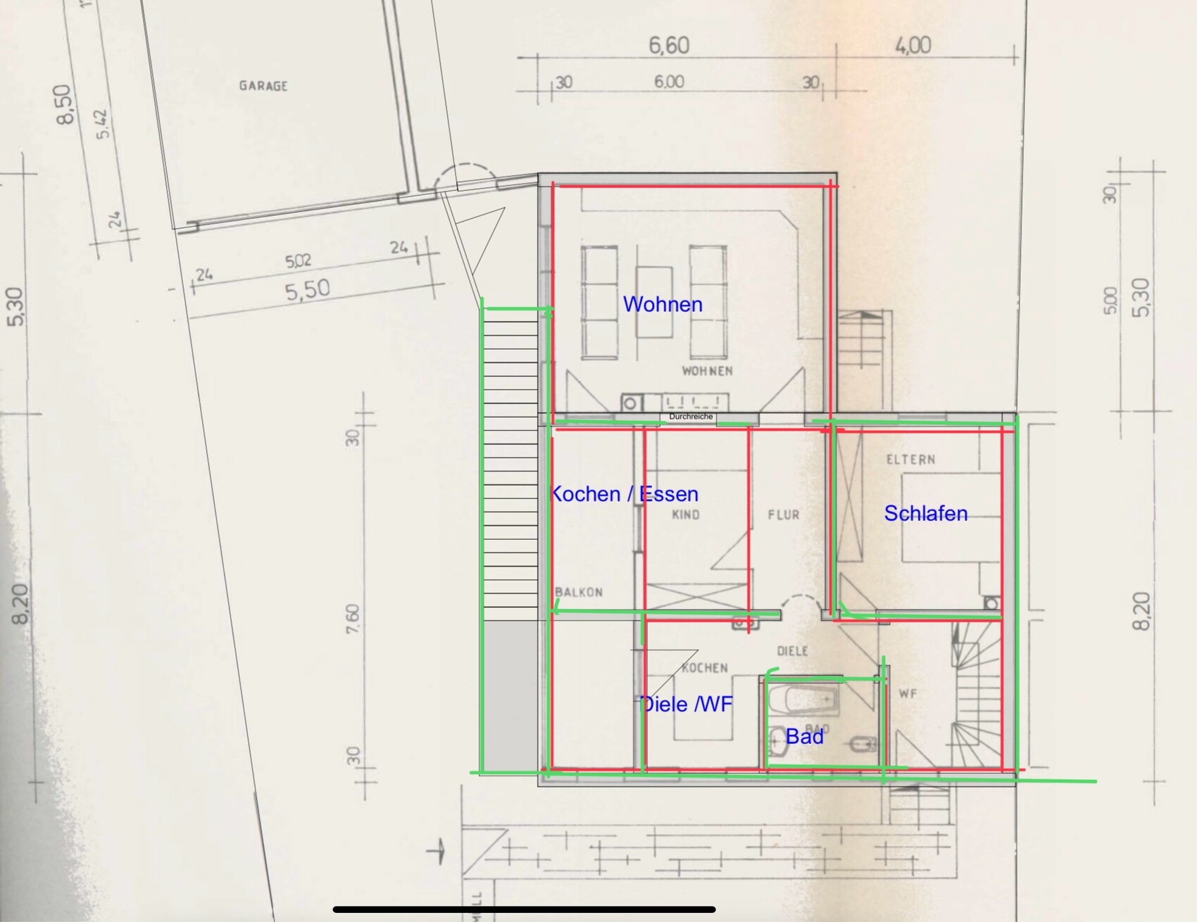

Here are the floor plans:
Upper floor:
Red shows the previous layout.
Green indicates the new one.
Floor plan of a house: living room, kitchen/dining, bedroom, bathroom, hallway; colored markings
Attic:
The white walls are existing.
The gray walls represent the new design.
Floor plan of a house: living room, kitchen, bathroom, corridor, staircase, balcony, 3 children's rooms, master bedroom
11ant26 Mar 2024 00:28
Ben_des schrieb:
Red shows the old layout. Green is the new one. [...] The white walls are existing. The gray ones represent the new plan.
This is too complicated. Overview diagrams are helpful, but not in this format.
As you have probably seen by now, it’s most practical to follow the usual “color coding”: existing structure in gray or black, new construction in red, demolition in yellow.

26 Mar 2024 00:46
I would probably access the ground floor apartment from the "balcony" side, meaning the front door would be there, and you keep the staircase.
1. It’s more cost-effective, and 2. I don’t think the straight outdoor stairway is practical for everyday use with three children.
Energy-efficient renovations can be doubly subsidized through the separate apartment on the ground floor. You should take advantage of that. Yes, building has become expensive, and so has renovation.
Where was north again?
I think it can work without complicated floor plan changes like here.
