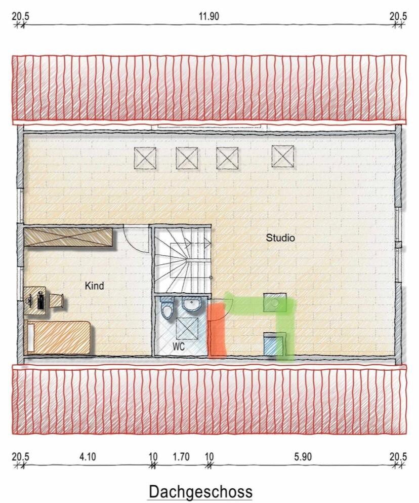

We have purchased a Swedish prefabricated house from the company AB-Elementhus. It features a solid masonry ground floor, on top of which the prefabricated house is built.
Initially, the plan was to completely demolish the house and replace it with a new cross-laminated timber (CLT) structure of the same size.
While studying the building documents and permits for the AB-Elementhus house, I was positively surprised by the construction.
The wall assembly is (inside to outside) 2cm (0.8 inches) cross-laminated timber, 16cm (6 inches) compressed wood chips, 2cm (0.8 inches) cross-laminated timber, and 0.2mm (0.008 inches) stove-lacquered aluminum.
The planned layout of the new building could be realized within the existing structure, so I am now considering renovating and upgrading instead of demolishing (insulation, interior, windows, etc.).
Does anyone have experience with these houses?

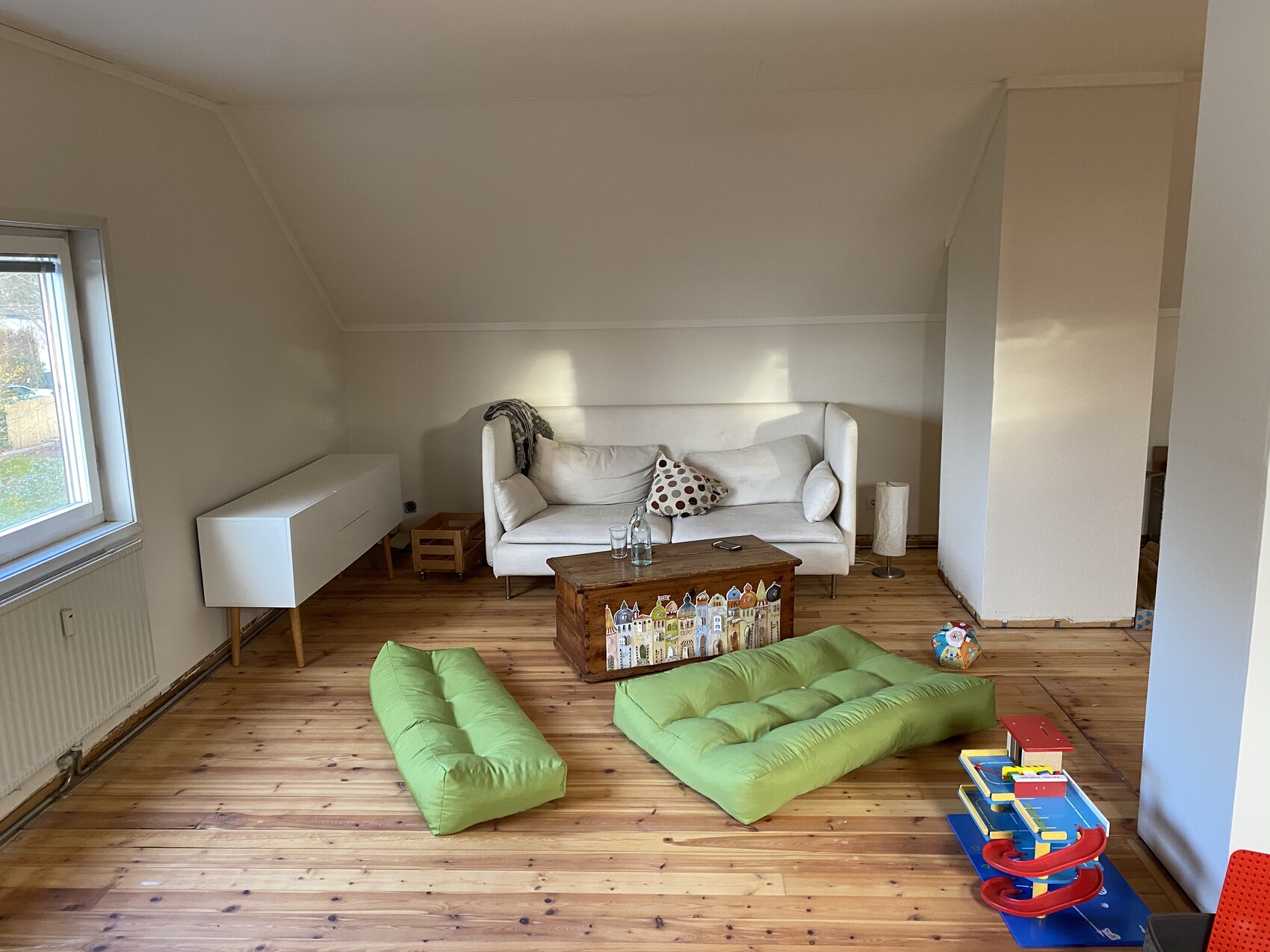

Our heating pipes are made of stainless steel. We plan to work on them during the warmer months. We will only connect a new radiator in the bathroom and keep the old system for now. It is intact, and the radiators look like new.
We want to sand the wooden ceiling on the ground floor, cover the walls with drywall, and replace the floor up to the concrete slab of the solid basement. Let’s see what we find there. Do you have any idea what was built into the floor? Between the ground floor and the upper floor ceiling, we found wood shavings when we had to open the bathroom floor upstairs to reroute the drainpipe and water lines. Now we also have a bathroom with a shower and toilet on the upper floor.
Does anyone have an exterior facade with concrete bricks? We are considering removing them. They are only hung on wire. Then we want to attach insulation panels and have it plastered. Mice found a way under the roof because the previous owners allowed bushes and vines to grow unchecked in several places. The branches/vines pried open the gable wall and pierced the mesh on the roof slopes. That made it easy for the rodents to enter the attic. However, we have already done a lot of cleaning and made the knee wall and roof uncomfortable for the rodents.
