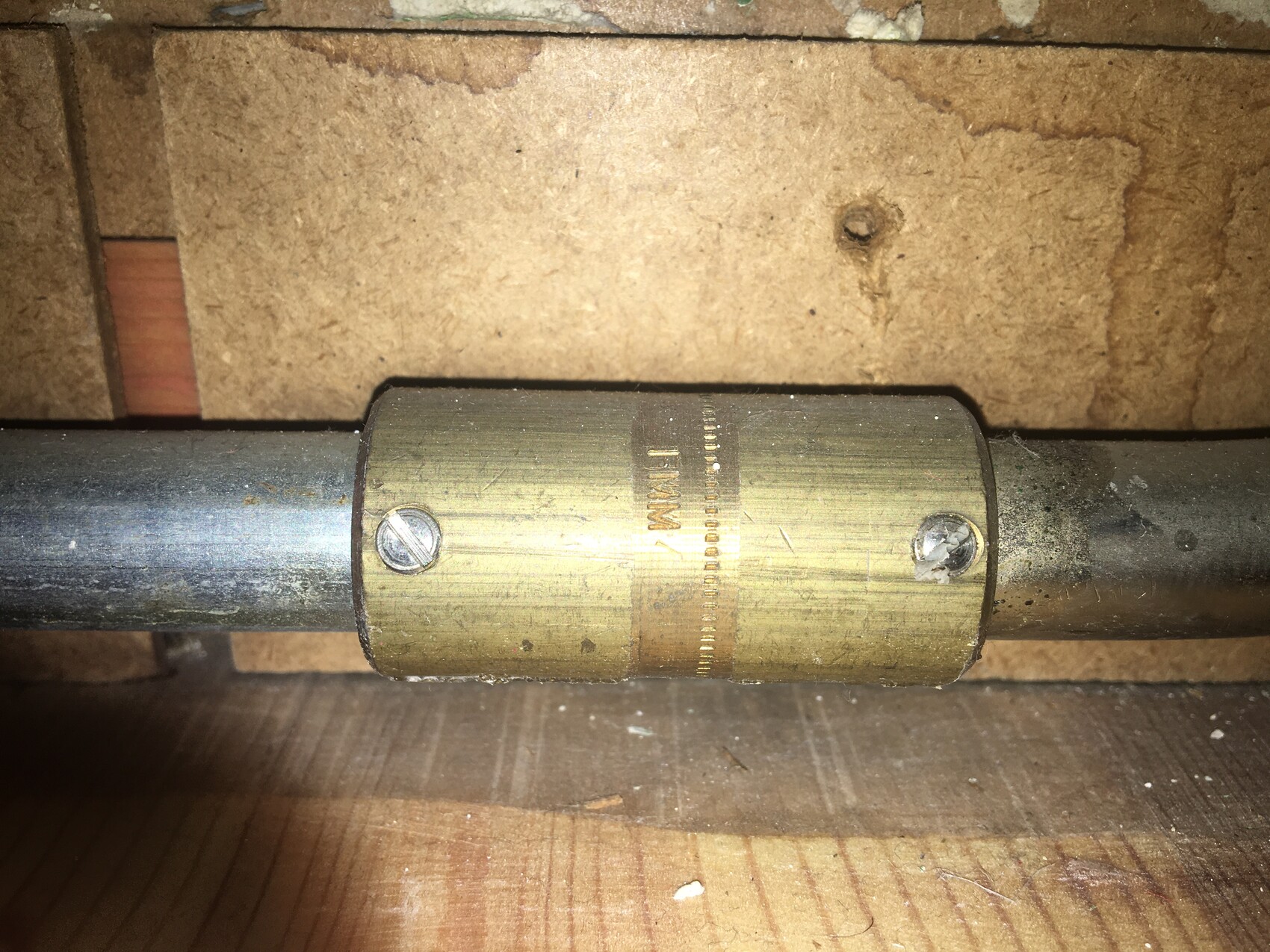

Thank you for your reply! I was really happy to hear from you 🙂
How did you handle the couplings? Are they screwed? Were you able to install different pipes when you made changes to the bathroom on the ground floor?
I’m worried that we won’t be able to reconnect the single-pipe system if I remove the radiators in the bathroom.
