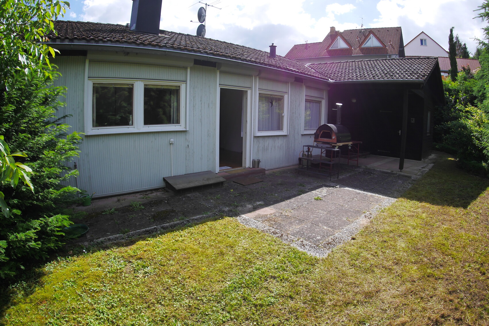

We have purchased a Swedish prefabricated house from the company AB-Elementhus. It features a solid masonry ground floor, on top of which the prefabricated house is built.
Initially, the plan was to completely demolish the house and replace it with a new cross-laminated timber (CLT) structure of the same size.
While studying the building documents and permits for the AB-Elementhus house, I was positively surprised by the construction.
The wall assembly is (inside to outside) 2cm (0.8 inches) cross-laminated timber, 16cm (6 inches) compressed wood chips, 2cm (0.8 inches) cross-laminated timber, and 0.2mm (0.008 inches) stove-lacquered aluminum.
The planned layout of the new building could be realized within the existing structure, so I am now considering renovating and upgrading instead of demolishing (insulation, interior, windows, etc.).

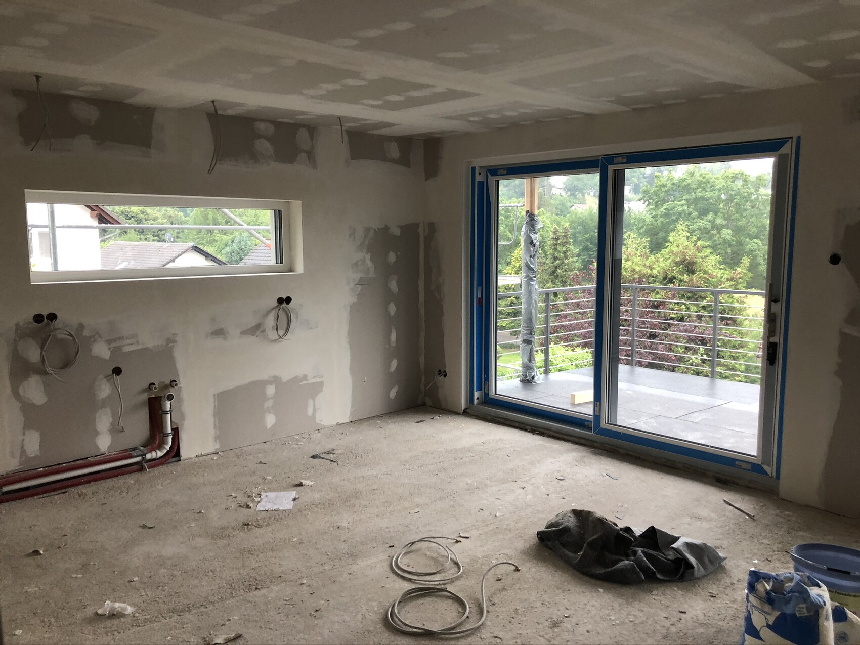

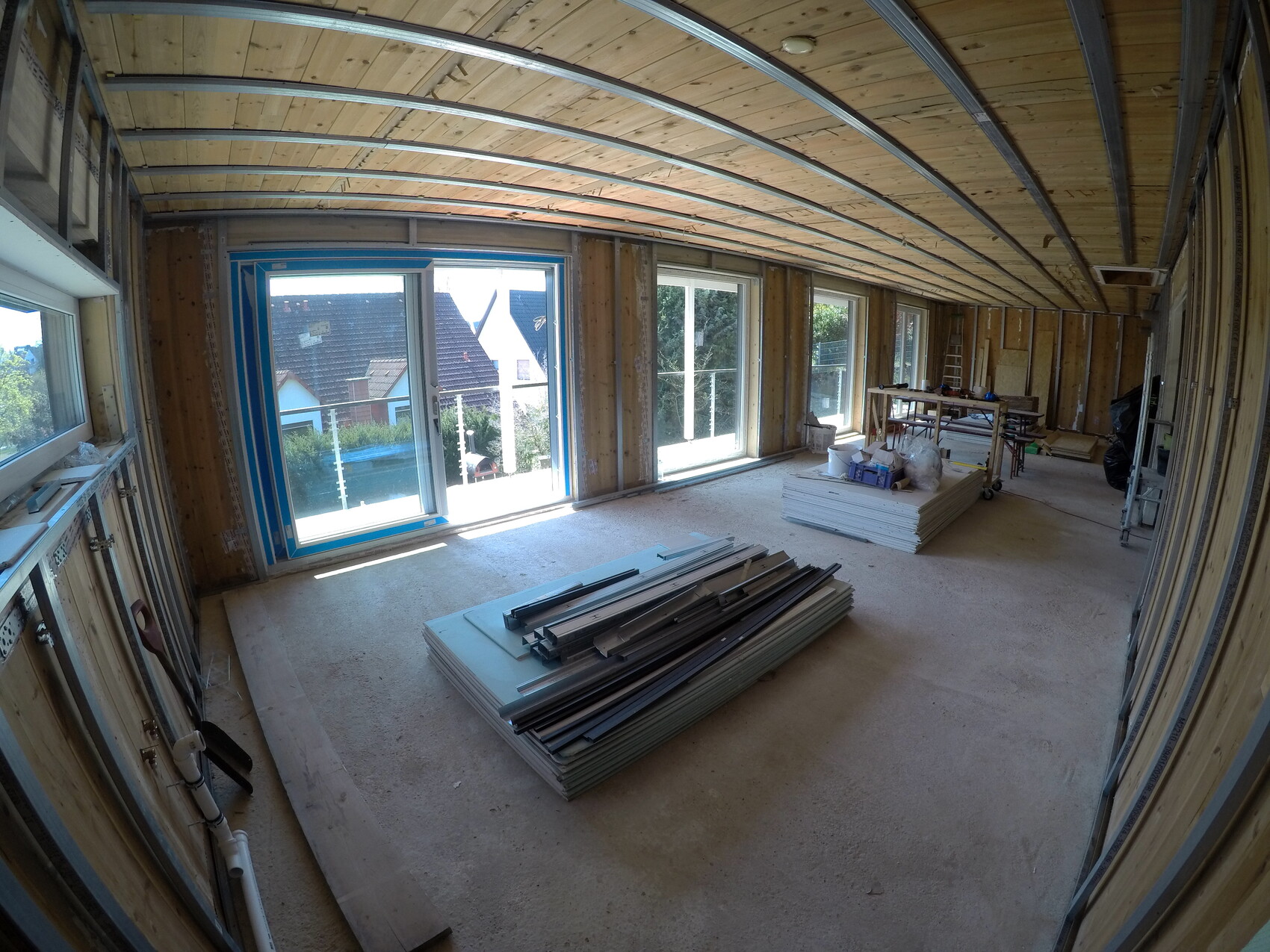

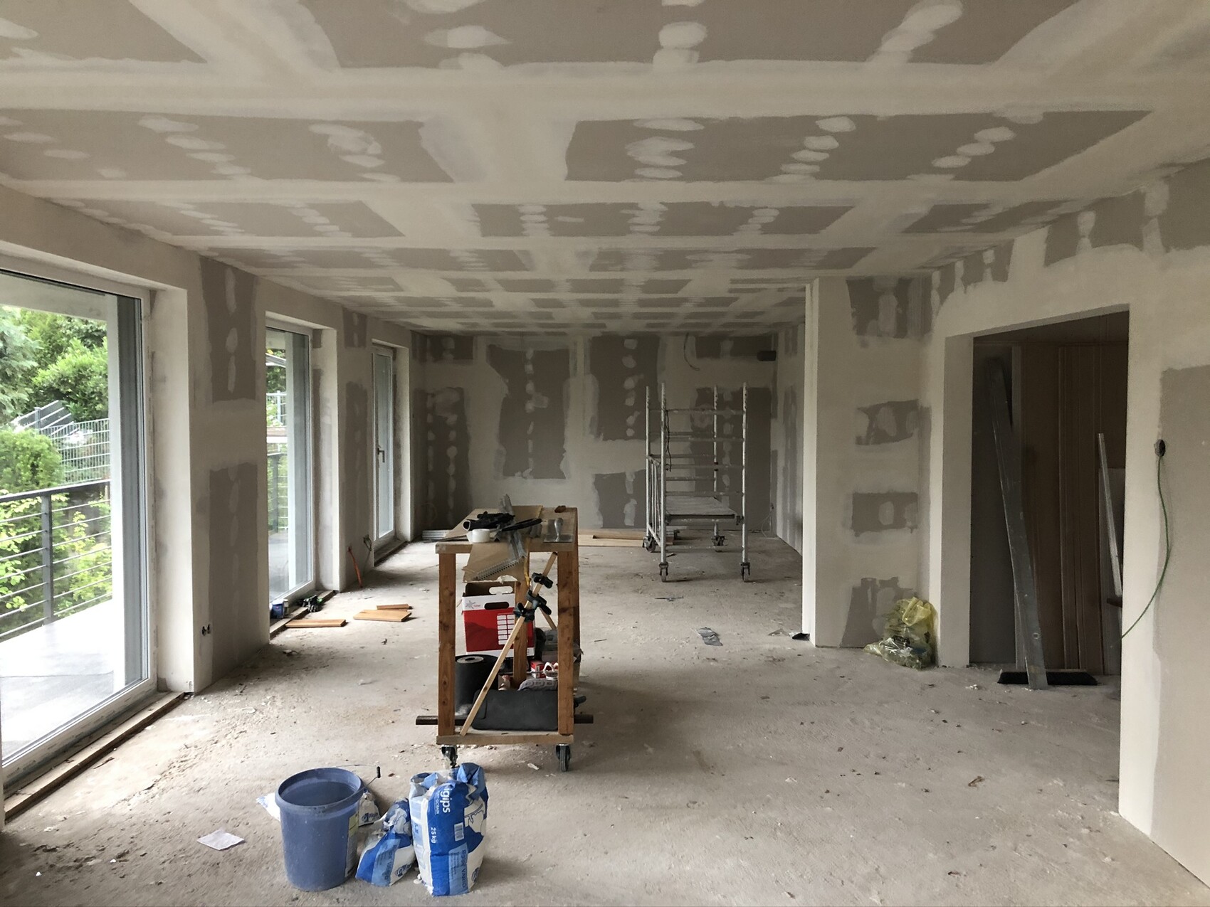

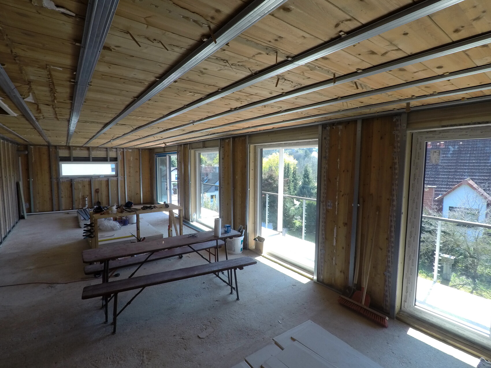

We decided to leave the structure as it is. I actually find the design very good, and it allows us to create wonderful rooms. We are replacing all the windows, some with the same size and others full-height.
As you can see in my previous post, we installed lintels that were calculated by our structural engineer, whom I would definitely consult again. This now allows us to install full-height windows or lift-and-slide doors.
Installing new windows into the walls is not particularly complicated, but you need to be careful not to have all the wood chips fall inside. This can be avoided by using a pre-installed protective foil.
