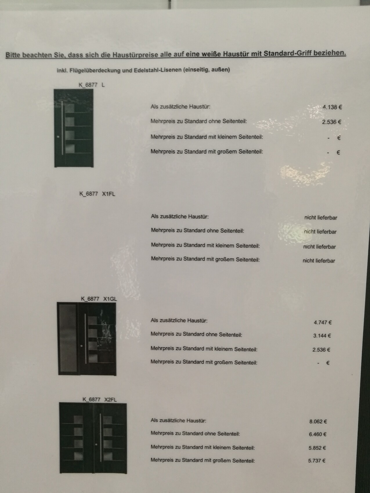

Point 5:
Price reduction for removing the standard front door: -1,315.00 €
But if I want an additional door, it costs me over 4,000 €. How is that possible?
See the attached picture.
Maybe they want to remove it because the door is not good enough — no RC2 rating, no windows with privacy glass, etc.
Here is the description:
Your contract includes a white plastic front door from the standard range with a small side panel.
The side panel has clear glass; satin glass can of course be added separately.
The front door has basic security, which should correspond approximately to WK 1, but a higher standard is possible and can be arranged.
According to the contract, a handle about 30 cm (12 inches) long is agreed.

I can’t comment on everything, but I can share some thoughts on a few points.
Regarding the Rotex: Of course, many things can be postponed. He didn’t tell you anything wrong. He just didn’t mention that additional costs might occur. From my perspective, your only option is to negotiate with the seller to see if they can work out any compromises.
Regarding the door: The standard option is always very basic. After all, the lower house price has to come from somewhere. Any extras are heavily marked up by the general contractor. If you ask for a credit, the amount always looks quite modest. You also don’t know their purchasing conditions. Maybe they really get the door that cheaply. The high surcharge usually comes from installation costs (labor, adhesive, screws, etc.) and, of course, a small bonus the general contractor adds to make a profit.

Point 3:
Here I can even provide some comparison figures.
For our prefabricated house, the standard price included an anthracite-colored aluminum front door without side panels. We wanted two side panels, each 50cm (20 inches) wide, and colored, which would have added €2,920 to the price.
If you compare this surcharge to our current door, which we purchased from a door and window supplier for just under €5,500, it’s obviously overpriced. Our current door with side panels also includes features like a fingerprint lock on the door handle, a 73cm (29 inch) door handle, a door viewer, RC2 security rating, electromechanical lock, and more.

HilfeHilfe29 Nov 2016 08:49For front doors, "white goods" refers to mass-produced items and are generally cheaper than colored or slightly custom-designed ones.
I can say the same... it doesn't get cheaper... and if the construction budget is already tight from the start, any special requests will only increase costs significantly.
Especially with doors and windows, any changes will not make things cheaper.
