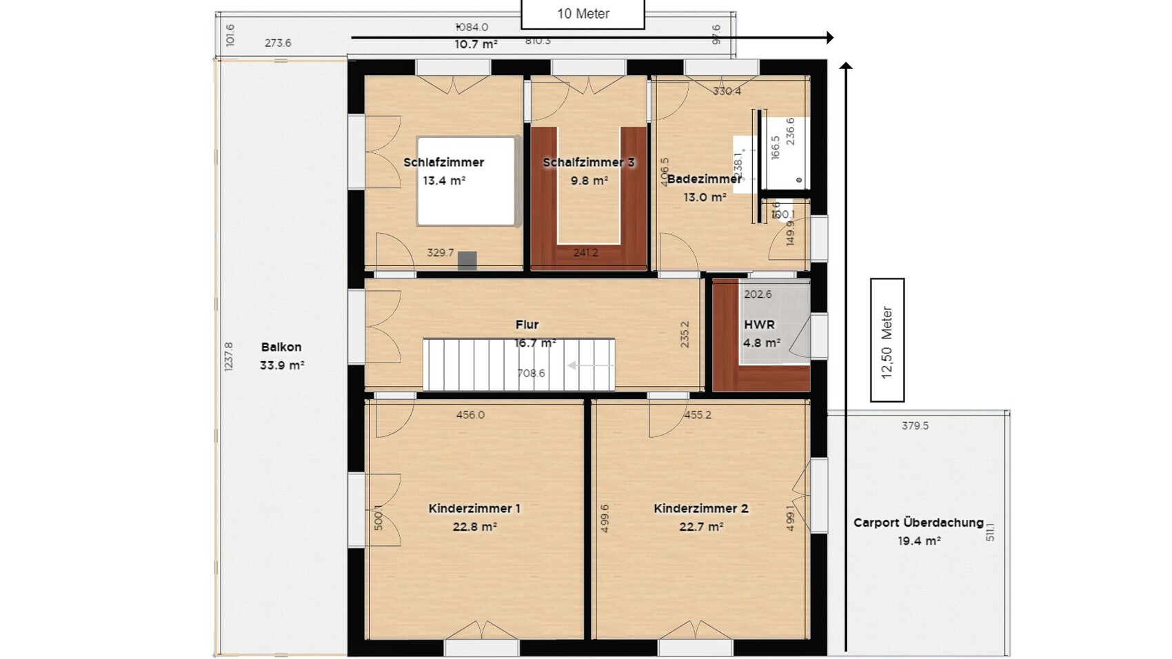

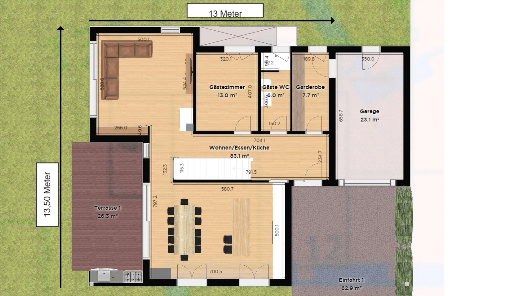

below you will find our plan. We are looking forward to your feedback.
Plot size: 900 m² (9700 sq ft)
Slope: No
Site coverage ratio: 0.3 or max. 180 m² (1940 sq ft)
Floor area ratio: None
Building setback (building line and boundary): 5 meters (16 ft) each from the street and neighbors
Number of parking spaces: No requirement
Number of floors: 2
Roof type: Gable roof or hipped roof
Maximum heights/limits: Ridge height (TH): 7.5 m (25 ft), Eaves height (OK): 11.50 m (38 ft)
Maximum driveway width: 5 meters (16 ft)
Homeowner Requirements
Style, roof shape, building type: Gable roof
Basement, floors: Basement and 2 full floors
Number and age of occupants: 2 adults, 2 children: 34, 33, 8, 6
Office, family use or home office?: Office will also be used as a guest room
Number of overnight guests per year: 12
Open or closed architecture: Semi-open
Traditional or modern construction: Modern
Open kitchen, kitchen island: Kitchen island
Number of dining seats: 10
Fireplace: Yes
Built-in sound system: No
Balcony, roof terrace: Balcony
Garage, carport: Garage and carport
Additional wishes/special features/daily routine, including reasons why certain elements are wanted or not: A children’s bathroom on the upper floor is not necessarily desired. We prefer a utility room on the upper floor because we want to do laundry there.
Designed by: DIY
What do you especially like? Why?: Own wardrobe; kitchen and dining area (we cook a lot) are not visible from the living room sightline.
What do you not like? Why?: The terrace roof with 2.80 m (9.2 ft) is actually too short.
Budget limit for the house, including features: 750K
Preferred heating system: Geothermal heat
Why was the design created this way?
It is well adapted to the plot conditions (corner lot) and our family’s needs.
What do you think are its biggest strengths or weaknesses?
We think it fits well with our needs (spacious living room and large kitchen, plus a separate wardrobe). Perhaps the master bedroom is not optimal because it might be too tight for two bedside tables, partly due to the chimney.
Do you think the floor plan will work well in practice? What improvements would you suggest?
We planned a sliding door to the kitchen but are unsure whether to include a door at all, and if so, what kind. The same question applies to the wardrobe. Would you adjust the window arrangement in the living room?

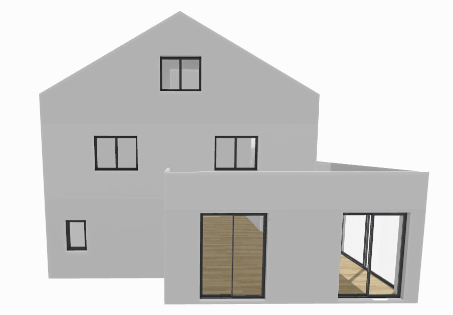

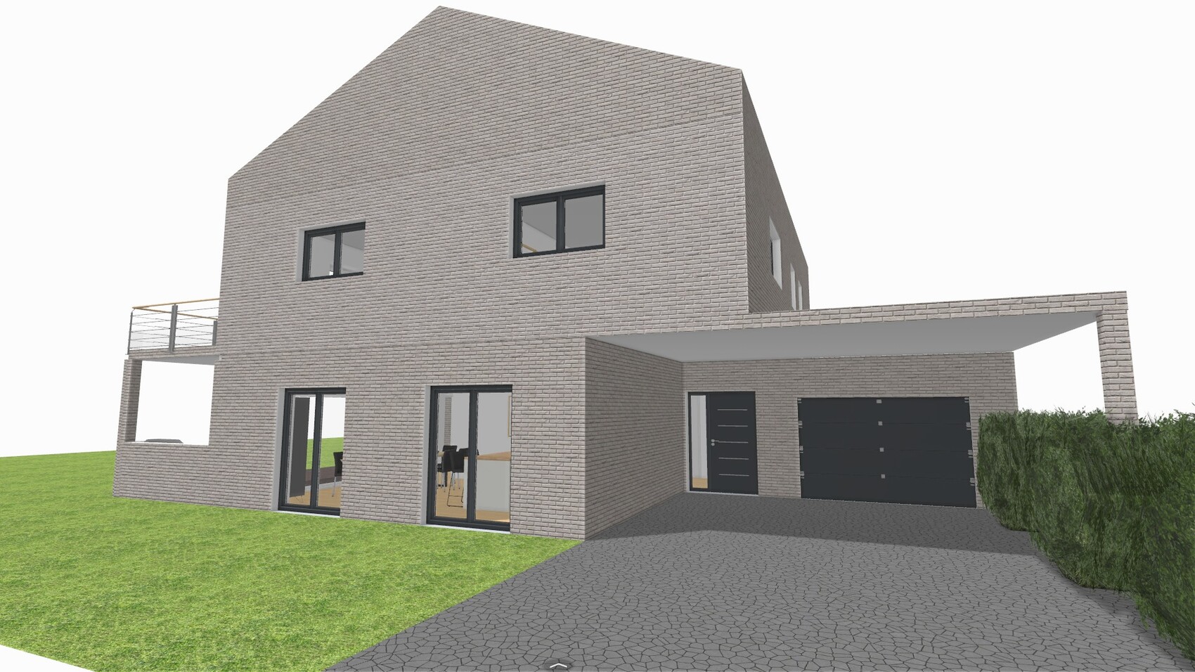

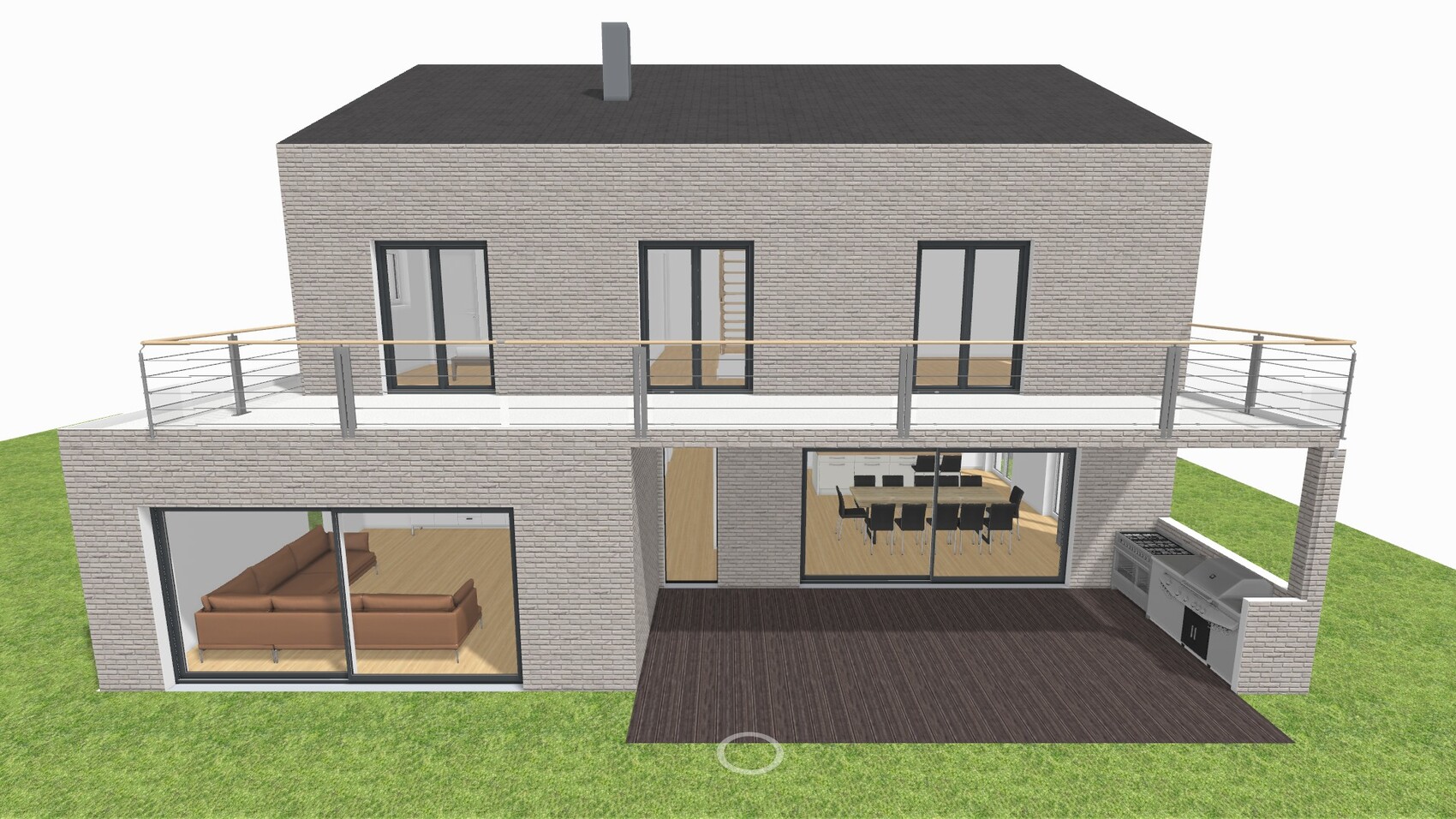

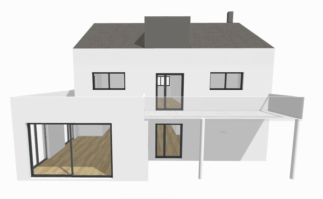

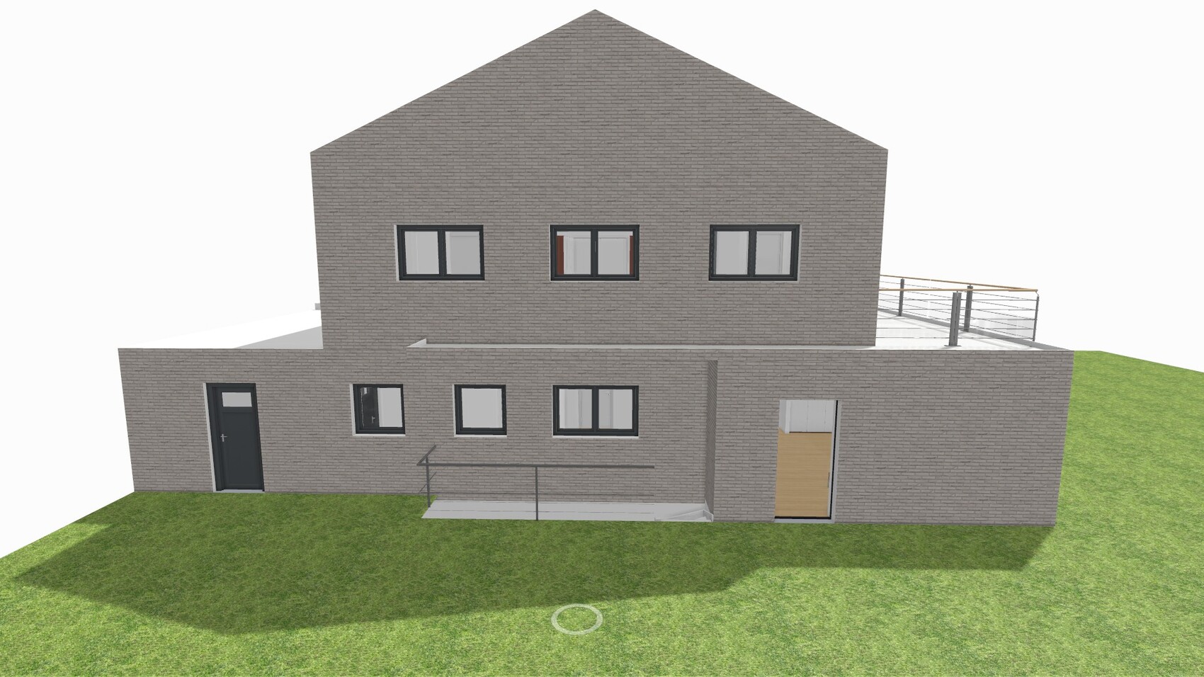

Stein20237 Apr 2023 18:26Happy Good Friday everyone,
we decided to move the fireplace to the other side, so the chimney will exit on the gable side. Additionally, we have adjusted the windows again (among other changes, the corner windows are gone):
We also really like the exterior of the house we used as the basis for the floor plan:

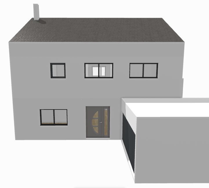

Our views would be:
North

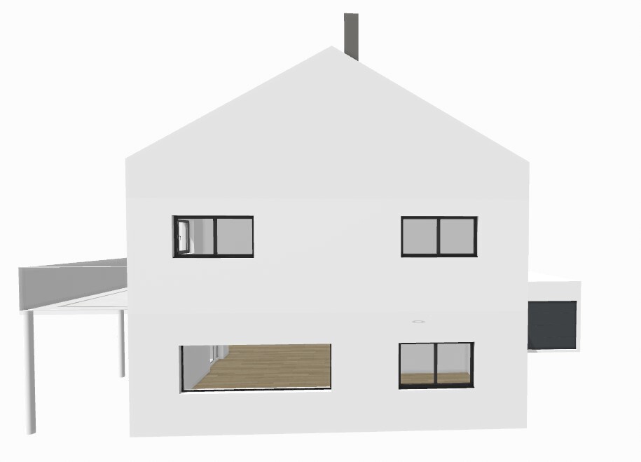

West: We need a dormer because otherwise you’ll hit your head on the roof when climbing the stairs due to their position. The attic is intended as a future expansion area. Unfortunately, I couldn’t add dormer windows in the software.
South: We decided to skip a window in the dressing room
East
We look forward to your feedback. Maybe you have further suggestions for optimization.

Our views would be:
North

Stein2023 schrieb:
We’ll move the chimney to the other side.Very good. Stein2023 schrieb:
South side: We decided to skip a window in the dressing room.The south side looks like a face with a missing tooth 🙁 Why do you talk about a panoramic window if you are planning a window strip? The living room could really use a floor-to-ceiling window. Otherwise, you might as well plan the room in the basement. The flat is too valuable for that.
Stein2023 schrieb:
We need a dormer because otherwise, when walking up to the roof, you hit your head due to the stair position.Then the house is poorly designed if you have to add a dormer on the roof just to make the staircase usable. I’m out for now.
Stein20237 Apr 2023 23:36Haha, "gap between the teeth" fits quite well! 😀 Unfortunately, we can’t come up with an alternative.
It’s a pity, your comments have been constructive so far. To label the entire house as a design failure just because of a dormer... I don’t know. Yes, we never really intended to build a dormer in the first place! However, we have learned that planning is as complex as a long equation dependent on many variables. In our experience, you can’t just insert every desired variable into the equation. The result is what counts in the end. Here and there, you have to make compromises. That’s why I find the shift from “awesome ground floor” + upper floor to “complete failure” quite extreme. But well, that’s your opinion. Still, thanks for the feedback, which we have appreciated so far.
Stein2023 schrieb:
The house we used as the basis for the floor plan also appeals to us a lot in terms of its exterior: Which model is it?
Stein2023 schrieb:
We actually never intended to build a dormer! If you mean that gable dormer, which oddly only appears in the eaves-side view: I think you are planning something that hasn’t fully settled in your spatial understanding yet. Please show a floor plan of the attic (especially where the potential space for expansion is supposed to be). Has the basement been removed from the plans?
Please show a floor plan of the attic (especially where the expansion space is supposed to be).The "loft" has a large knee wall in the design. Two floors are being discussed here, although four floors are planned.Similar topics
