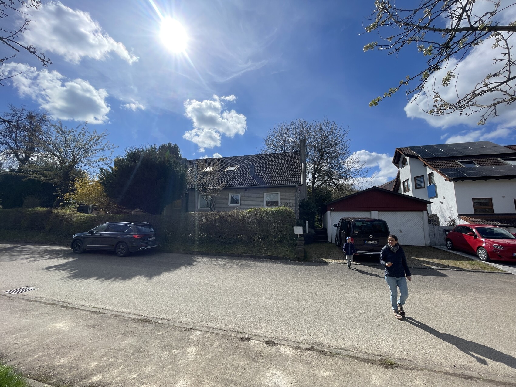

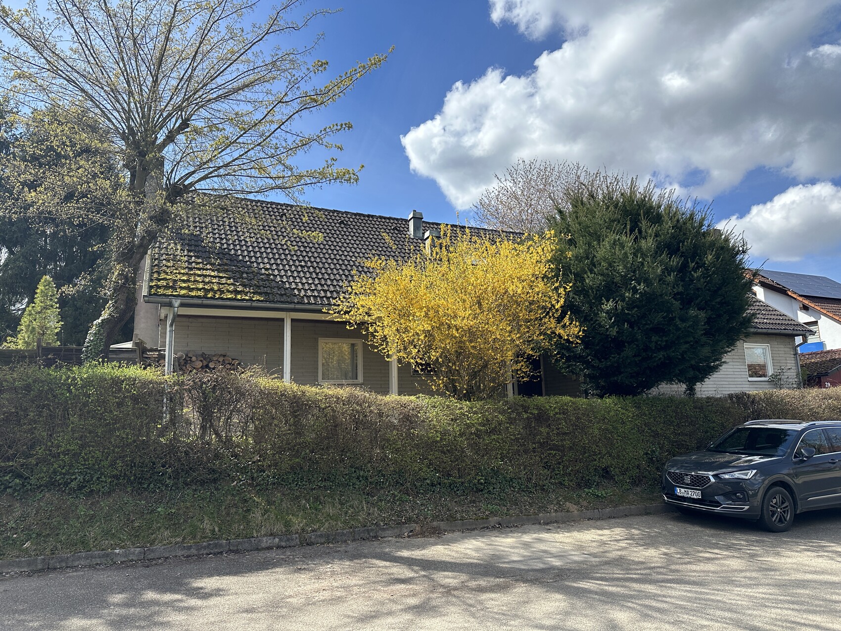

Benutzer2119 Apr 2024 21:02Hello everyone,
we will soon be visiting a house by SEH. So far, I haven’t been able to find out what type it is.
On Immoscout24, the listing number is 149947752; does anyone have any idea?
Unfortunately, there has been no information from the previous owner yet. I hope there is still some reasonably usable documentation from the past 48 years.

hard to say; I only have a narrow catalog available, and none of the houses listed there match this one. Apart from the location of the main entrance, I would have guessed a Borgholm just based on the floor plan and the view from the garden. But the previous owner has customized the interior layout quite a bit. For example, in our Borgholm, the main entrance is located along the hallway branching off to the right (in your plan) on the long side of the house; the terrace is on a gable end, and the living room is rotated 90 degrees compared to your plan (long side parallel to the gable wall). However, this may not mean much; either the previous owner made changes during a renovation or already altered the floor plan during the design phase. You could ask about this (if the agent allows you to speak directly with the seller).
The windows have definitely been replaced; these are no longer the original SEH windows (double windows, single-glazed, wooden frames). I also suspect the ceiling was later covered with panels. The house has a colored Coloroc curtain facade, as well as the typical one-pipe heating system where all radiators on each floor are connected in series. The return flow of the first radiator is the supply to the second, and so on. The attic offers a large potential for development; under the drywall panels on the floor, the original wooden ceiling is likely concealed.
A Coloroc element can be easily removed (just slide it upward and pull it out), then you can see what the wall behind it looks like. Is it dry? Or does it show signs of water or moisture? That would already give an indication of the condition of the building structure. The load-bearing beams are, however, hidden behind the outer cladding (probably aluminum sheeting).
