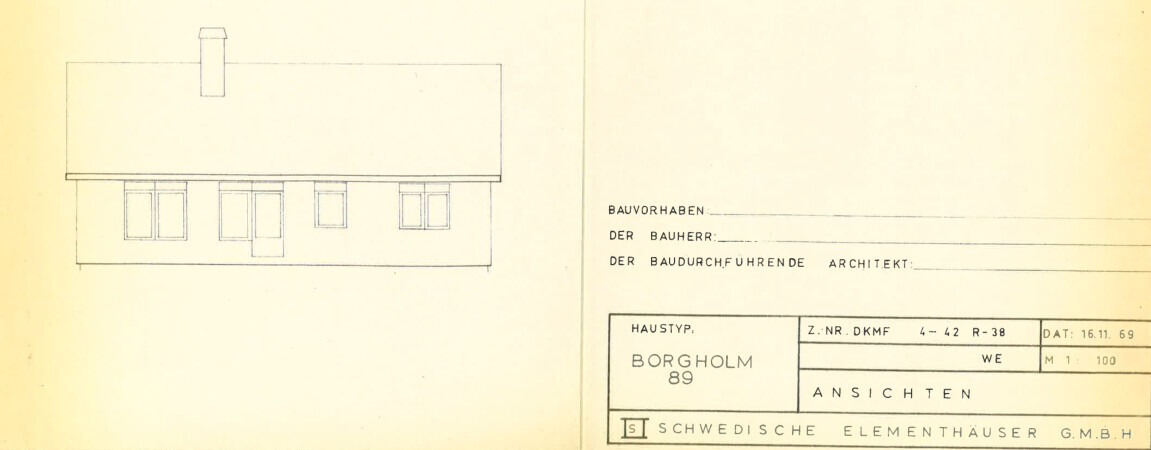

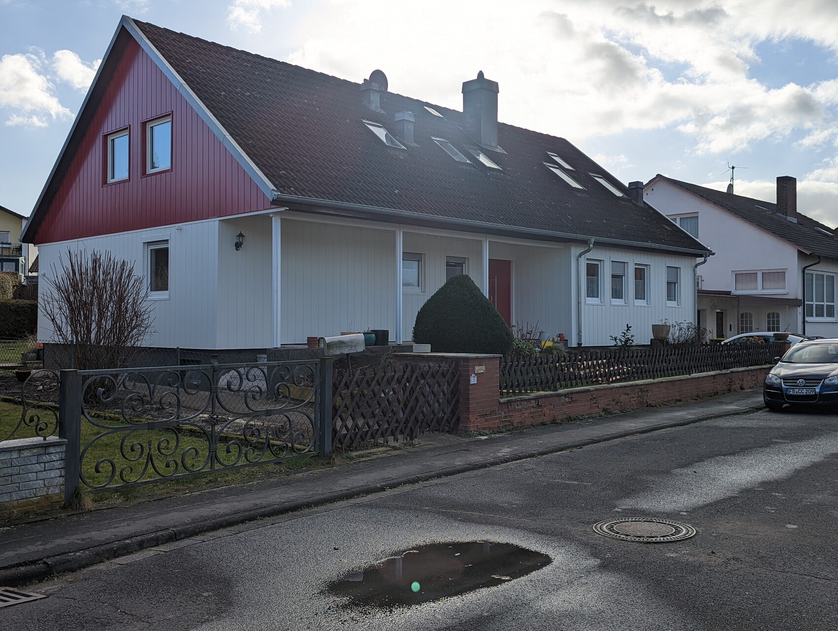

@Luponell: Our house is actually a Borgholm model by SEH; I’m attaching a section of a plan and a photo. I have a whole folder full of documents, but I don’t have access to it at the moment. The previous owner was a representative of SEH for the Cologne/Bonn area. In our village, SEH bought plots of land, which were then sold to prospective buyers or builders (similar to how prefab house manufacturers do nowadays). There are quite a few SEH houses around here. Since we just bought the house, we don’t have many contacts yet.
