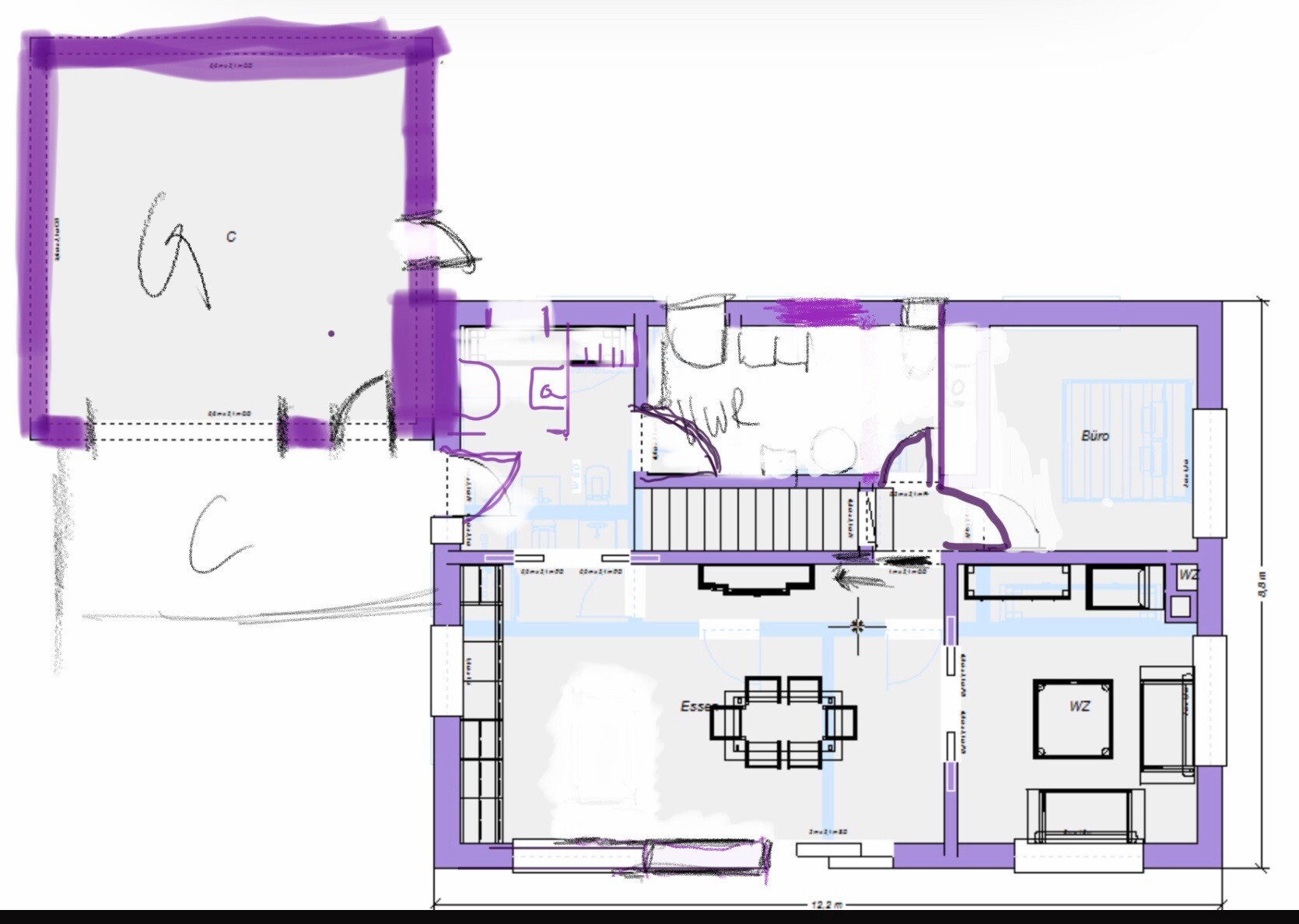

phil123455 Jun 2020 15:53The passage from the utility room to the garage is removed. Instead, we came up with the following idea on the iPad, without changing the stairs or upper floor.
Explanation: small guest bathroom (now located directly below both upper floor bathrooms) – the hallway had to be sacrificed, as guests don’t spend much time there and are directed to the south-facing area. The large utility room creates space for the kids’ dressing area, which was previously necessary in the hallway. Additionally, the extra door provides an escape route for dad in case HSV doesn’t get promoted again and he needs to go straight to bed without passing through the living and dining area.

phil123455 Jun 2020 17:00Actually, no door has been added to the utility room area. Only the small guest bathroom has been separated at the entrance. However, this could be addressed by using sliding doors.
