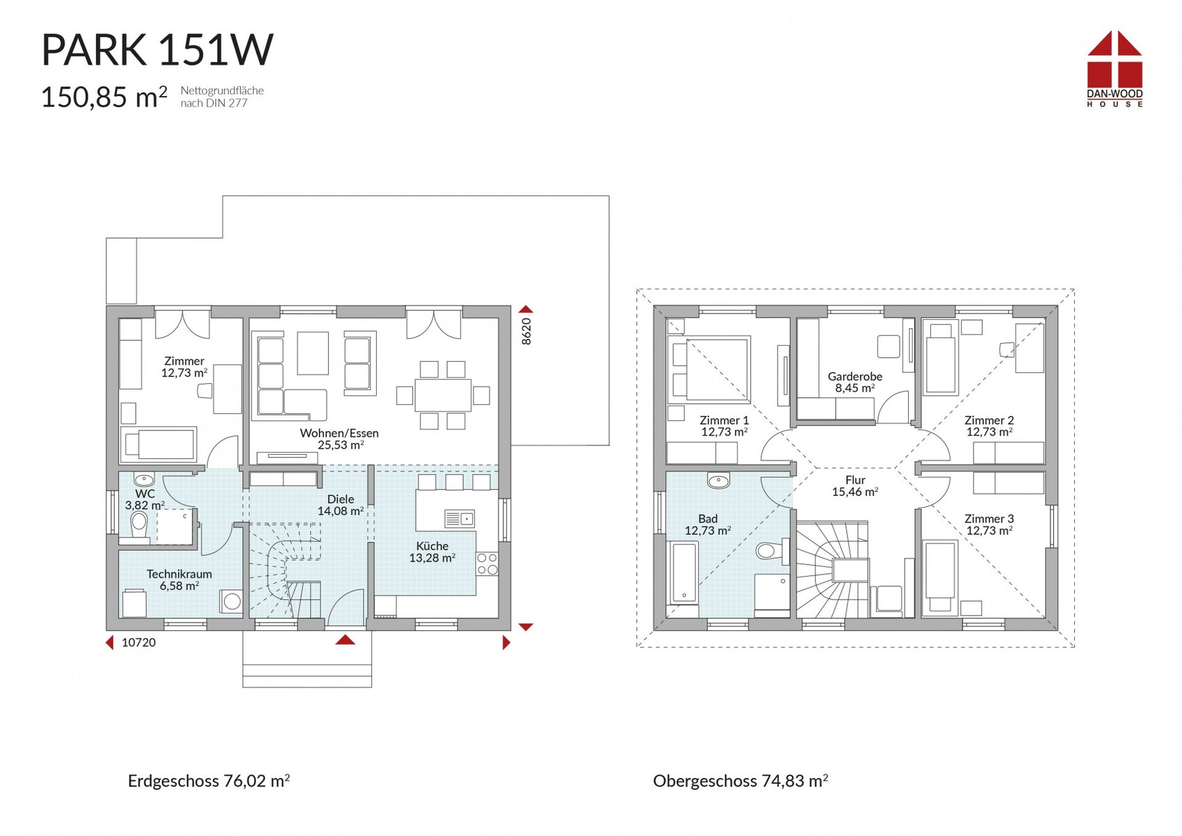

Or the Park 151W as a standard model? Base price €191,100.
South on the left side of the plan could work. The rooms in Danwood houses are functional but compact – that’s something to keep in mind. Laundry space, however, might be problematic here.
If you swap the kitchen and living area, you could add a children’s bathroom upstairs instead of the wardrobe.
