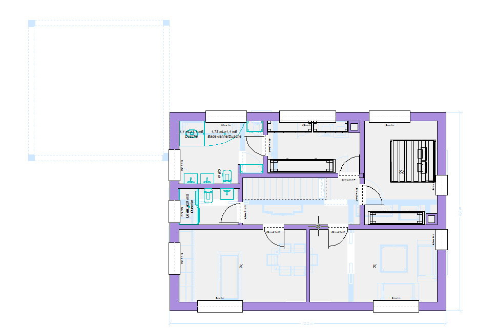

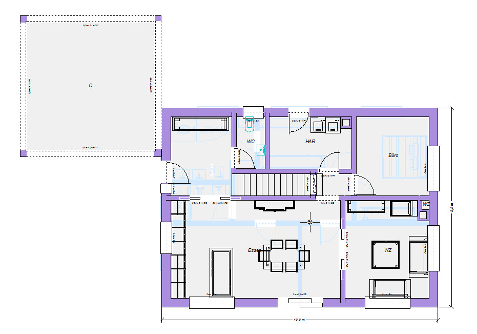

Here is another proposal with one office. However, daylight spotlights are needed on the upper floor.
(Carport only indicated.)
All bay windows removed and rooms accommodated inside the house. Width increased, while depth reduced. Children’s rooms are on the south side – although one shares a wall with the bedroom – possibly make the wall thicker. Access for kids to the master bathroom plus laundry chute.
