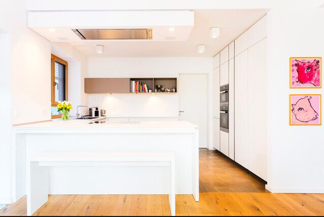

Here is an impression of the kitchen; this is roughly how the layout would look. I find it suitable.

haydee
26 Oct 2018 21:55
Enjoy carrying a heavy, hot roasting pan from the oven to the countertop.
The kitchen looks good but is impractical. The distance between the two kitchen worklines is too large.
moejoe89
26 Oct 2018 22:56
The countertop near the cooktop still offers you some space and is close to the oven.
haydee
26 Oct 2018 23:07
You’re planning a new house, so why not have a practical and attractive kitchen?
This kitchen is just an enlarged version.
A few pages ago, a user showed a kitchen that is practical, modern, and extravagant—something that really only works if you plan for an XXL size.
With the space you have, many options are possible that wouldn’t work with 160 sq m (1,722 sq ft). Make the most of it.
