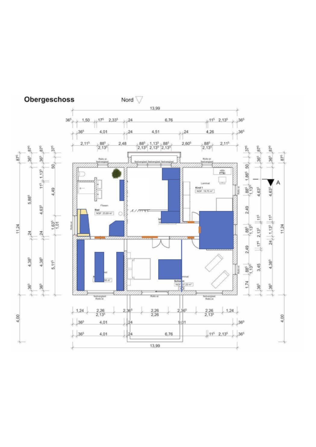

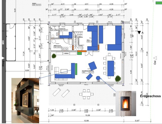

I have taken your suggestions into account. Attached are the revised ground floor and upper floor plans.
- Larger children’s bathroom
- Second children’s bedroom included immediately
- Landing staircase
- Entrance to utility room repositioned (orange line)
- A door could also be added under the stairs in the kitchen (orange line)
- A central fireplace-style room should be included
- A room divider should partially separate the living room (example image included)
Thank you in advance for your feedback.
- Landing staircase

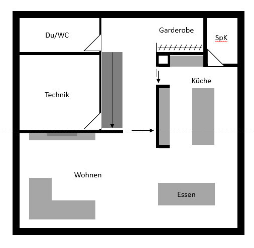

Here is a proposal for the ground floor with dimensions of 12 x 12m (39 x 39 ft):
- Spacious entrance with a hallway 1.8m (5 ft 11 in) wide leading to the living area
- Large cloakroom directly in the entrance area
- Straight staircase to the upper floor (eye-catcher?!)
- Short route to the kitchen
- Kitchen with an island measuring 3 x 1.2m (10 x 4 ft), space for 3 tall cabinets on the side
- Living room over 30sqm (320 sq ft)
- Dining area with a 3 x 1.2m (10 x 4 ft) table
- Large utility/technical room (access under the stairs only possible if ceiling height allows, which I assume is the case given the size)

The changes you made – well … the kitchen walkways are still there.
Upper floor … the bedroom is a walk-through room, the north-facing children’s room is dark. Sauna, no need, since cooling down outside in winter is possible?
