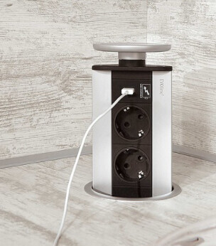

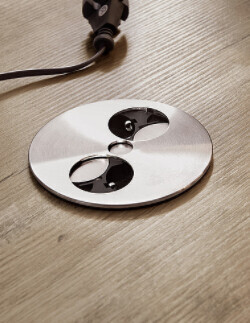

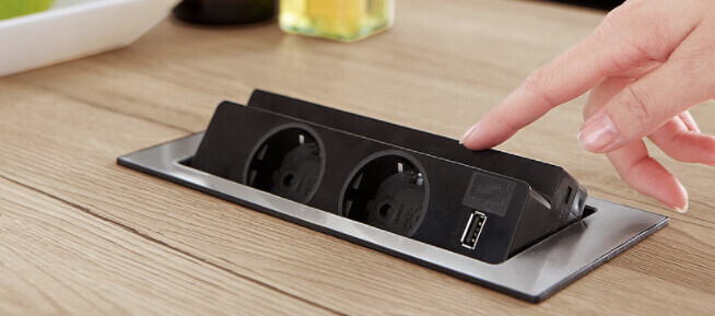

How many? It depends on the number of fixed appliances and the size of the kitchen. On or in the countertop, I would plan for at least 6 outlets.
For example – outlets are available with USB and/or Ethernet ports.

Pitiglianio
14 Feb 2022 09:19
Benutzer200 schrieb:
Just embed them all into the countertop. That way, you don’t spoil the wall.
No, but then you spoil the countertop.
It takes up unnecessary space on the countertop and also collects dirt.
Not to mention the rather expensive solutions.
WilderSueden
14 Feb 2022 09:25
Apart from the fact that many appliances like coffee makers, electric kettles, etc., are permanently plugged in, making them retractable doesn’t make sense.
