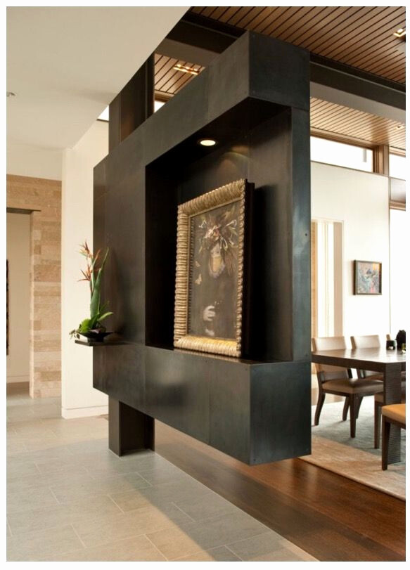

In the living room, there are considerations to use room dividers to separate the living area a bit. With the size, different zones need to be created; otherwise, it feels dull in my opinion. A fireplace as a room divider could also be an idea. The interior design is only a rough concept. My main focus was on the floor plan.
