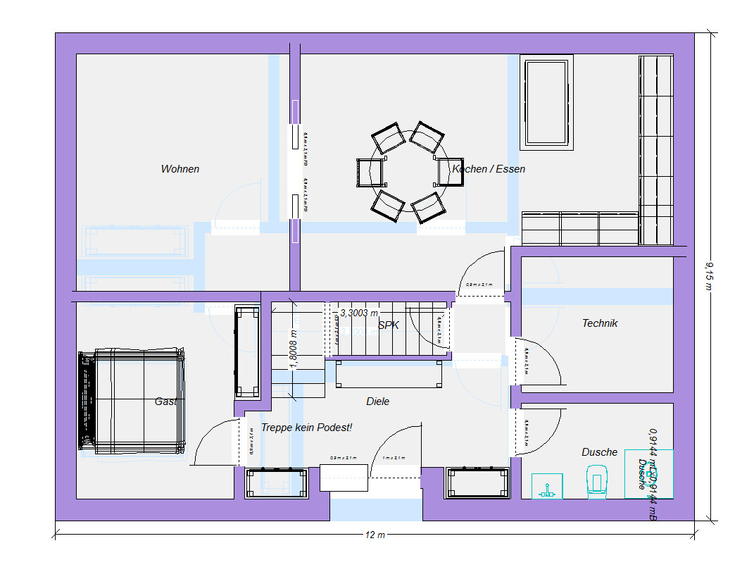

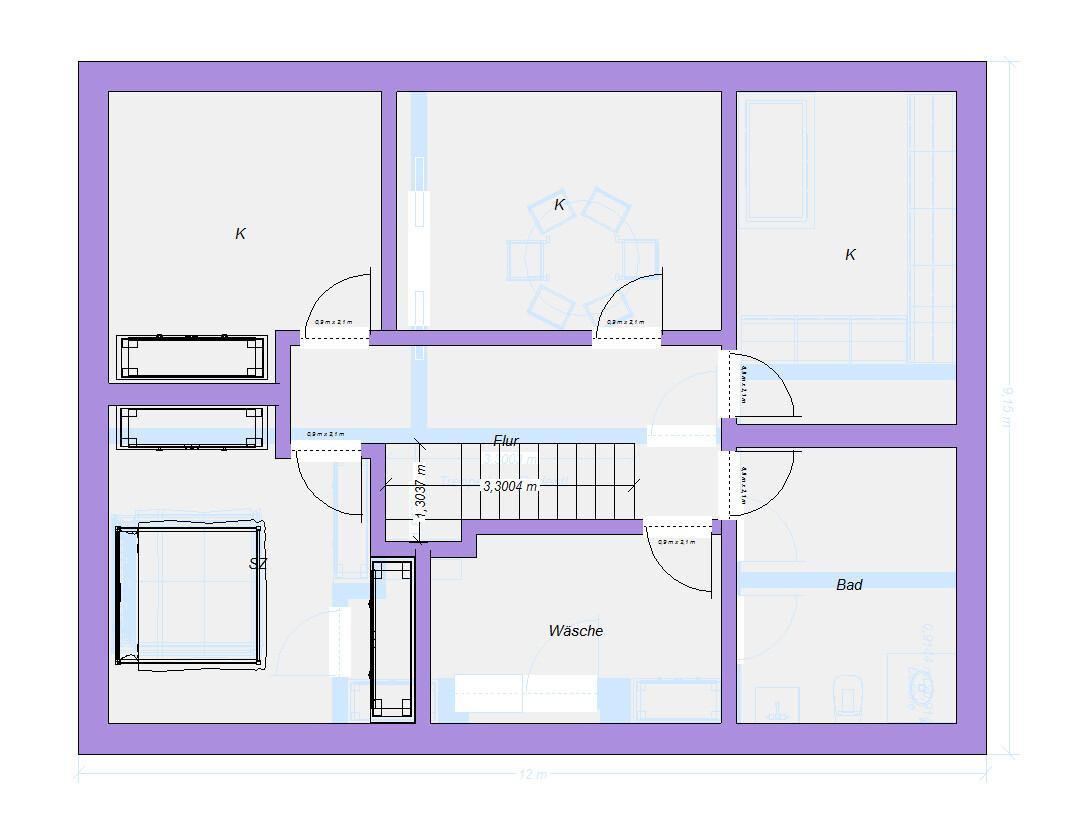

A bit more modern:
Sketch without windows:
Floor plan of a house with living room, kitchen/dining area, guest room, shower, hallway, stairs
Floor plan of a house: corridor, bathroom, laundry, three children's rooms, and stairs; purple walls.
However, slightly wider – but without a bay window. If needed, a small pantry could be added under the stairs. Nice built-in bench in front of the stairs.

Hi Katja, thanks again!
I’m not sure if something like this is really recommended, but we didn’t want an additional laundry room; everything should happen in the utility room (we also use a dryer). But feel free to convince me/us otherwise!
First impression: I somehow liked the old plan better.
kaho67414 Nov 2018 11:17
No problem.
The focus here was an additional laundry room – utility room – ironing – storage – whatever you want to call it. The previous layout could have been quite tight for six people.
haydee
14 Nov 2018 11:18
I would divide the room as in the last draft.
The humidity from washing and drying clothes, as well as the large amount of dust, is not beneficial for the equipment.
Your machine probably runs daily.
Take Kahoo’s floor plan, add your furniture, go through your daily routine, and you will see how well the layout fits.
