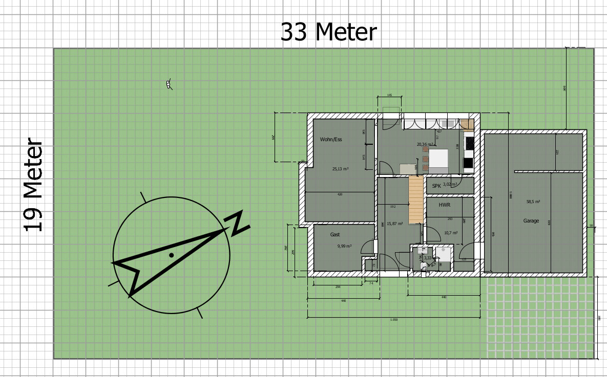

What I forgot to mention is that the staircase will have a reinforced concrete slab and does not need to be straight. It can be either a half or quarter turn. It just needs to be comfortable to use, so no steps that become extremely narrow.
Additionally, the finished ceiling height has been increased to 3.00 meters (9 ft 10 in).
I also just noticed in the offer that the exterior dimensions of the house are 10.50 m by 9.50 m (34 ft 5 in by 31 ft 2 in). However, these are not set in stone. They can be adjusted as long as the total floor area remains the same.
Of course, it would be best if the house’s dimensions were more vertical rather than wider, so there is more garden space on the left side. Unfortunately, with the current floor plan, all the rooms are already stretched out lengthwise.
But for now, I’m waiting for your feedback.

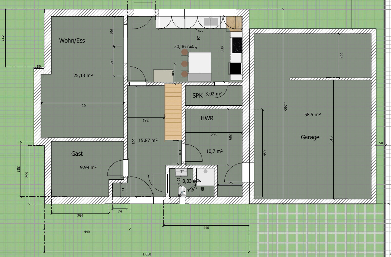

Some measurements are missing.
Ground floor
What is the recess behind the front door for?
The staircase seems too short.
The pantry doesn’t really seem usable. It looks too narrow for a freezer and shelves opposite the door.
Have you furnished the living/dining room yet? I find it quite small, especially with the panoramic fireplace.
The kitchen has a lot of unused space. Why not an open plan kitchen?
Consider swapping the kitchen and guest room.
The kitchen belongs next to the terrace.

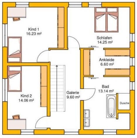

The upper floor doesn’t match the ground floor.
The staircase is in a different location and has different dimensions.
The upper floor is not dimensioned.

Ground floor
The ground floor and the upper floor must be planned together.
Ground floor... kitchen has about 4 sqm (43 sq ft) of dead space, utility room at least 3 sqm (32 sq ft) of dead space due to the passage from the garage into the house.
The staircase is much too short at a raw floor-to-ceiling height of 300 cm (9 ft 10 in) and just over 3 m (10 ft) in length.
What is the small "bump" in the guest room for? Cloakroom storage? Too small for a family.
Indicate the planned furniture layout in the living area.
Roof terrace from the bedroom... distance regulations must be observed, and the connection of the garage to the house must also be planned accordingly. Just a note regarding the intended self-construction.

Regarding the ground floor design:
It makes sense to combine the pantry and utility room if they are adjacent, as this significantly improves the traffic flow.
In the guest bathroom, the dimensions are already too narrow to comfortably pass through, while the hallway is more than spacious enough.
This recess seems intended as a coat closet niche? I would make it five times as wide.
I would skip the bay window, as it doesn’t serve any practical purpose.
I would place the kitchen on the south side, which allows it to be a bit smaller. Alternatively, if you opt for an open-plan kitchen with dining area, then the living room no longer needs a dining space.
Regarding the duplicated upper floor: having two doors in the bathroom compromises privacy.
