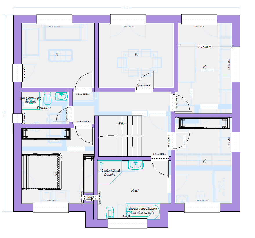

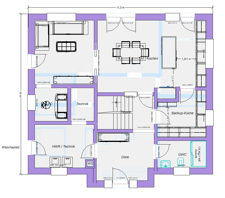

At the request of the original poster, here is another attempt with 4 children’s bedrooms plus a bedroom on the upper floor. On the ground floor, there is a large kitchen and a small PC/work area, without a guest room.
I’m afraid my creativity ends here. The house measures approximately 11.5 x 10 meters (38 x 33 feet) plus a bay window. I can’t make it smaller without creating impractical solutions. (The staircase still has no landing!)
Maybe someone else has ideas.
