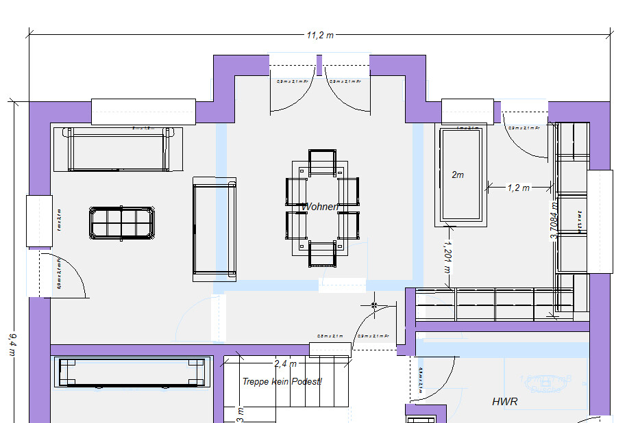

- We like this sample plan (see attachment). What do you think of it? (The attic is not included, the room layout fits well.)

Exterior dimensions are 9.4 x 11.2 m (31 x 37 ft) without the bay window. Unfortunately, it does not show the square meters (square feet) correctly or at all.
The kitchen has an open access. Of course, you can plan a door in wherever you like. The kitchen is over 12 m² (130 sq ft). But maybe that’s still too small for you. Would a fully open layout be an option?
Making it slightly larger or smaller usually creates problems. It’s better to start over. You don’t have to settle for the first design, and “traditional” might be a bit dull in this case. Personally, I like it, especially the grand entrance with the elegant staircase.
What do you want with an even bigger bedroom?

What would you do with an even bigger bedroom? ops:- My wife reconsidered and is 100% set on having an "open kitchen." The cooking videos are usually filmed in the mornings when the kids aren’t around anyway. Is my 12m² (130 square feet) kitchen really too small for a demonstration kitchen?
- A large bedroom isn’t strictly necessary; she just doesn’t want a separate walk-in closet for now. We still need to discuss whether that would cause a loss of usable space or if it could alternatively be used for something else.
But the first impression ... wow!!!
Well, if you remove the wall, you can nicely fit a 2m (6.5 feet) kitchen island.
That’s not possible with a closed kitchen.
As for the walk-in closet, that’s up to you. In this case, I wouldn’t recommend redesigning – it’s sort of the best part of the plan. You might be better off starting completely from scratch.
The main question is, of course, what the cost will be. With some luck, a standard hipped roof will be enough, although there would be no roof overhang above the bay windows. But bay windows add to the cost.
