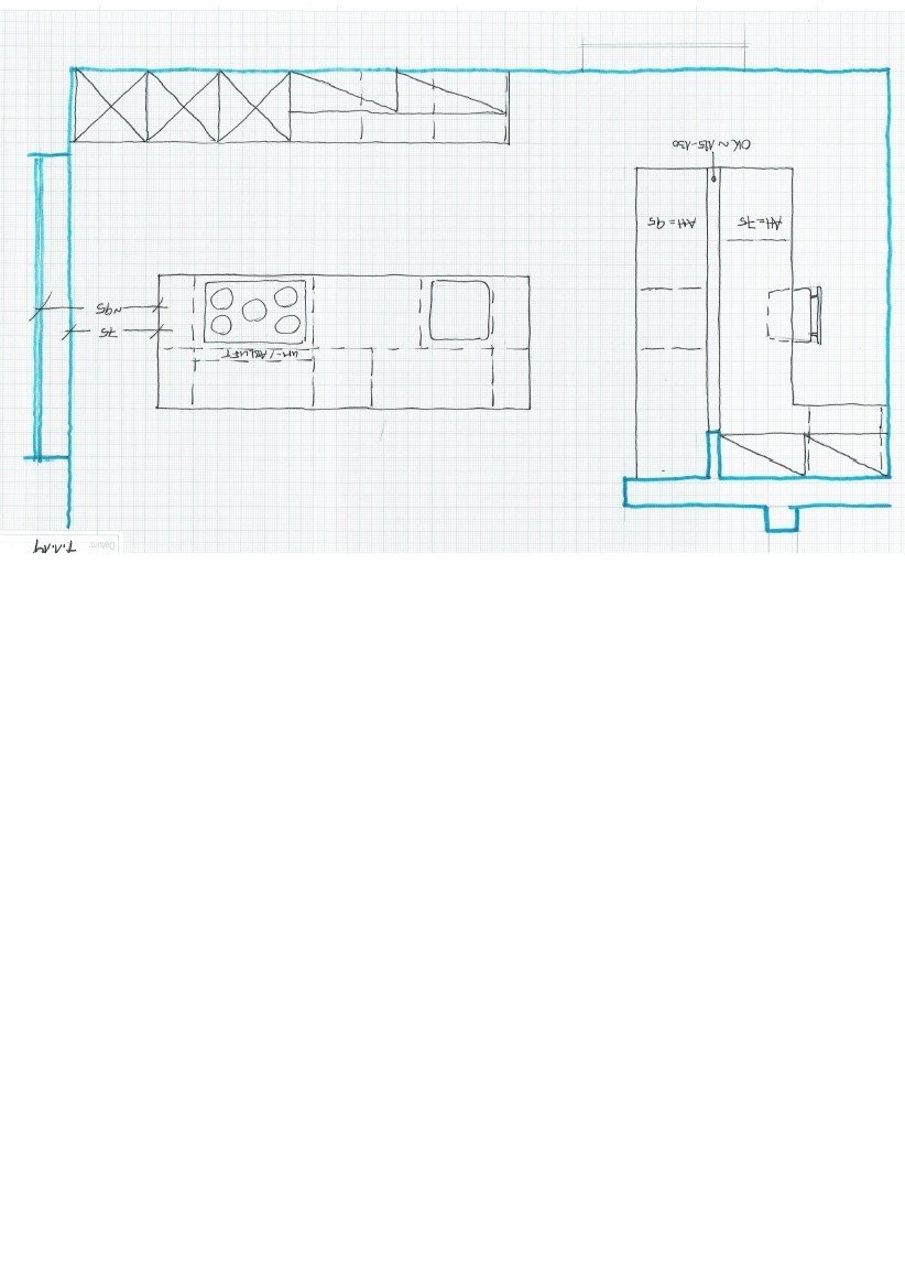

j.bautsch schrieb:
May I see the kitchen layout? (I have some experience with this.) From the floor plan, it seems to me that the cooktop and sink are too close together for efficient working... happy to discuss via private message.J
j.bautsch28 May 2019 15:10The walkways at the ends of the island seem a bit narrow to me; I would definitely not go below 90cm (35 inches) anywhere, as both sides basically serve as main access points to the kitchen.
Otherwise, it doesn’t look too bad.
j.bautsch schrieb:
The walkways seem a bit narrow at the ends of the island. I definitely wouldn’t go below 90cm (35 inches) anywhere, since both sides essentially serve as main access points to the kitchen.
Otherwise, it doesn’t look too bad. They should be just under 90cm (35 inches); I just measured it, and according to the PDF measuring tool, it was around 88cm (35 inches).
tumaa schrieb:
Ok, but my sofa is planned to be there. What kind of window would you want to use? A floor-to-ceiling one, centered? Would the structural support then need to be modified?
Yes, the sofa isn’t really an issue. Definitely not floor-to-ceiling. A window similar to the one in the utility room would be a reasonable choice for the exterior view. Structural support – no idea.kaho674 schrieb:
Yes, the sofa doesn’t get in the way. Of course, it’s not floor-to-ceiling. A window similar to the utility room window would make sense for the exterior. Structural support – no idea.That’s what I thought at the time as well, a window similar to the one in the utility room. The builder said that structural support shouldn’t be an issue there, but I will check again with the structural engineer.
We have an appointment with a window supplier next week, so I will discuss it with them as well.
