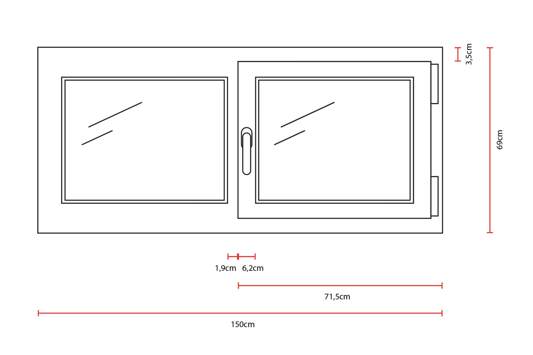

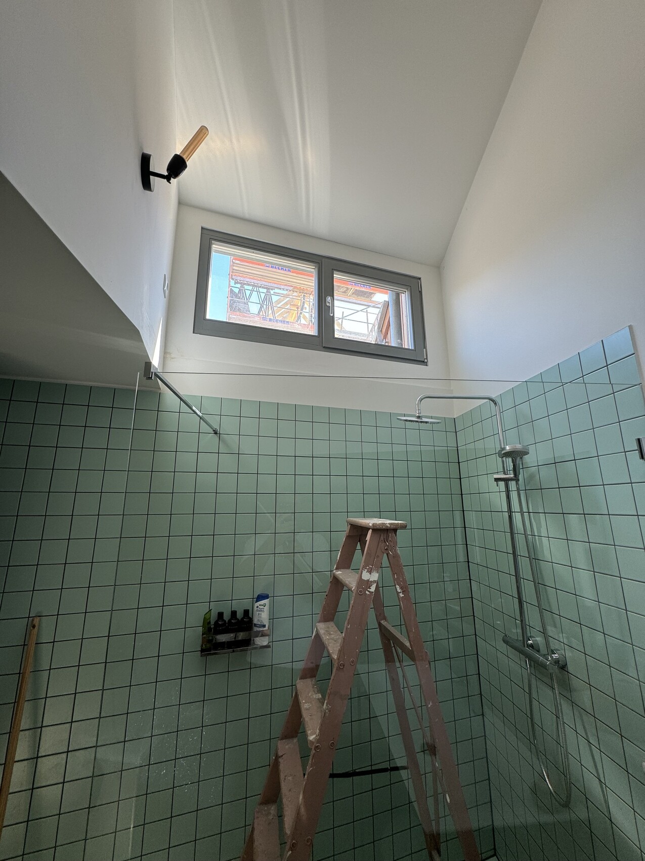

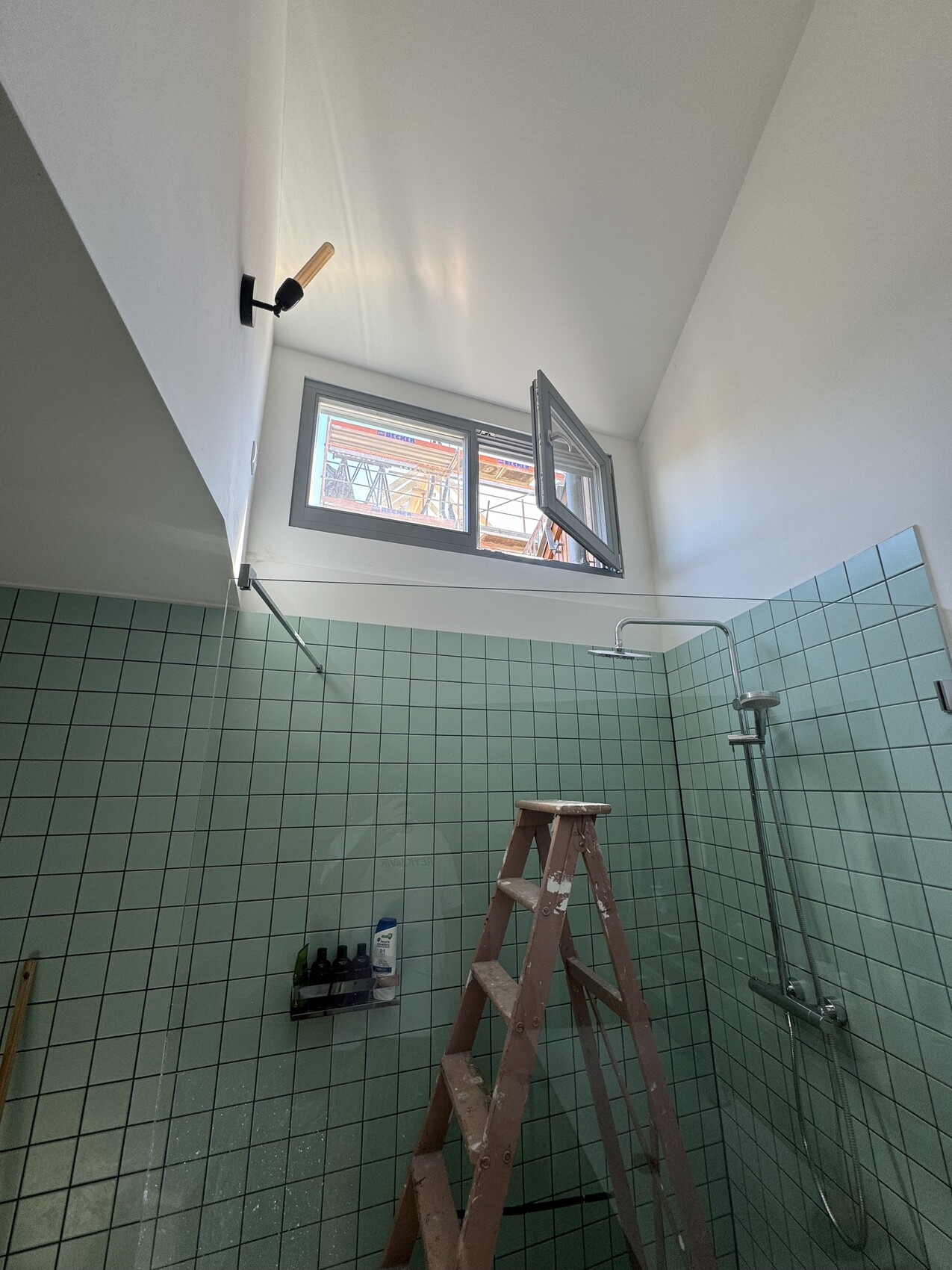

I have a window in my bathroom that is positioned so high that it can’t be opened without a ladder. The window consists of two parts – the left side is fixed, and the right side is tilt-and-turn. I would like to install a motorized window opener and wanted to ask if anyone has experience with this and can give me a recommendation.
Ideally, the window should open fully (turn mode) to allow better ventilation (if tilt mode is easier, that would also be fine). Attached are a photo and a drawing with the dimensions.
In the photo, you can also see the power outlet, which is located at the top left of the wall next to the window. Although it can be switched on and off from below, it is only a simple on/off switch. Therefore, a motorized solution with its own remote control would probably make sense.
Is it even feasible to do this properly with a motorized opener? And if yes, what exactly do I need? Also, what is the price range typically like?

Of course, it can be opened electrically. You need a (chain) motor that opens and closes the window. However, in this case, the window is not locked but only held at three points (motor, corner hinge, scissor hinge). The sash is small enough to make this possible. If you want more security, you additionally need a locking actuator that replaces the window handle and operates the existing hardware to unlock and lock the window. This setup then needs to be controlled so that the locking motor unlocks first and only then the chain motor opens the sash.
Get detailed advice from the window manufacturer who installed your windows. If they are unwilling or lack the knowledge, find someone else.
