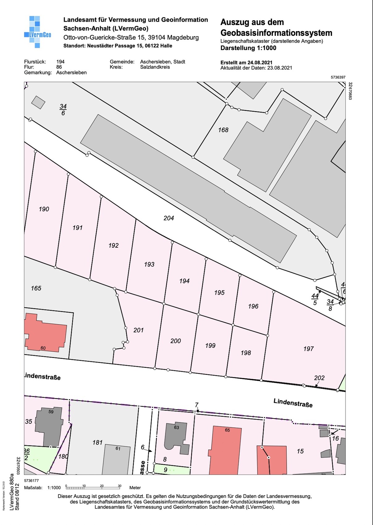

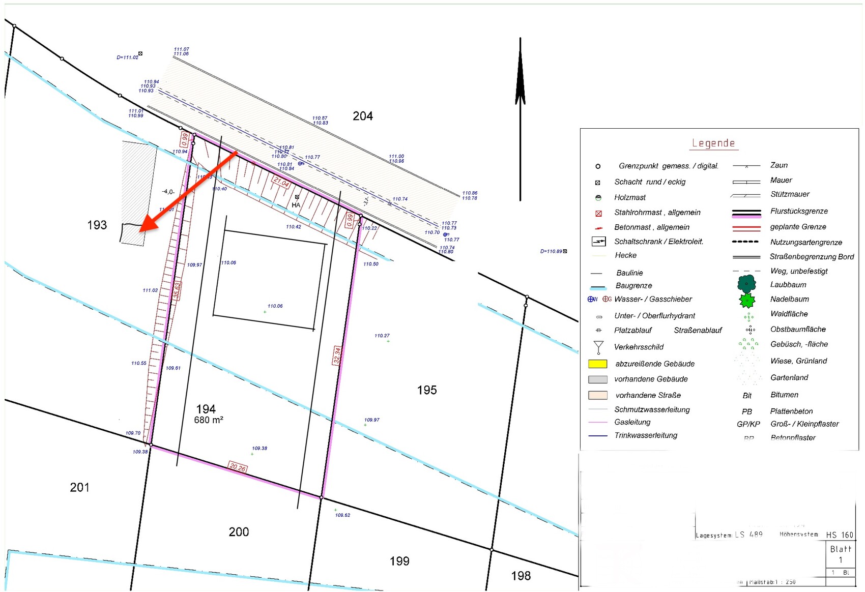

Development Plan/Restrictions
Plot No. 194
Plot size: 680m² (7,300 sq ft)
Slope: yes, descending about 1 to 1.5m (3 to 5 feet) from the access road
Site coverage ratio: 0.4
Floor area ratio: N/A
Building envelope, building line and boundary: see blue line on the development plan; approximately 12.95m x 20m (42.5 ft x 66 ft)
Setback from boundary: 3m (10 feet)
Parking spaces: 1 to 2
Maximum building height: 2 full floors
Roof style: no specification in the development plan

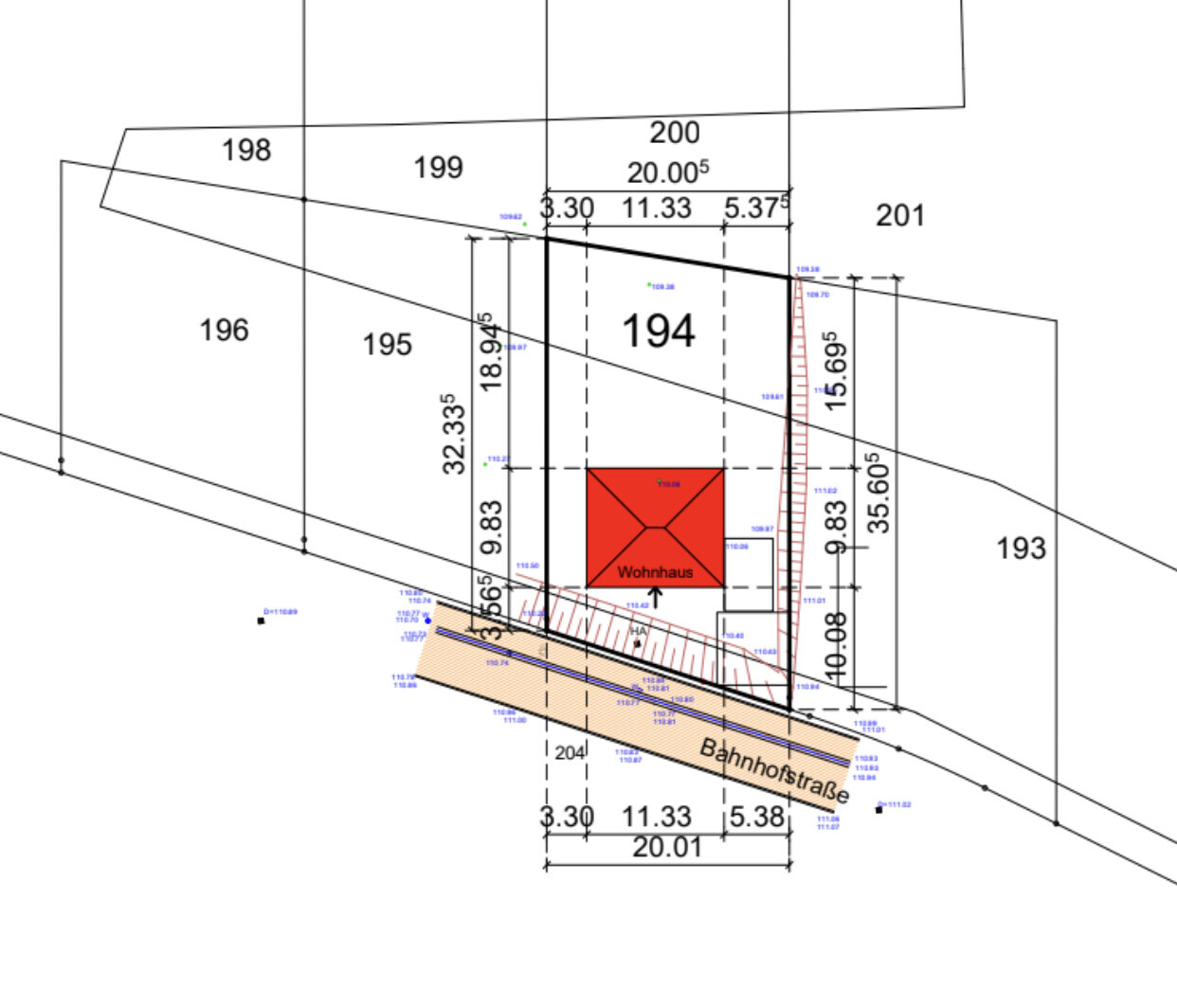

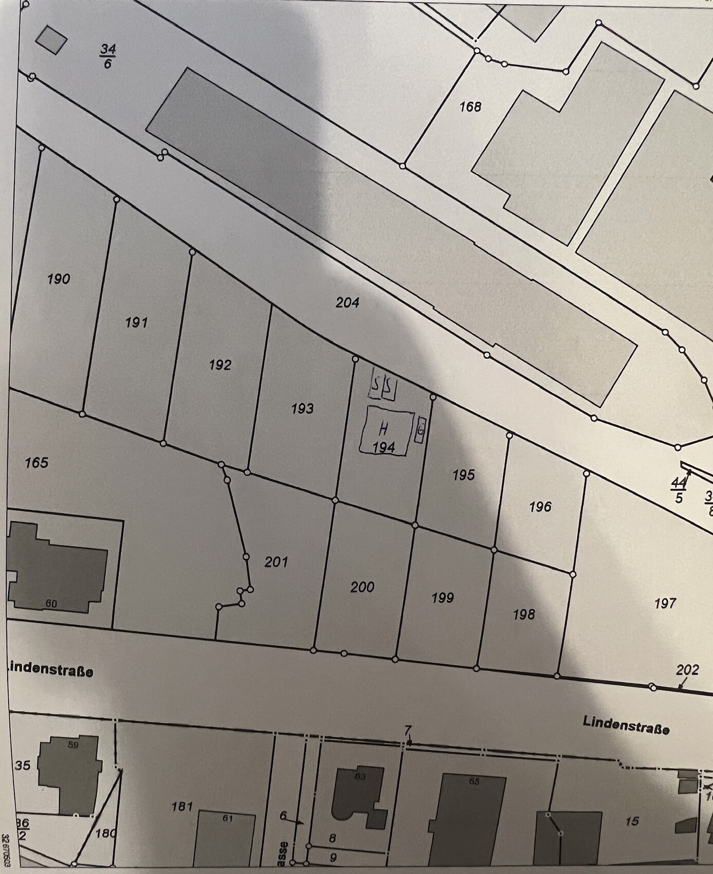

hanghaus202324 Nov 2022 11:09I would position the house slightly higher (finished ground floor height = 111.00 m (364 ft)) and more towards the south.
This way, the neighbor will block less of your west side, and you will have some slope towards the street.
The basement excavation should be sufficient for terrain shaping.
A solid reinforcement and backfilling of the garage driveway also provides a good crane setup area.
hanghaus202324 Nov 2022 11:25Are there already initial drafts from the new general contractor?
hanghaus2023 schrieb:
Are there any initial drafts from the new general contractor yet?Not yet. I think we might receive them tomorrow.
However, it will be a different draft since I first wanted to have the general contractor prepare it. 😉
I would position the house a bit higher (h = 111.00 m finished floor level ground floor) and further south.
This way, the neighbor won’t shade your west side as much, and you’ll have a slight slope towards the street.
The basement excavation should be sufficient for landscaping.
Good reinforcement and backfilling of the garage driveway will also provide a good crane setup area.We also planned to position the house a bit further south.

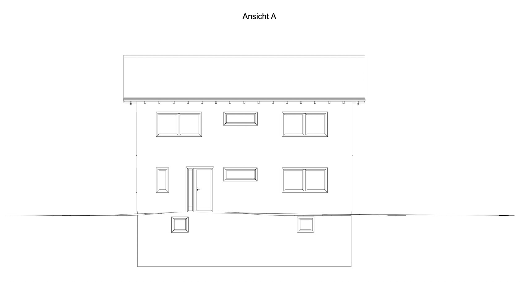

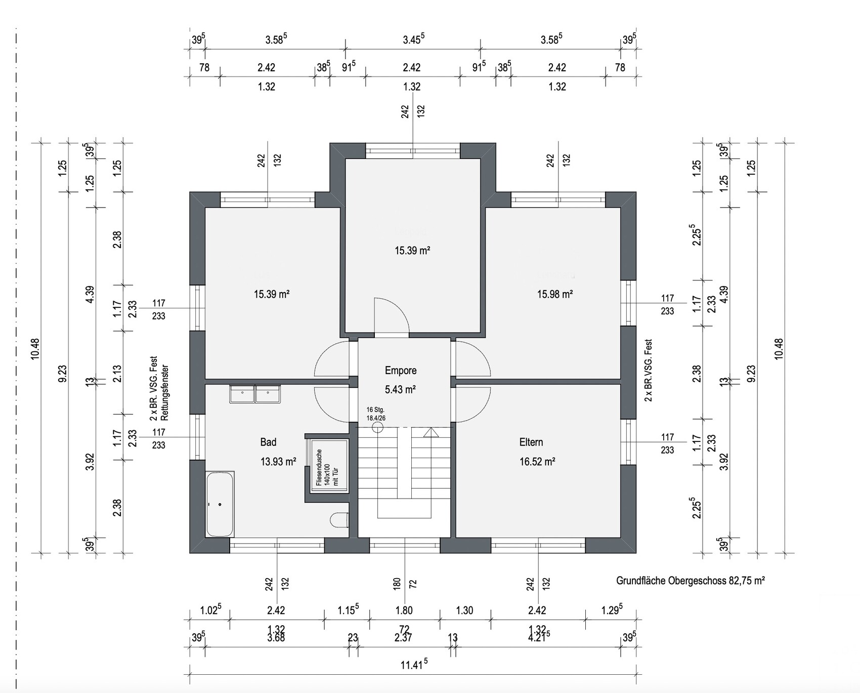

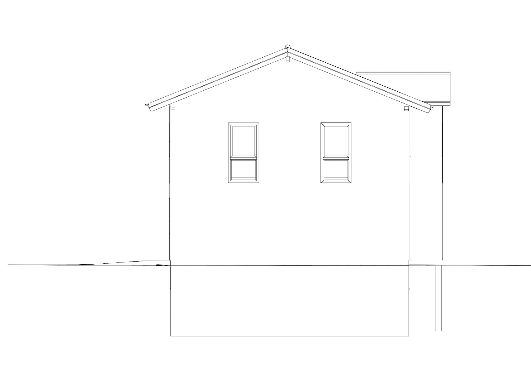

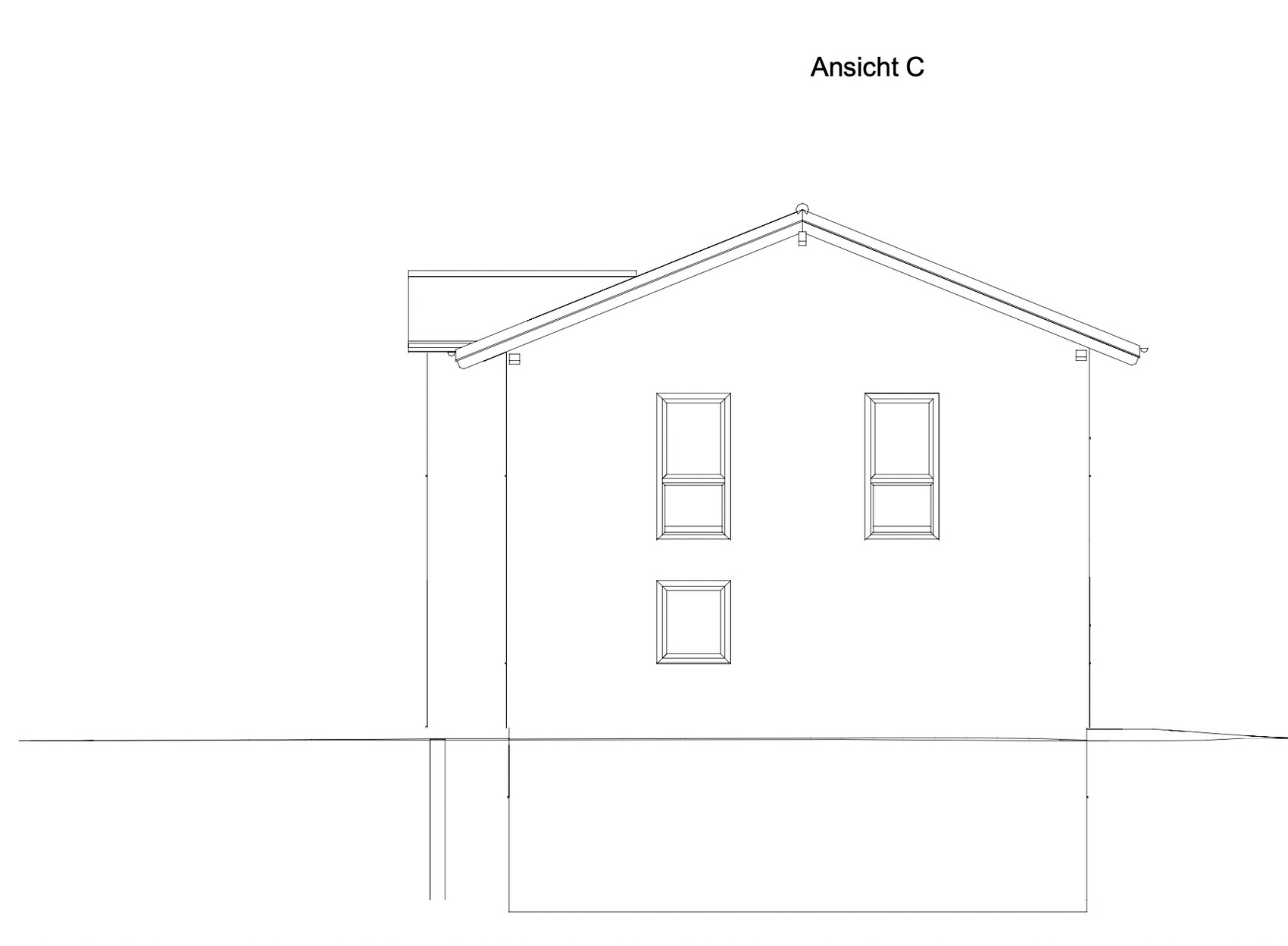

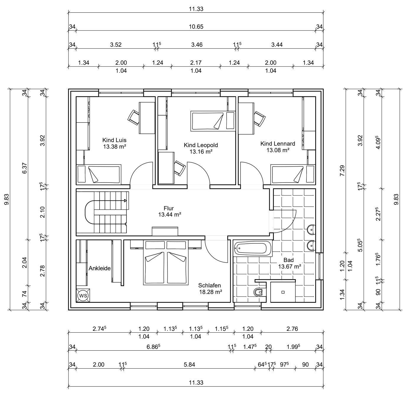

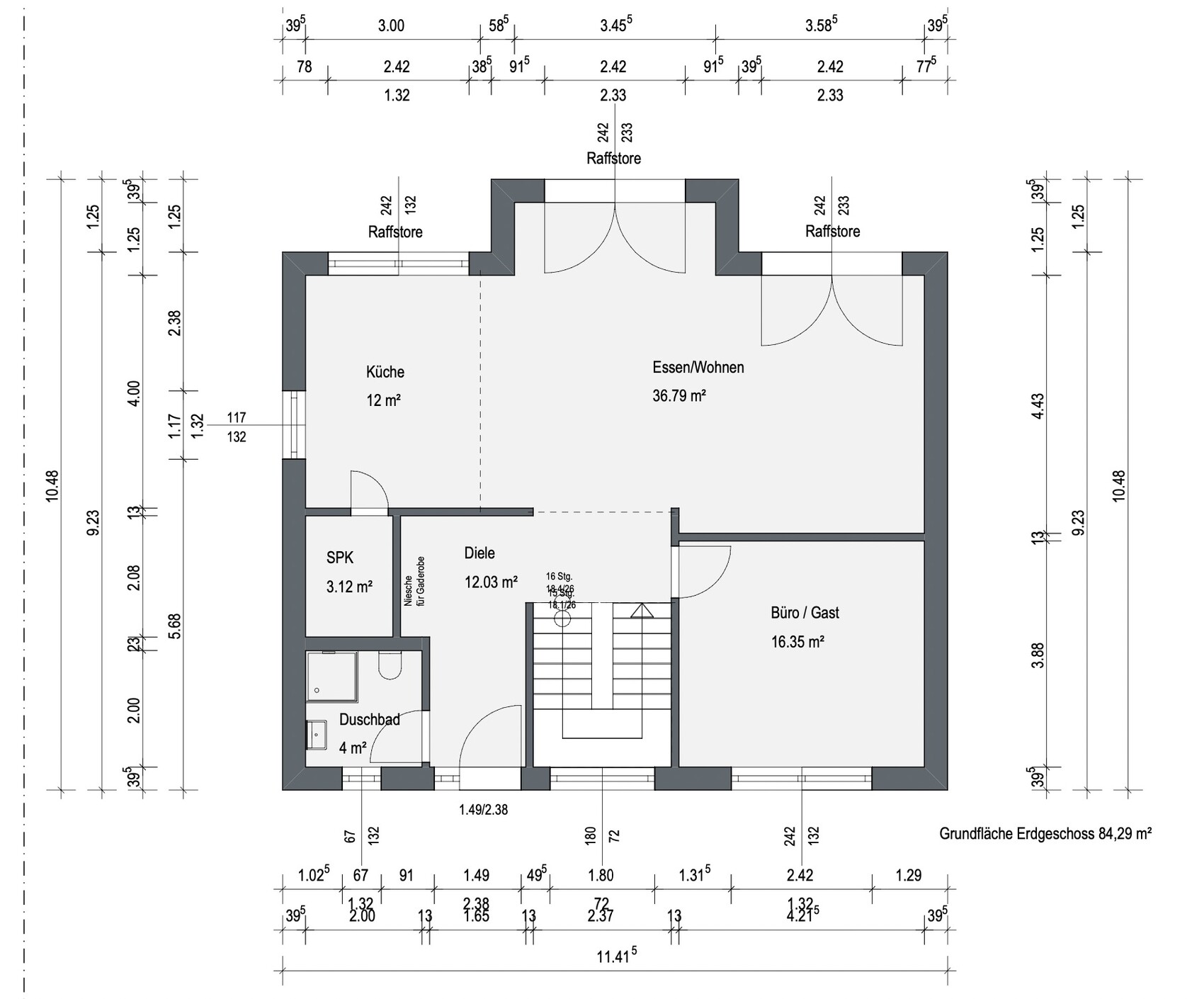

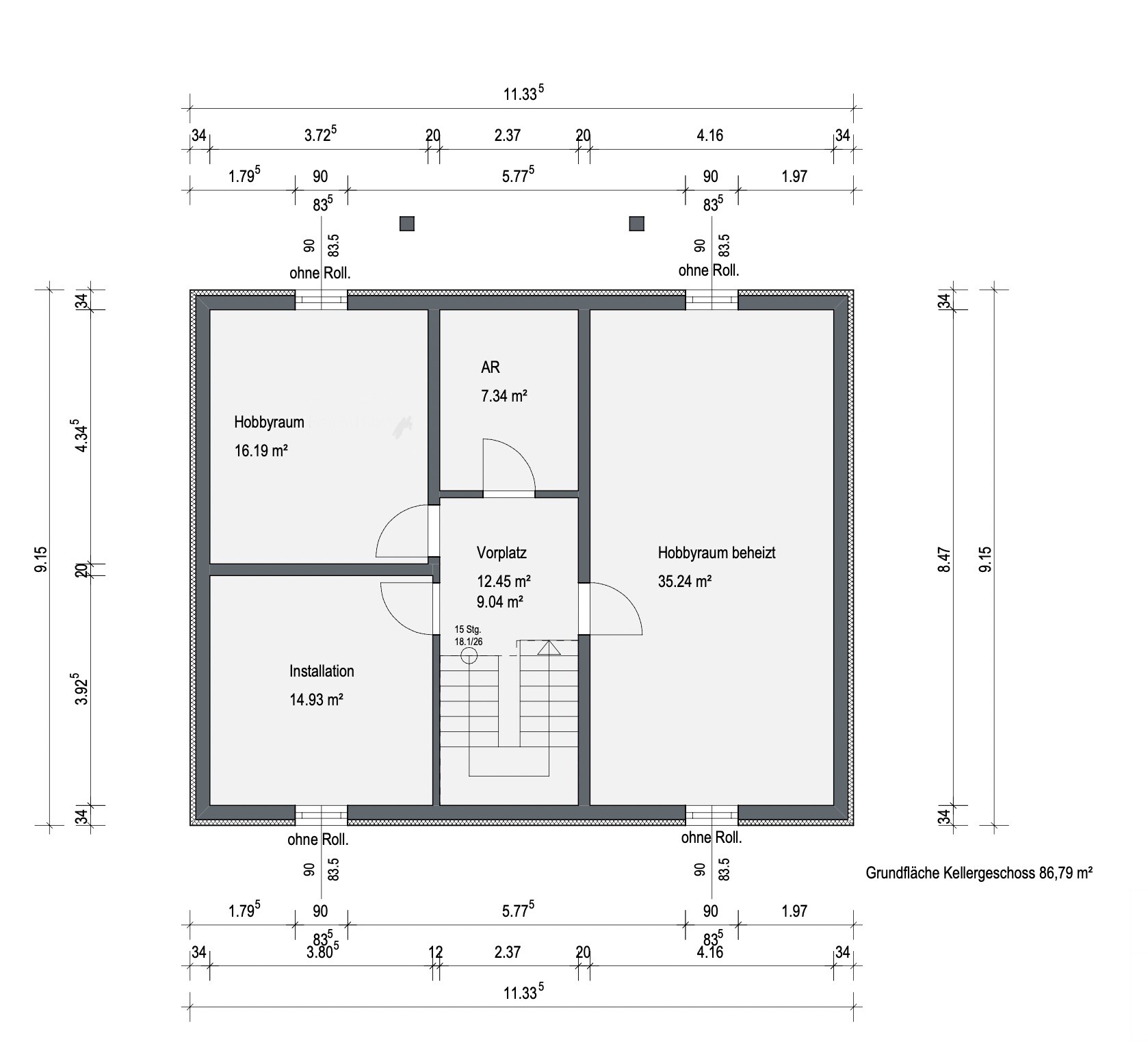

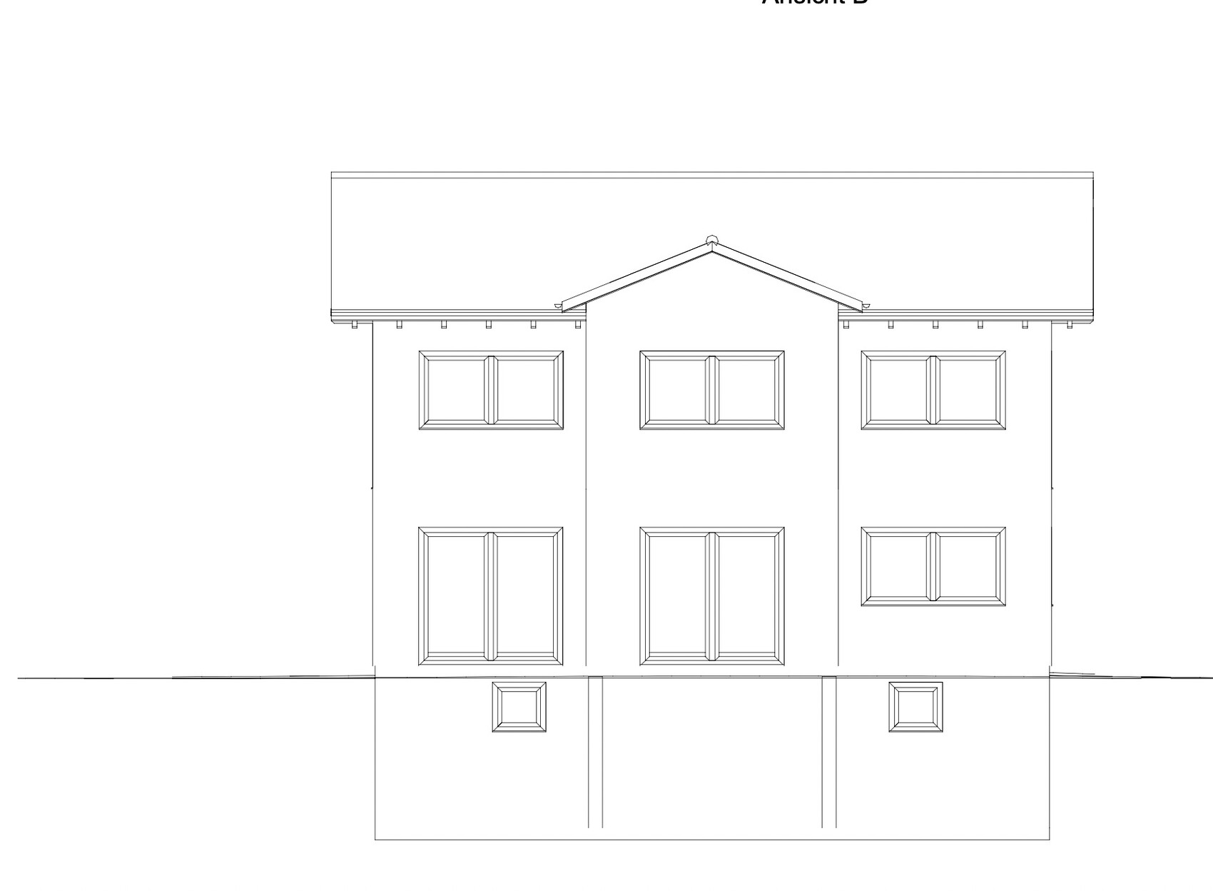

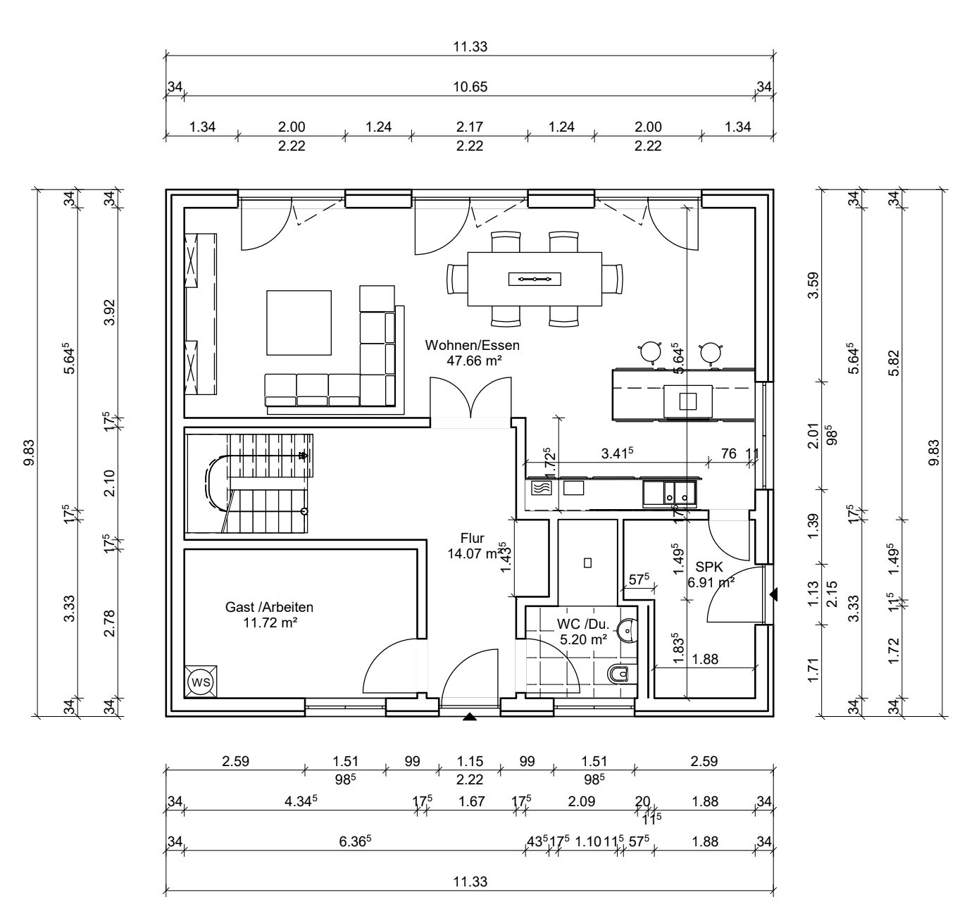

Attached is the floor plan from the general contractor with my feedback.
Ground Floor:
- Entrance area only 1.67m (5.5 feet) wide, acceptable but 2m (6.5 feet) would be better
- Huge pantry, okay but smaller would be preferable
- Staircase width 2.10m (6.9 feet), better if 2.25m (7.4 feet)
- Guest bathroom is really nice because it is spacious
- Missing window in the staircase area for more light
- We liked the dining area better in the bay window layout
- Moving the staircase away from the entrance area is very positive
Upper Floor:
- Bedroom width only 2.78m (9.1 feet), which is a bit tight; better 2.80m (9.2 feet) or even 2.90m (9.5 feet)
- Laundry chute in the dressing room instead of the bathroom
- Bathroom furnishing is challenging, especially regarding the sink
- Children’s room only 13sqm (140 sqft) instead of 14 or 15sqm (150 or 160 sqft)
- Narrow shower
Basement:
- Missing windows
Site Plan:
- Garage + parking spaces on the west side
General question about the site plan: How do you feel about having the garage on the west side? On July 22, 2022, at 8:27 pm, I stood on the property and took a photo (see attachment). You can see that the sun would disappear behind the house shortly afterwards. The house is generally positioned slightly angled on the lot. The advantage would be that we can use the “long” corner better for two parking spaces and not have to separate garage and parking spaces as I indicated in post #36.
https://www.hausbau-forum.de/threads/grundriss-efh-165m-plus-keller.44067/post-605630
My gut feeling is that this is not the right floor plan because it has too many issues. Therefore, I would go back to the bay window layout.
@katja and jpg Do you have any good floor plans? How would you build?
Gregor_K schrieb:
@katja and jpg Do you still have good floor plans? How would you build? Are you referring to me? I don’t think the design is good. Many points have already been made. Additionally, I find the hallway in front of the stairs oversized, the dining area cramped, and the upstairs hallway too large. The staircase is incorrectly placed on the short side of the house, which results in narrow rooms and a large hallway.
I didn’t have many complaints about the first design! And there were hardly any… the only issue was the basement.
And yes, I wouldn’t put a garage on the west side but rather have a large window there.
The bathroom still needs some work.
